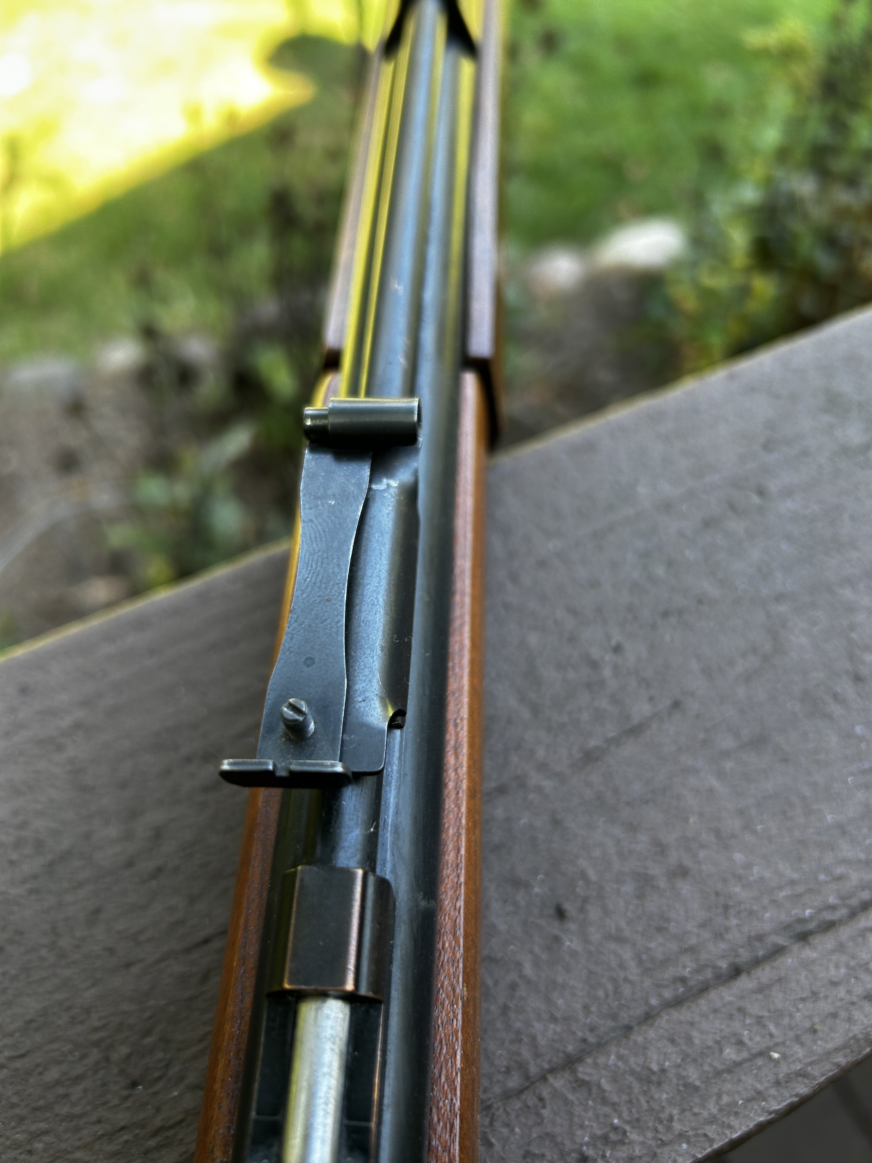

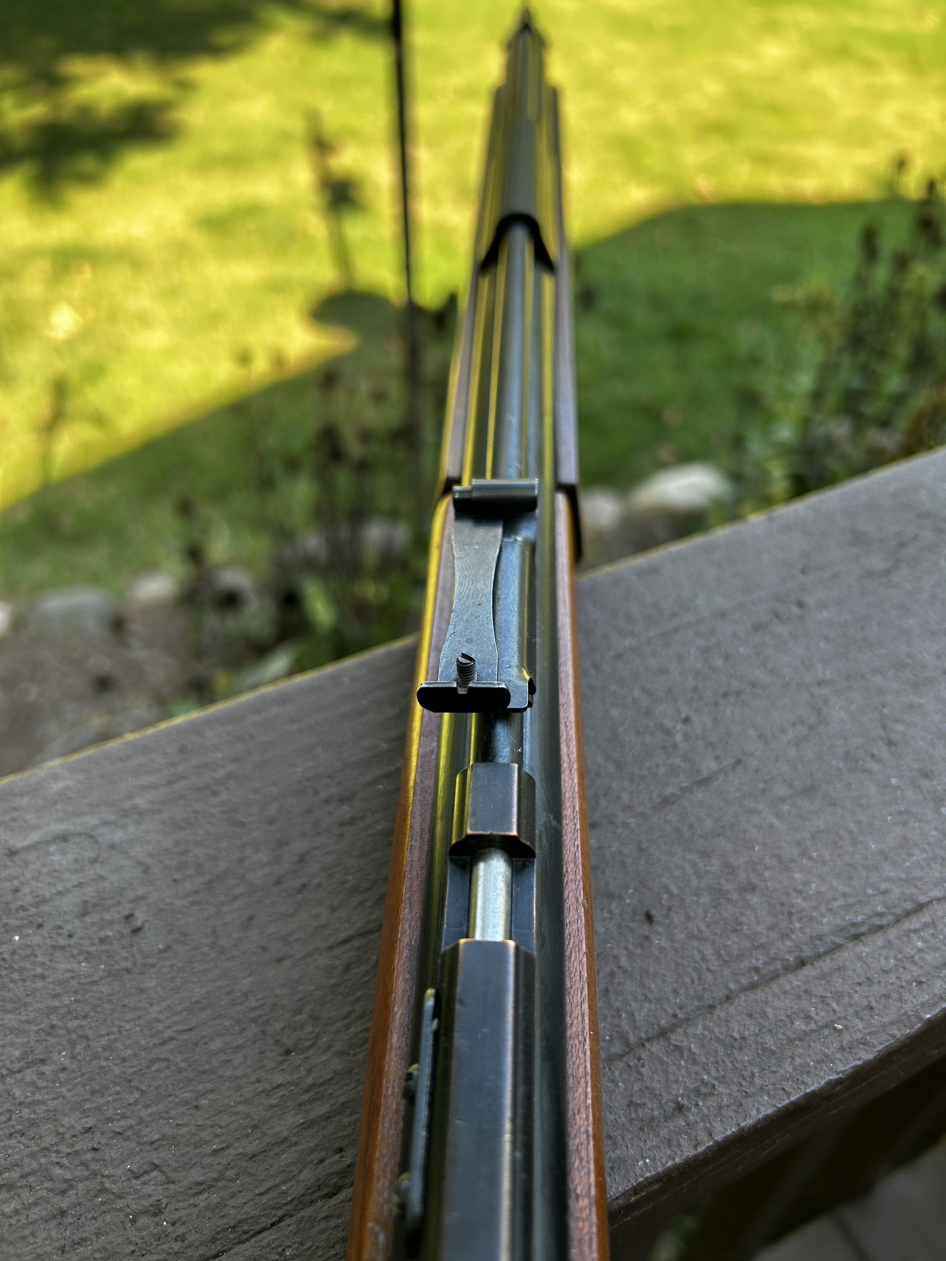

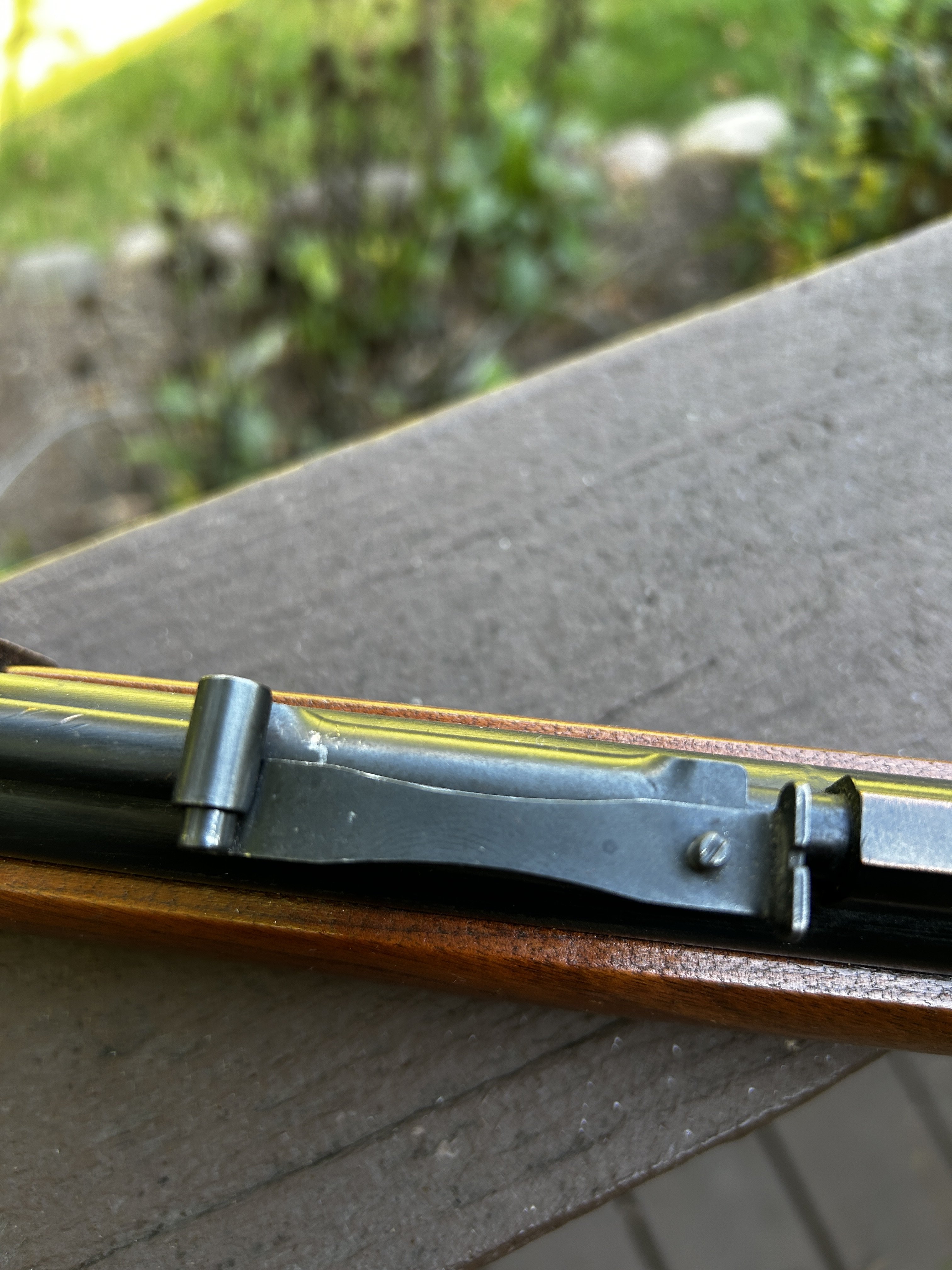

I was given this Sheridan Blue Streak and noticed the aim was way off. I tried adjusting it with the screw on top of the rear sight, but even with all the travel it was still off. So I removed the screw and pushed the sight right out (see attached pictures). Now it shoots on target, but should the sights have to be adjusted this much?

I don’t know if it is because I’m on a different phone or what, but your rifle looks to be bent in the direction that matches the sight offset. The stock and pump handle mismatch also indicates a bend in the same direction. If you’re not capable you should find some help, perhaps a machine shop? I hate to see one get wasted.
