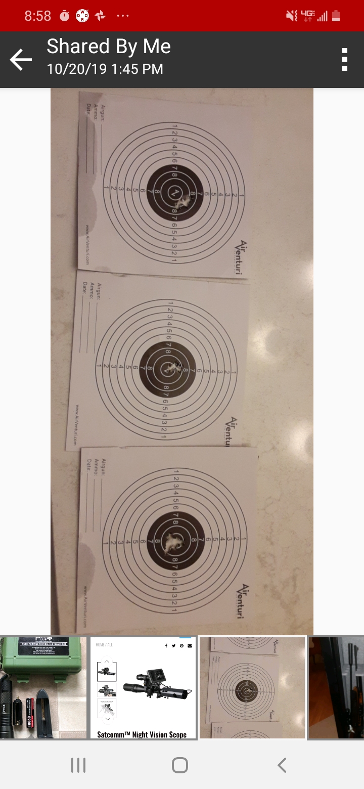

These were my 3 targets left to right while centering my scope at 30 yards. All 5 shot groups. Wasn't my best effort, but very representative. Mine is .177.
And, if you look at the target bottoms, it was raining at a decent clip at the time. The targets are under a tree and stay mostly dry.
If I do my part, it is fantastic. I know I have better targets, just not finding them now.

What pellets are those 30 yard groups? As an Oregonian... rain hasn’t ever effected my groups that I can remember, and I shoot way less power then the Sig. are those the best 3 of many or average? I’m pretty sure those are 97 sized 30 yard groups......... I’d be curious to see 40yd groups. Maybe 45.
These are NOT the best. This was when I placed a new scope on, just sighting the scope in. They are literally the first 3 targets. I kept shooting after, but didnt take any more pics that day. First group was the top target. Adjusted the windage resulting in second target down, and final adjustment for the third and bottom most target. These were sighting in, not really going for all out accuracy, but they were pretty good groups, so I snapped a pic for a coworker. I'd say those are average 30 yard groups for my sig using the H&N Barracuda match 4.5mm 10.65 grain pellet in 0.177. I've grouped out to 35 yards or so, but almost all my shooting is below 40 yards exclusively.

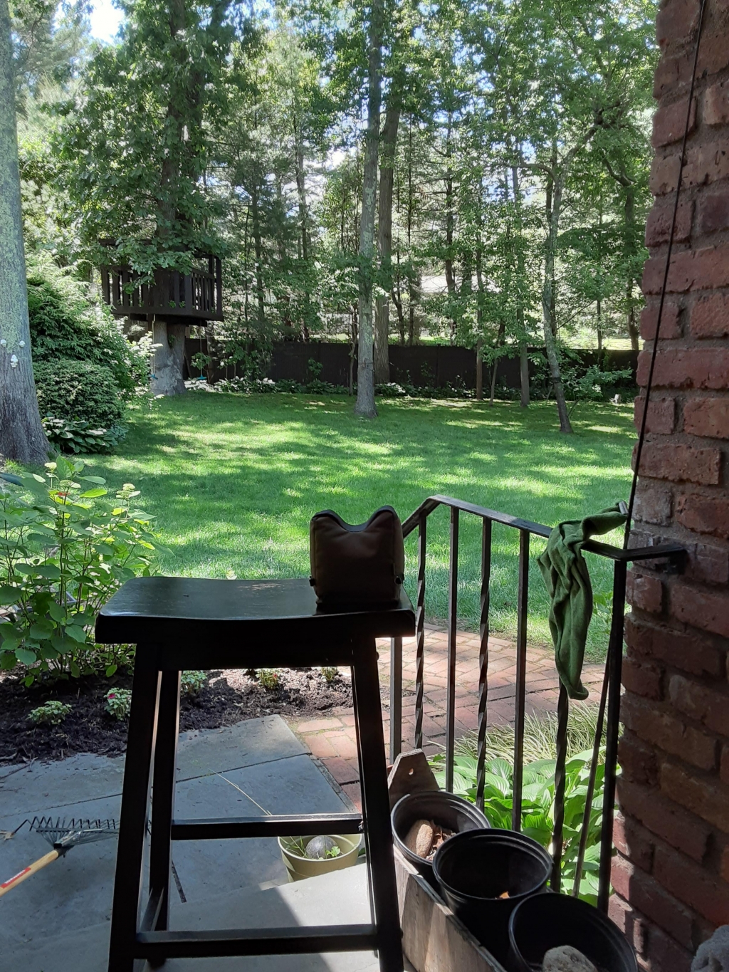

And, as you can see, I have no fancy set up for stability. I am either on that wobbly bar stool, an ironing board, or sticks rarely.

Is it pellet fussy? Do most pellets shoot like that or did you do a lot of testing? Not going to lie here, those groups are so good I’m upset lol. I have to work pretty hard to get groups like that at 30 yards. Albeit less costly airguns...

I tried a TON of pellets in this gun. It seemed, for me, to shoot most pellets pretty darn welm. The pellets that it did not, they didnt even group. For example, any wad cutter in my asp can't even group at all. Like I said, it grouoed most well, and a few couldn't group. There were at least 5 different pellets that I could not tell which grouped the best. I basically tossed a coin and stuck with these.
