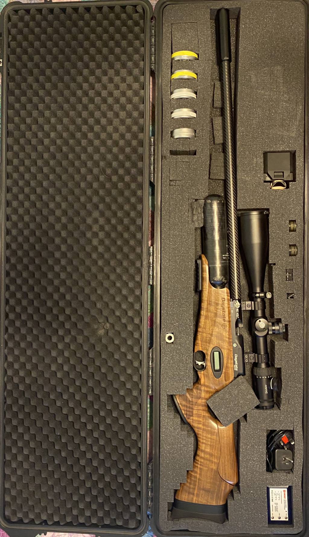

This one...

Lol I agree..
Could get expensive, depending on how many neighbors you’d need to buy for.
Haha. My rats will probably skimp on the personal protective wear.
