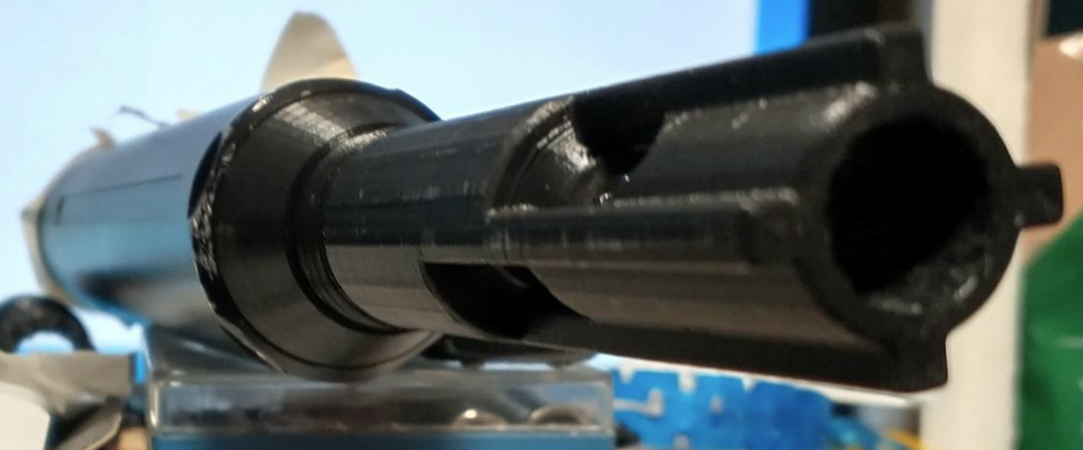

Yes, the alignment rod works to show moderator misalignment with the barrel bore, but not everyone has a rod sized just right for their barrel; nor one made of non-marring material. So, something we all have access to and is non-invasive may be almost as good: Masking tape applied over the muzzle face of the suppressor, slightly embossed with your finger to make a nice ring imprint. Then you shoot through the tape to see where the hole is relative to the ring embossed in the tape. A wadcutter helps, but is not essential. Usually, you can shoot a few shots without blowing off the tape to confirm system stability.
You can also look through the moderator after unscrewing from the other end after shooting through the tape one or more times - see image below.

Thanks to @TorqueMaster for sharing this simple but effective technique with me. Here are two of his images of a custom extended shroud insert I designed. One, showing a pellet hole slightly off center in the masking tape; indicating the need for some diagnostics.
