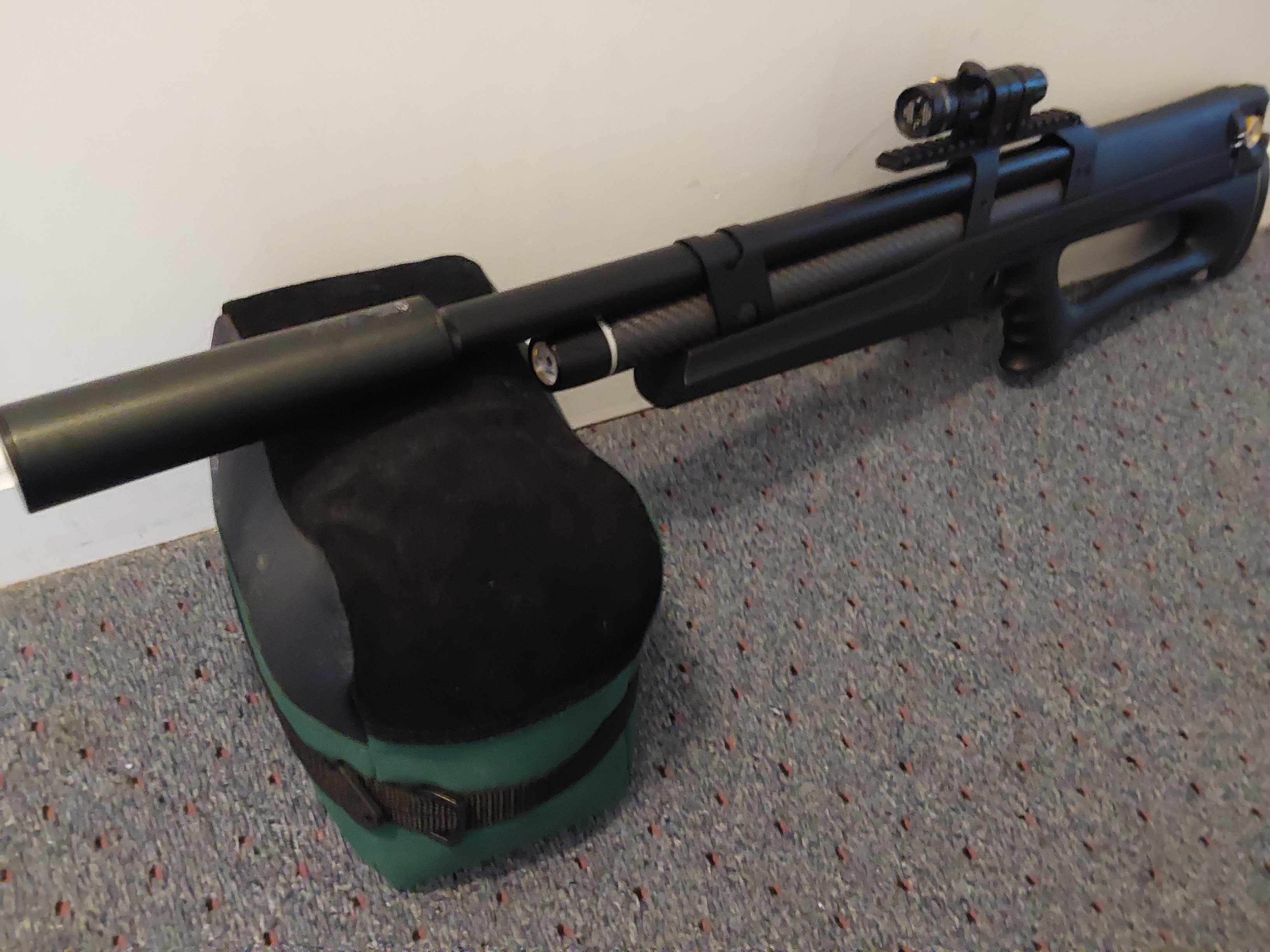

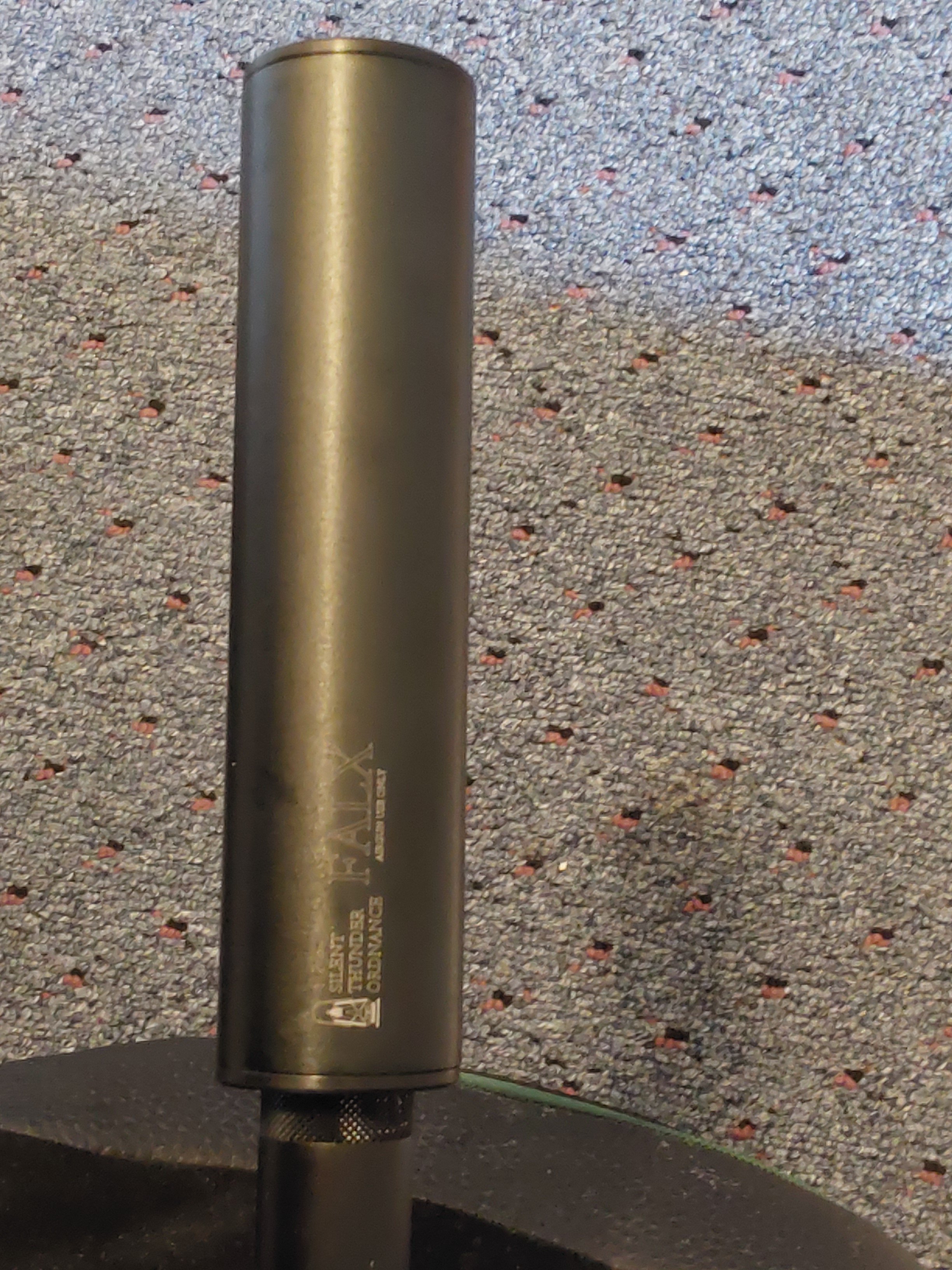

WOW..I'm glad I took the step and placed an order for an LDC for my pcp airgun! I ordered the Falx Moderator
and it came to my door(beautifully packaged) in 2 days. I put the shroud (LDC, airstripper) on my Huben and
it was very quiet!!! I can highly recommend this business.

Had you tried any other moderator on your Huben, or just the Falx? If so, how did it compare to what you had used on it - they definitely are quieter with a moderator on them . . .

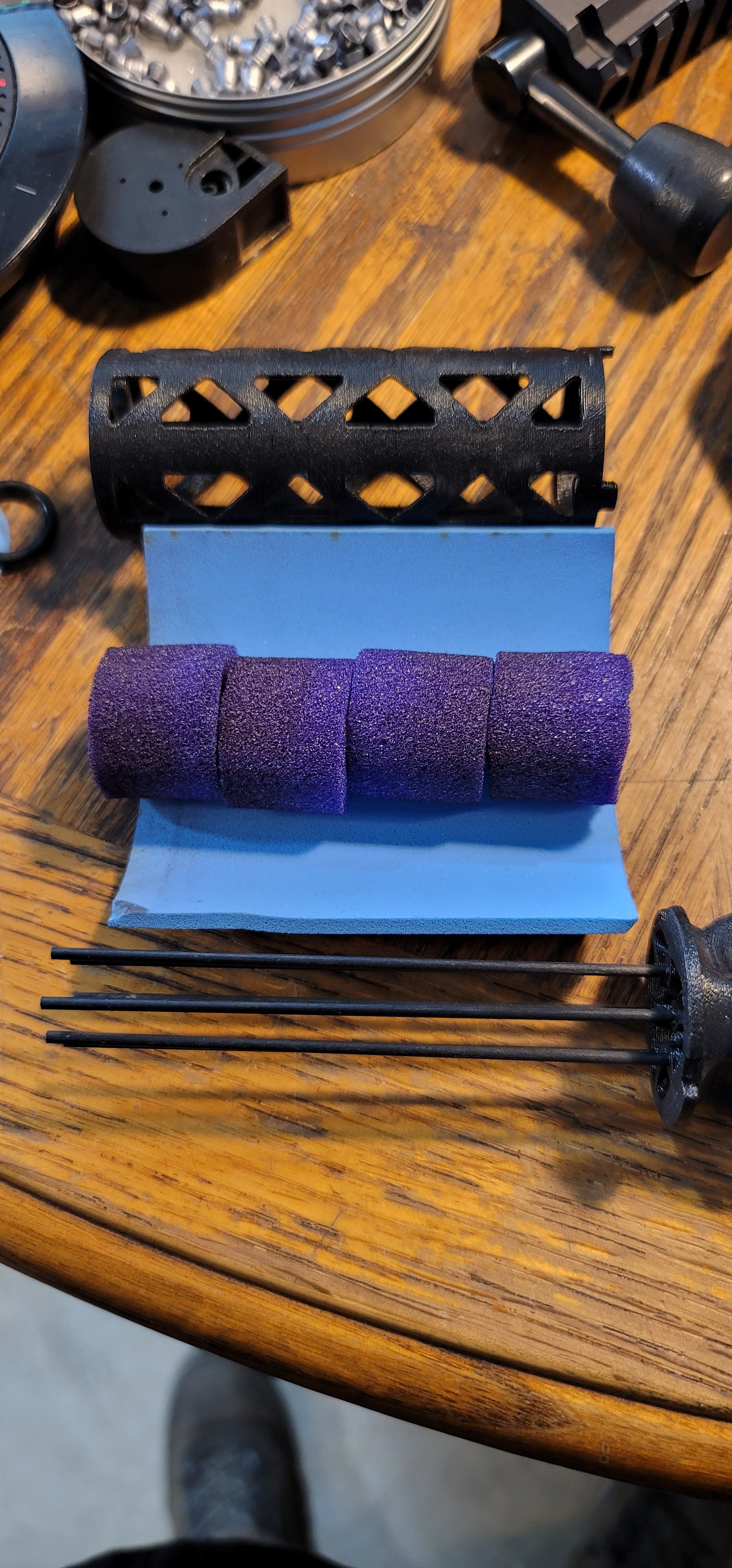

I enjoy my STO's, to date I have not found a more effective moderator for high-energy-for-caliber applications. But, there is always a but. I've found my Sarissa's do require a bit of maintenance/attention. Similar to the DFL felt migration issue, STO's little foam donuts will pile up at one end, the outer dense foam sheet can in turn migrate into the projectile path. Significant buildup of lead dust will wedge itself between the 3d printed core and housing, if left unattended this can shift/flex the core to the point of misalignment.
An accidental double feed or perhaps an accidental shot taken with a loose suppressor can get very expensive with those intricately 3d printed cores.
Very effective moderators, but they do have their quirks.
I prefer my Falx more than my 0db. The Falx is quieter to my ears.

There's no substitute for periodic disassembly/cleaning/inspection with this style moderator, IMO. The core needs to come out....
I cannot speak for others, but my applications for the Sarissa range from an 11.5" barreled .22 pellet shooter that sends 18gr 900fps up to .25 slug shooters tuned from 85 to over 100fpe Sometimes hundreds, sometimes thousands of shots per week.
When used in such a way, those foam donuts will migrate to one end....lead will become wedged between the edges of the tesla diode area, and begin to shift the core. Clipping will occur and that intricate tesla diode system will begin to become damaged. Periodic disassembly is required, at least under this type of usage.
Here you can see where the lead dust begins to bond to the core. gravity, pressure, and vibrations basically pack the lead dust between the core and outer shell. Next time I take one down and the foam donuts have migrated I will share a pic.
