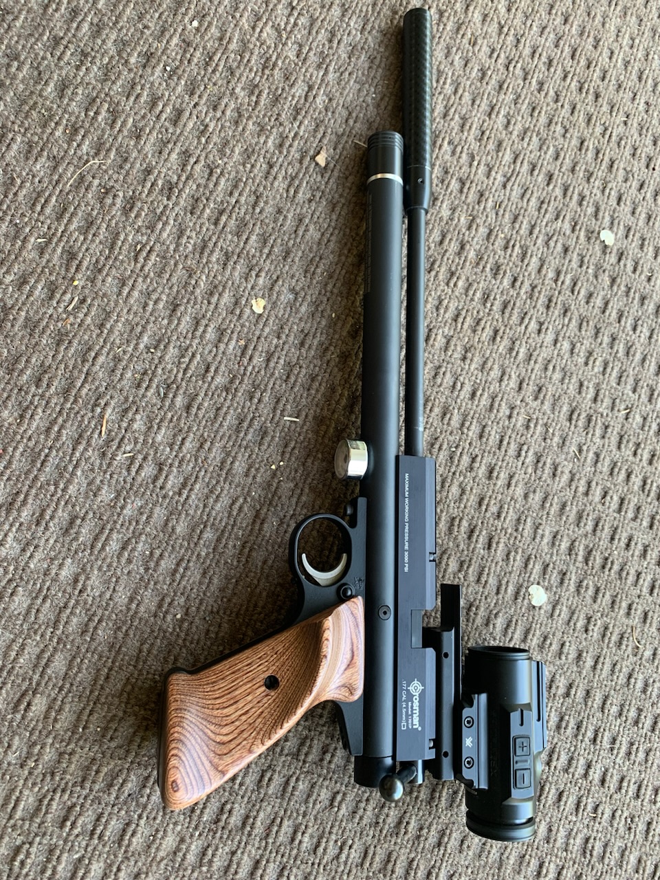

over on the PCP forum discussing experiments involving 177 slug shooting using my Leshiy Classic, Airmaks Caiman and most recently, a 20-grain slinging FX Panthera. However, on the back burner, I’ve been playing with a 1701P that I’ve had for some time, that was shooting pellets in stock form. A measly 4fpe but very accurate. Knowing it has a LW barrel with a twist rate capable of shooting slugs, I decided to try developing a tune for the tiny slugs that are available these days. Here are the results, but first some background on the setup:
The 1701P, which has a wooden grip set and 5”TKO mod had its barrel cleaned and very lightly polished with JB paste. The TP was enlarged to .064 and 100 10-grain Zan slugs were shot through it to lead it in, not even paying any attention to tuning or accuracy. It was then fitted with a pic rail adapter and Vortex 5X spitfire prism scope.

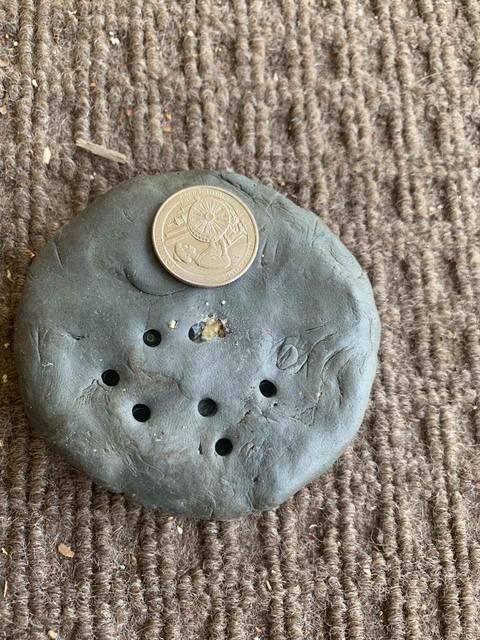

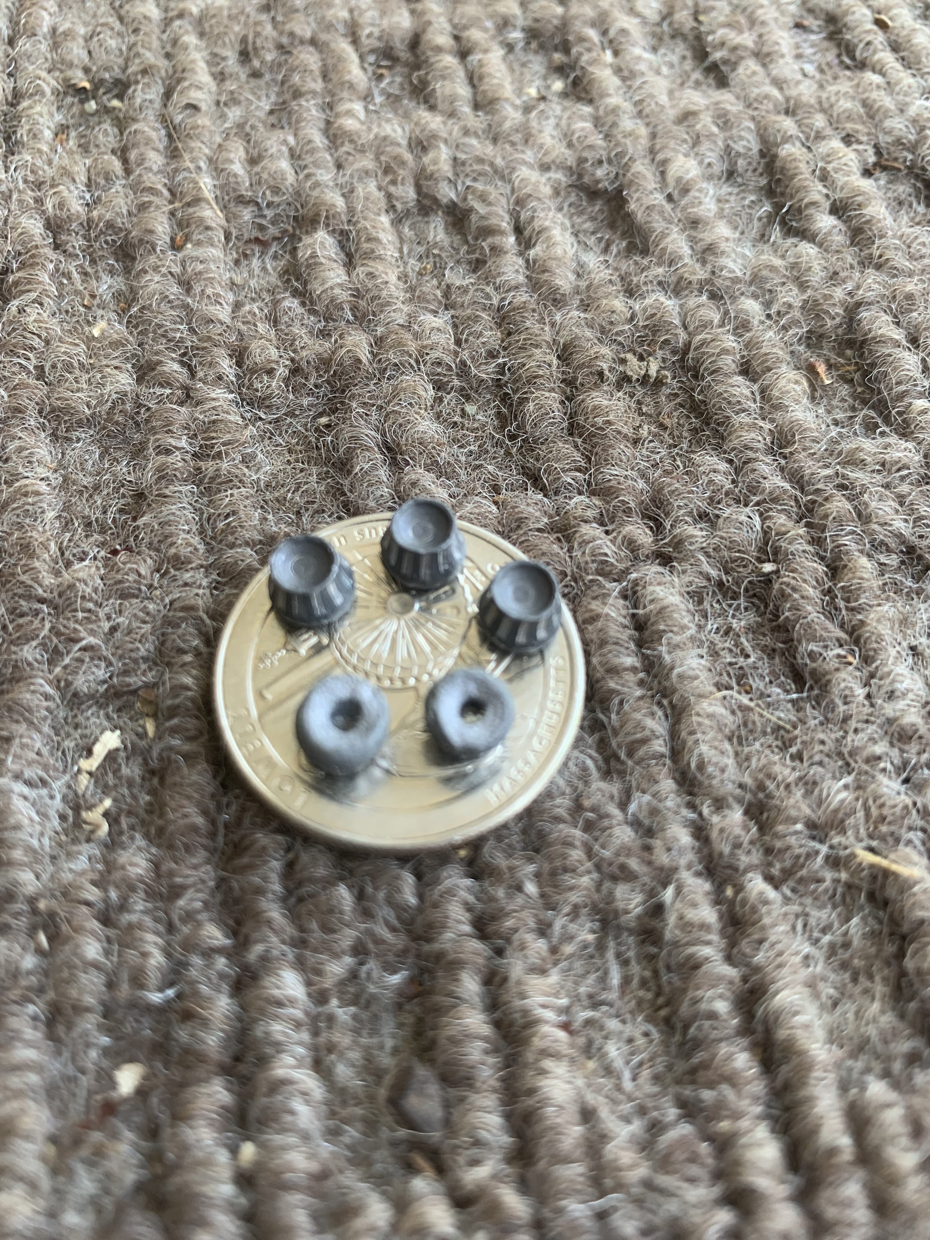

So, around 8.8fpe with those Zan 13grain slugs. Right after refilling, I shot the following 8-shot group out to 55 yards with the gun sat on two small rice bags. The target is my usual duct seal block with a grain of corn as my aim point. I clicked down 3moa from the 30y zero but was still a little low. 2 slugs hit the corn grain. Wind was ~8 from right to left. One pic of the target and one of a few of the slugs recovered from the duct seal:
All of the slugs were embedded nose first in the block and showed partial expansion (to about 22 cal size) and had good rifling marks. Overall I’m pretty happy with this and excited to take it out hiking. I thought about going back to iron sights but the spitfire, although it struggles beyond 6in relief, works very well in a taco hold!

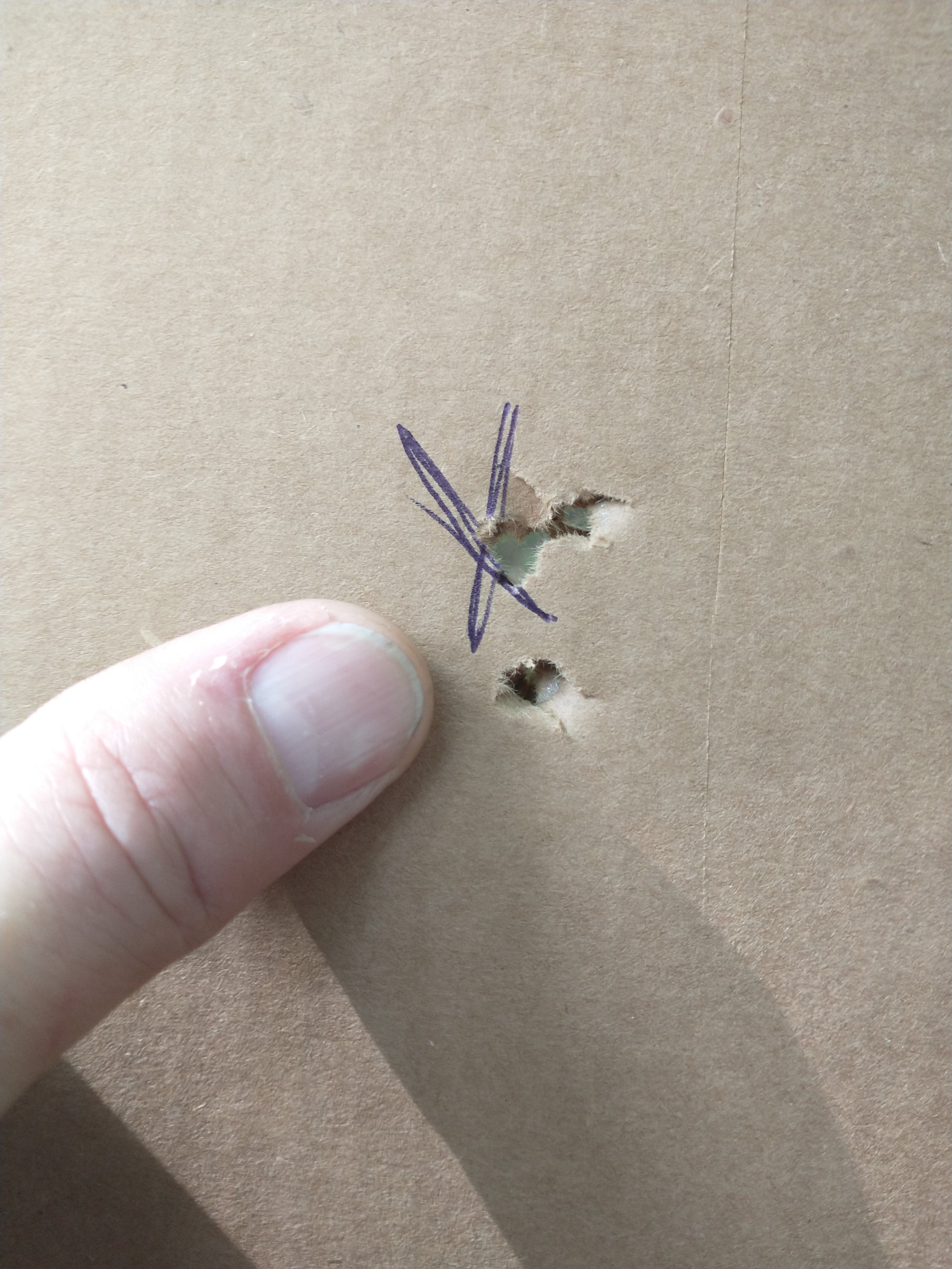

Great shooting and congratulations on experimenting outside the norm. I'm shooting my 28.5 grain cast slugs from my stock Crosman 2240 for 8.3 fpe. It's doing great at 7 yards with the stock peep sight. This is a 4 shot group and the low shot was the 2nd one from a new cartridge and it was definitely lower powered than the next 3. I'll be carrying it in my kayak this summer for snake duty.
Great shooting and congratulations on experimenting outside the norm. I'm shooting my 28.5 grain cast slugs from my stock Crosman 2240 for 8.3 fpe. It's doing great at 7 yards with the stock peep sight. This is a 4 shot group and the low shot was the 2nd one from a new cartridge and it was definitely lower powered than the next 3. I'll be carrying it in my kayak this summer for snake duty. View attachment 357992
Hi Ed, that’s interesting - what’s the reason for using such heavy slugs? Max FPE?
