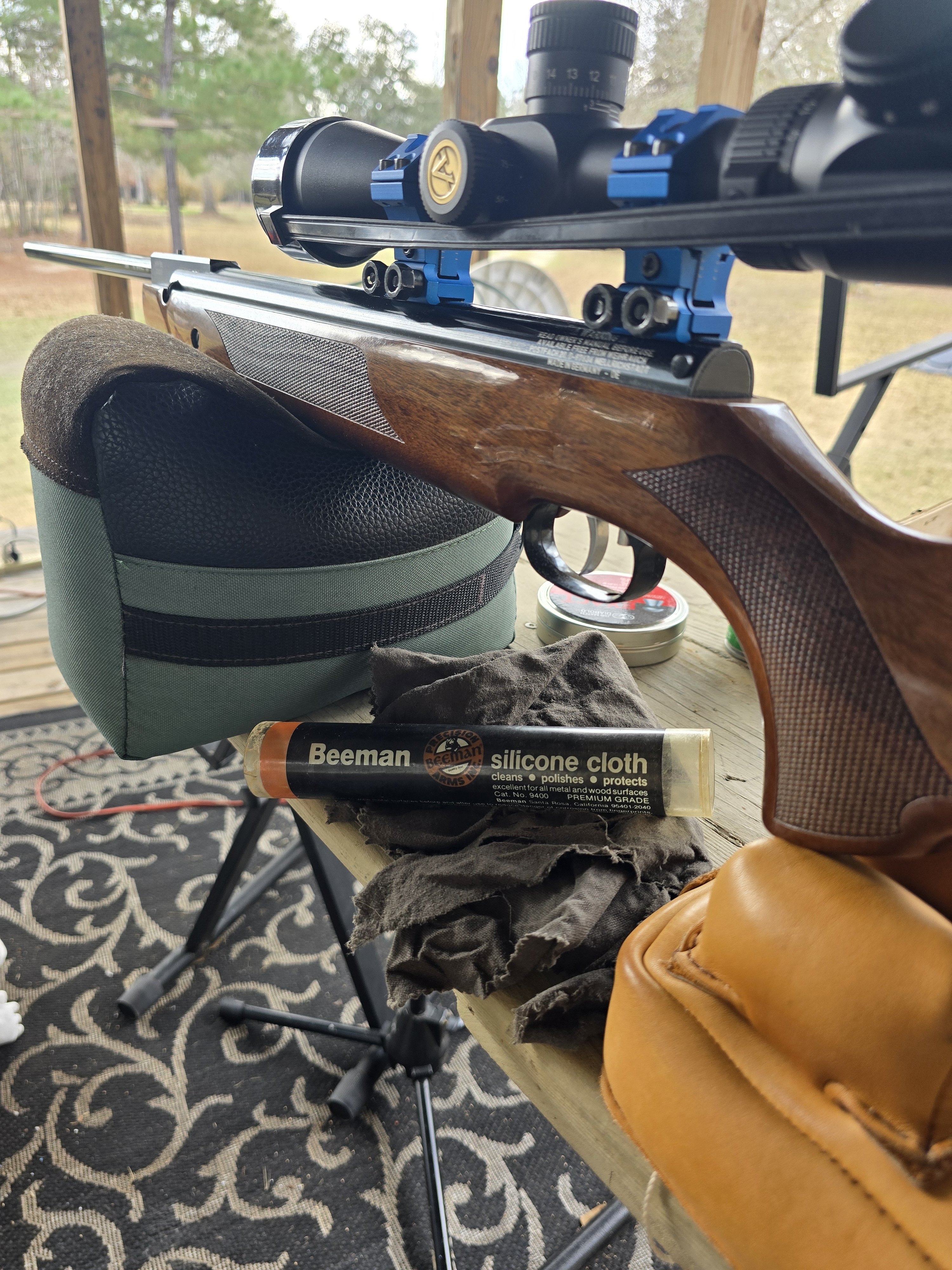

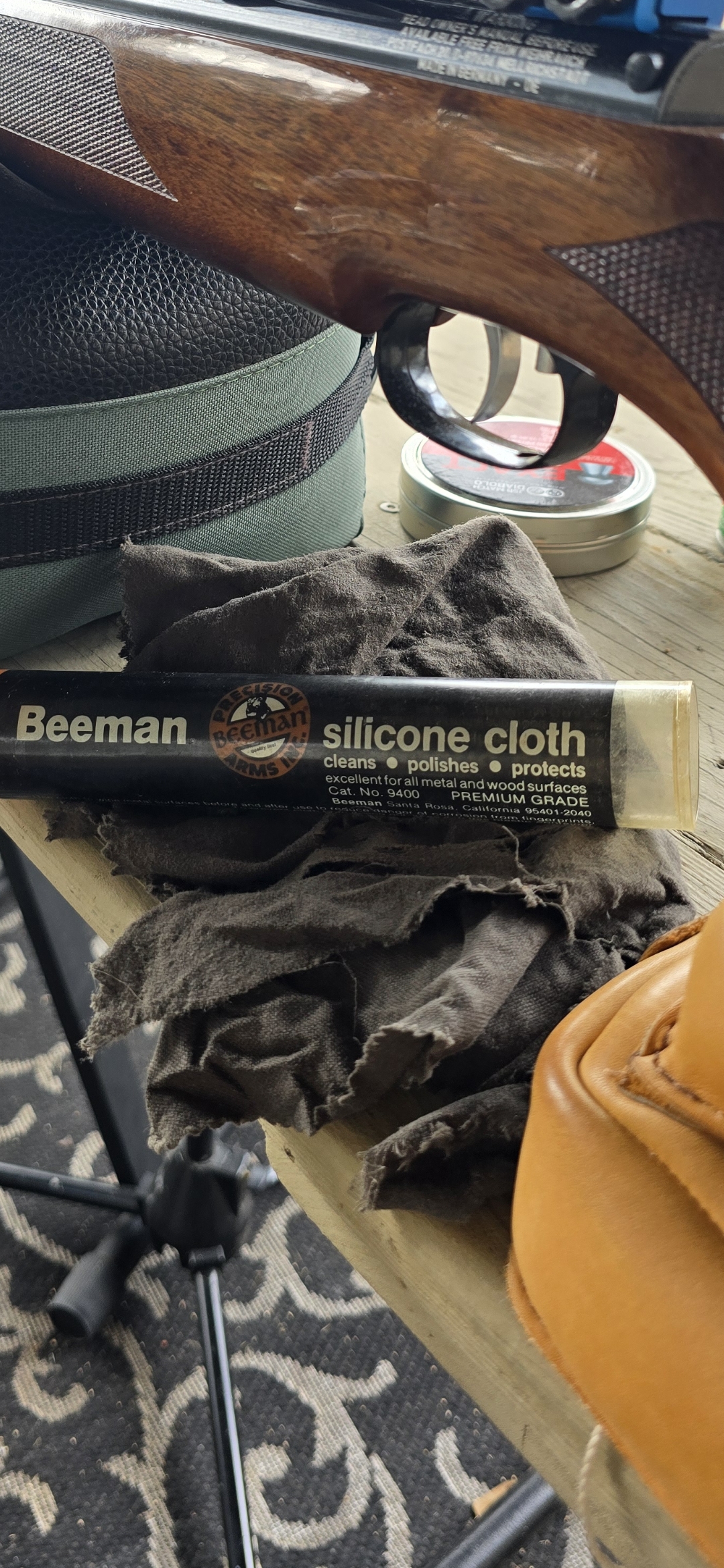

Beeman Silicone?
I don't get silicone oil on anything but high pressure orings, ect., but I have been whipping my guns down with these so called "silicone cloths" for forty+ years.
It feels oily, but not at all like silicone.
Silicone cloths are very handy. They do protect the metal parts and the wood stock finish. The only potential future problem is the silicones NEVER can be completely removed from the stock. Stripping the stock and using a lacquer thinner wash will get some of the silicones, but not all of them. Then when applying the clear coat, the left over silicones will cause ”fisheyes” In the finish.
Especially if you're spraying a finish. Mega fisheyes. Ask an auto body guy.
Yes I know and that's why I only put it on high pressure seals, but like I said, the cloth Robert Beeman put in that pack is oily like balistol, not like silicone. ??
I'm no chemist, but there are many types of silicone oil out there, made in many different formulations and viscosity weights. Whatever was on Beeman's cloth was not the same stiff stuff you lube seals with.
