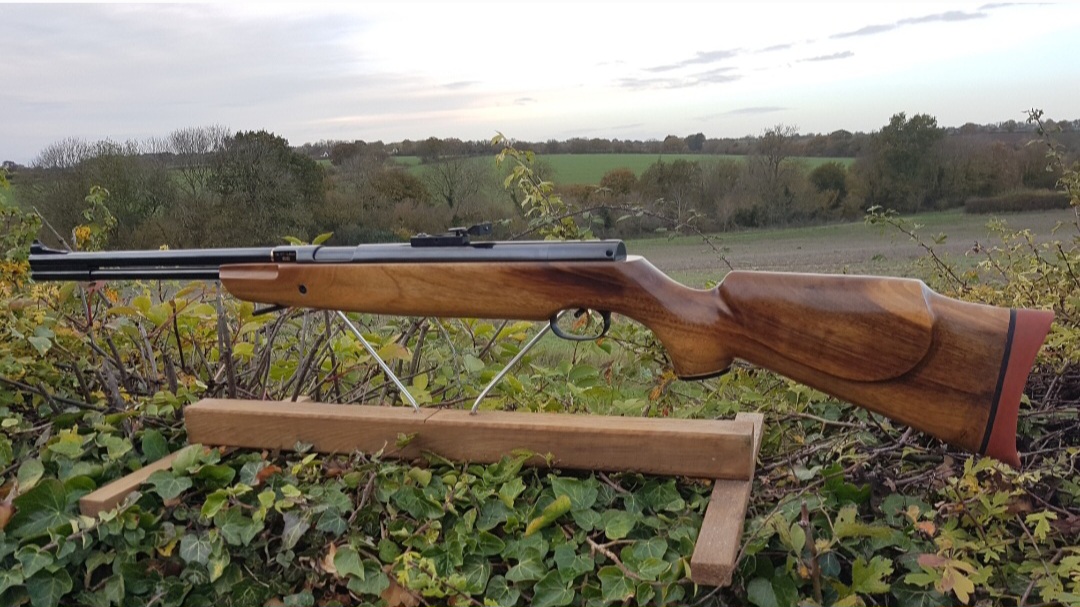

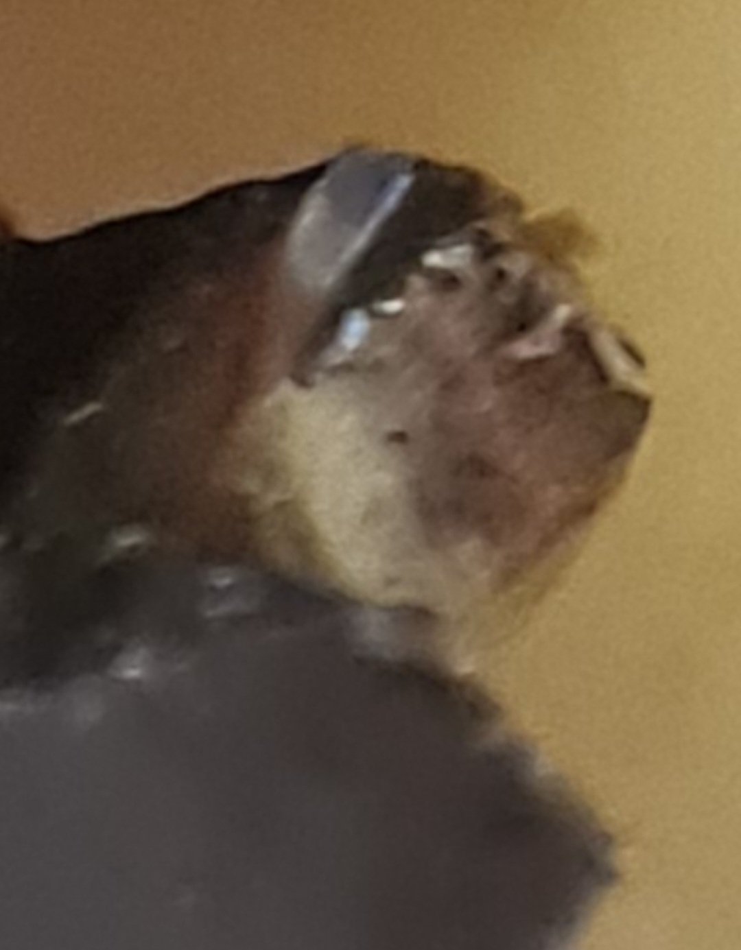

You may read that it is possible to grind the HW sear to take a TX rod (like I did) but I wouldn't recommend it. Yes it will function for a while, but may end up looking like this-
The sear in the first pic is one of the ones a fella had made and correctly hardened over here (can't remember who now) and is still going strong to this day in my 77 was a K-
Now am sure not to get into this. :). Not worth it, at least not for me. Thanks for the clear depiction of the trigger mod. And that sure is a nice gun rest!! :)
