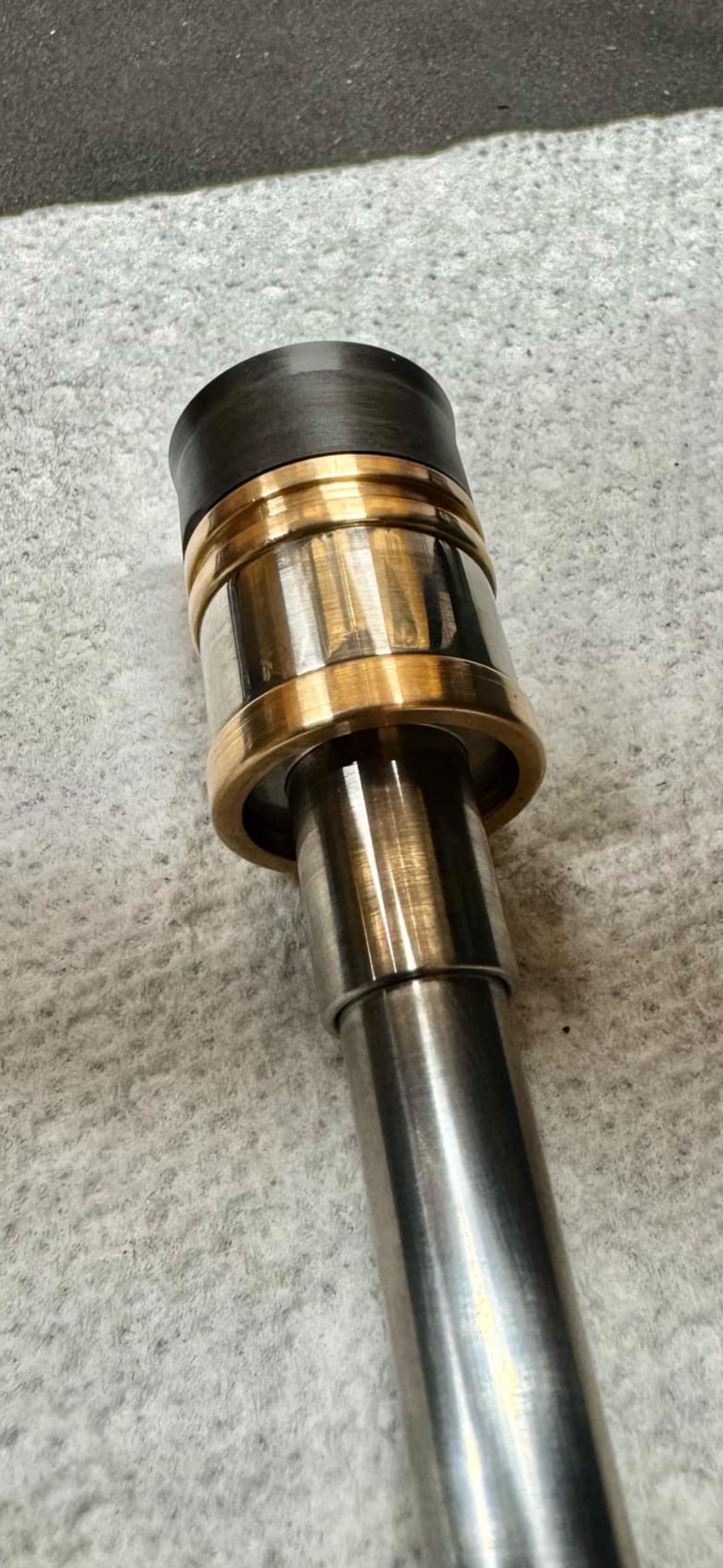

I do like the skirtless set-up in my TX, but it’s target only and sub-12. Running bronze bearings machined for fit in the comp tube, and set as far apart as possible helps with stability. Having a perfect or near perfectly straight rod is necessary too.
As with any tune, everything needs to be in balance….piston weight, spring rate, port size, stroke and pellets being used. Go too light on the piston, too light on spring, too small on port size or too heavy on pellets and you may see some accuracy robbing bounce. I’ve got mine set up at 90mm stroke and just over 155 grain piston weight including tophat and tuned for 7.87 to 8.44gr range.

Very nice, and interesting....my 77k has the 25mm comp tube and I ended up at about 165gr and 90mm stroke 👍

Is that the normal hollow TX style seal on there?
