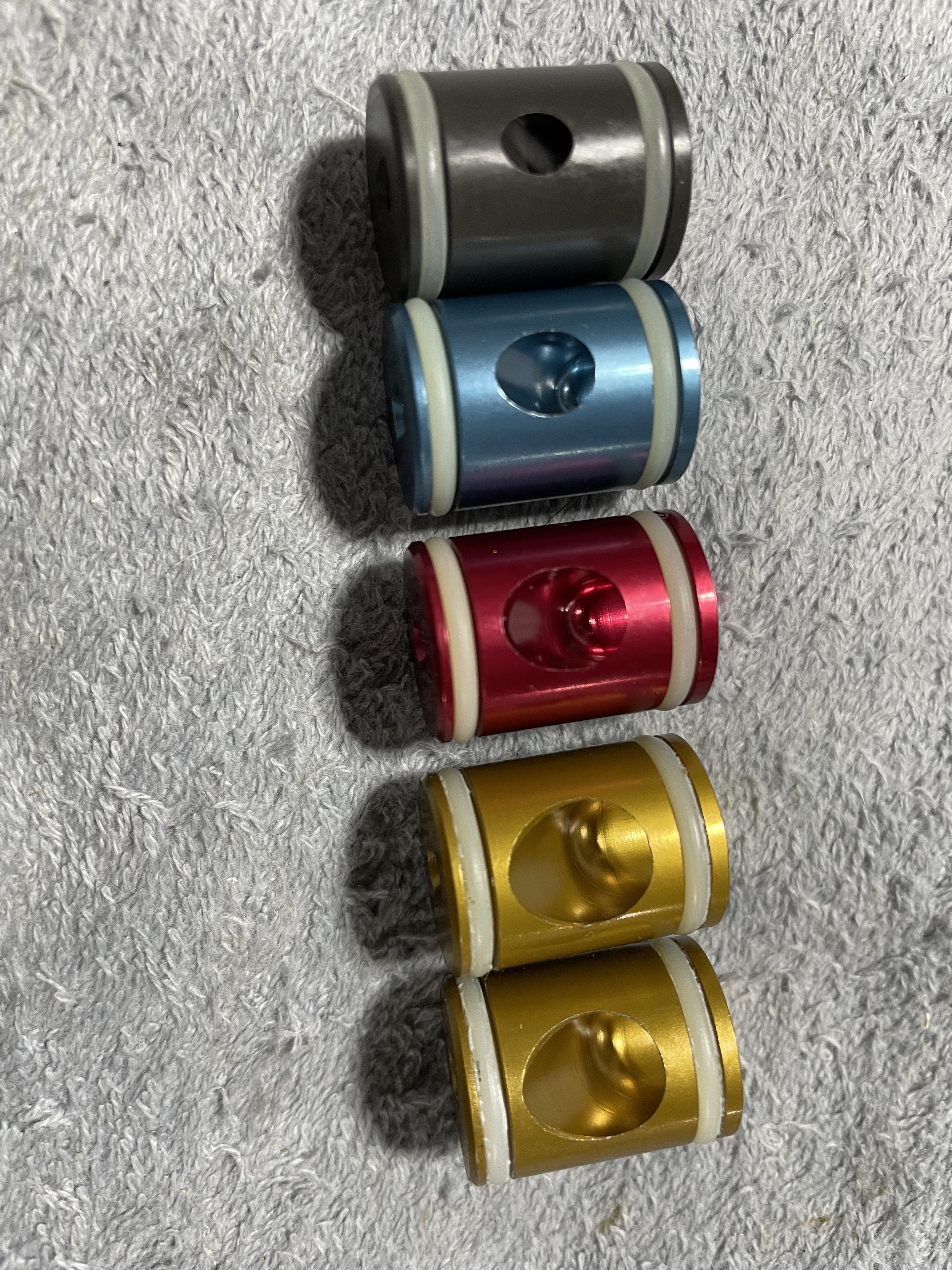

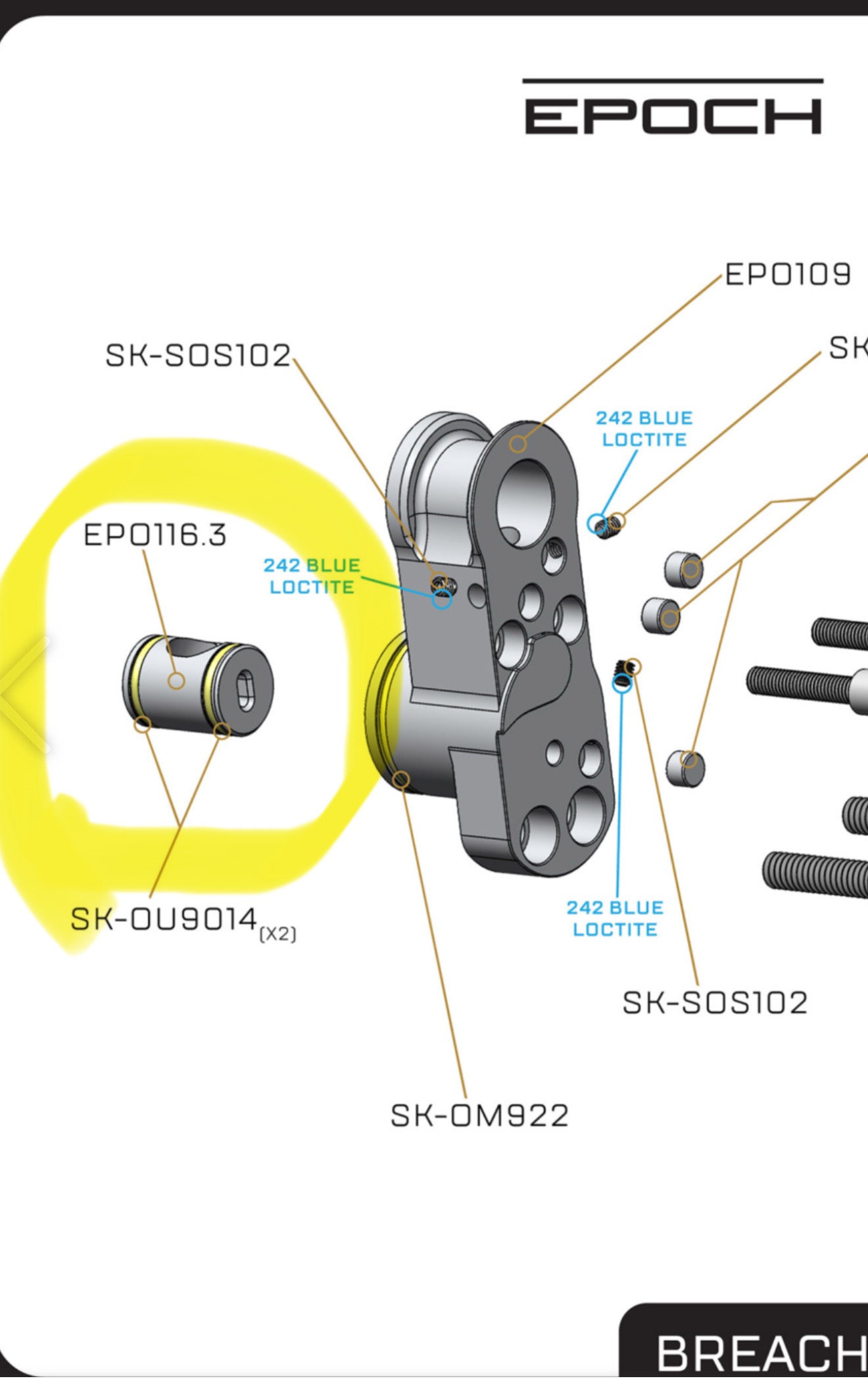

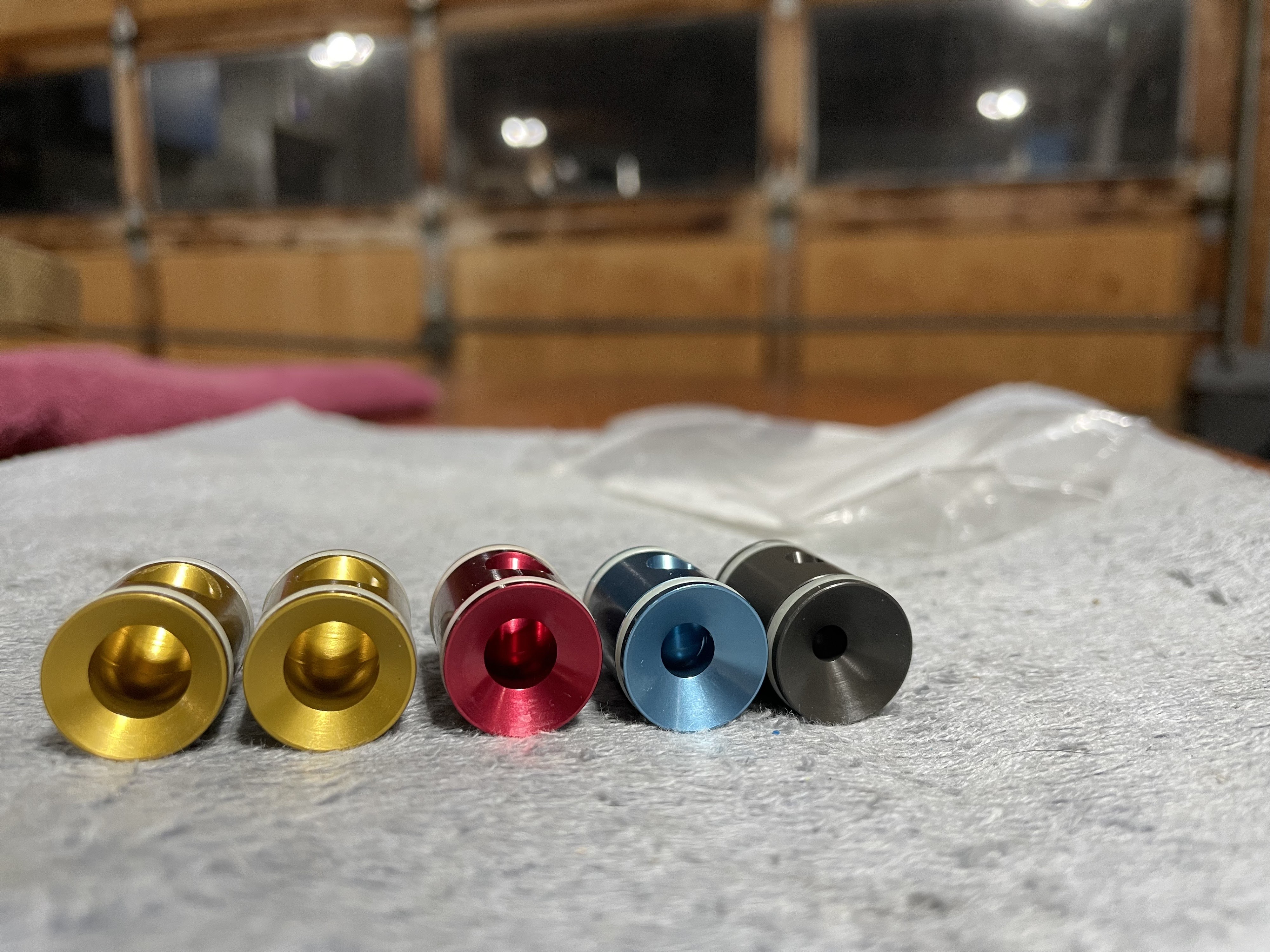

Skout part number EPO-116 is the transfer port. The guns have various sizes available, so it seems possible that with the smallest (black) one, power could be reduced to .177 pellet levels.
Sadly the Manifold having the transfer path up to the barrel is a MASSIVE @ .340' I.D.
Soon as you go below or near the "Second from left" seat the transfer path becomes a major mis-match ... don't shoot the messenger 😞
Until such time as they engineer a miens to choke the transfer path selectively for caliber we will not have a truly adaptive caliber platform ... IMO

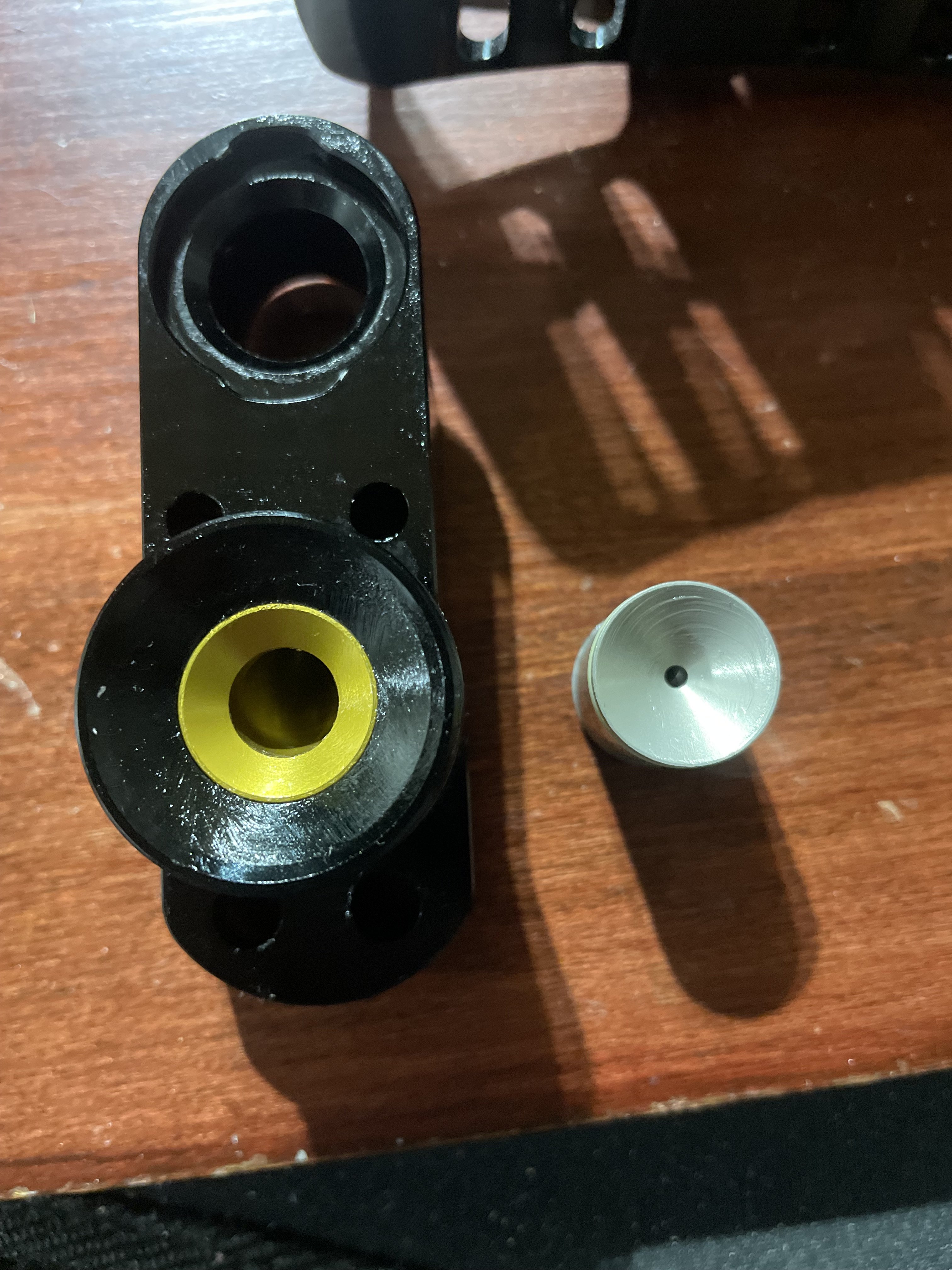

I have the Evo in .177 and like Lewis it is a laser at right at 12 fpe. Here is a picture of my transfer port in .177 and the transfer port out of my other Evo.View attachment 540349
Shown IS NOT the transfer "Port" .. as THAT IS the near .900" long passage within the manifold connecting the shown "Poppet Seat" to where the barrel plugs in and is locked in place.
Said passage is the equivalent of a typical removable "Transfer Port" tho it is fixed within the manifold.
This passage is @ .340-.350" in diameter, so having a majorly small/restricted poppet seat as shown indeed chokes air flow & the relatively HUGE transfer passage down stream of seat absorbs far too much volume to even be remotely efficient feeding a smaller caliber barrel fitted.

From the air pressure in plenum sealed by the POPPET head of the spool valve ... we have AIR taking this path ;)
THREW the Poppet Seat ( Where scout make differing sizes / colors )
THREW the Manifold ( Which is a @ .350" passage ) Aka: the Transfer port
THREW the barrel thimble ( Which is non restrictive leading air into barrel bore )
Ideally in such a valve system where there in not a poppet stem passing threw the poppets seats "throat" taking up area, The ideal size of the air path can be at or can be slightly smaller & for power a tad larger than what is the Caliber/bore size being utilized. My compromise in tuning was to use the tapered straw insert into the manifold reducing area and an amble size Seat .. as High Output was still my use, but wanted better efficiency with reduced valve dwell.
