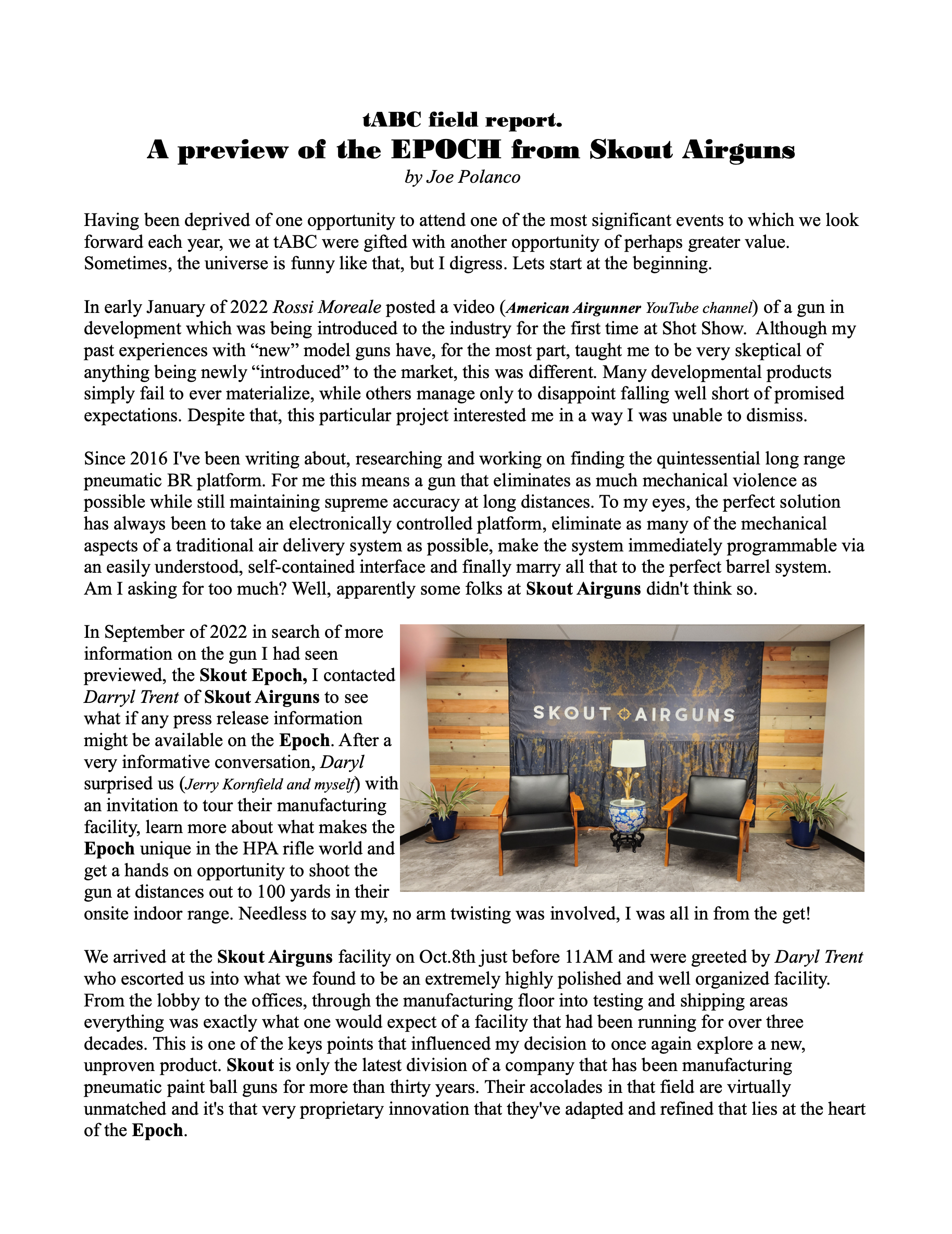

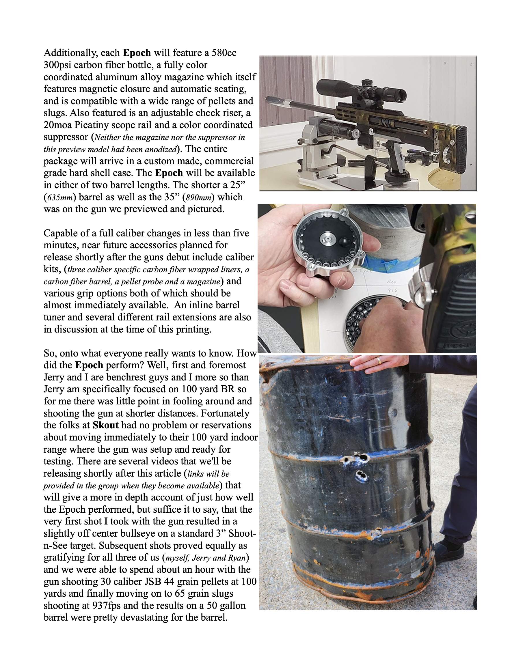

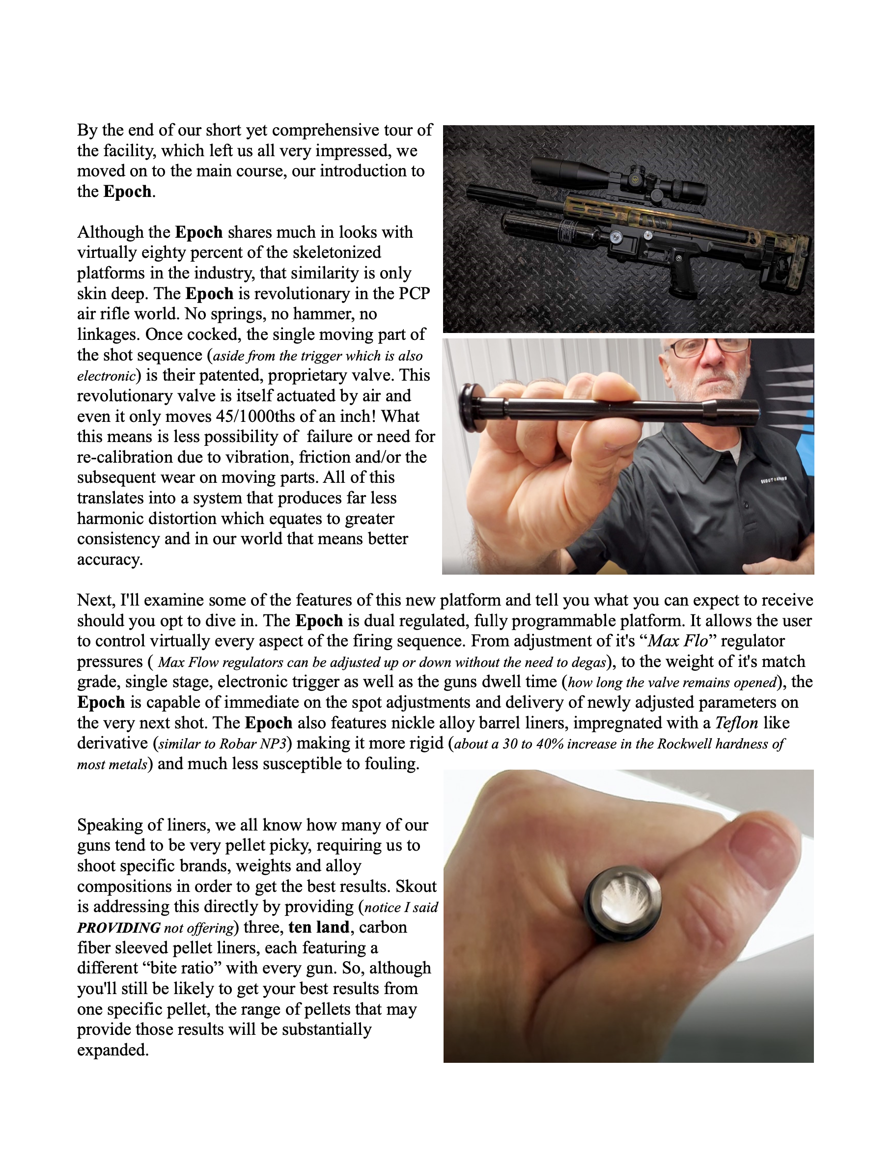

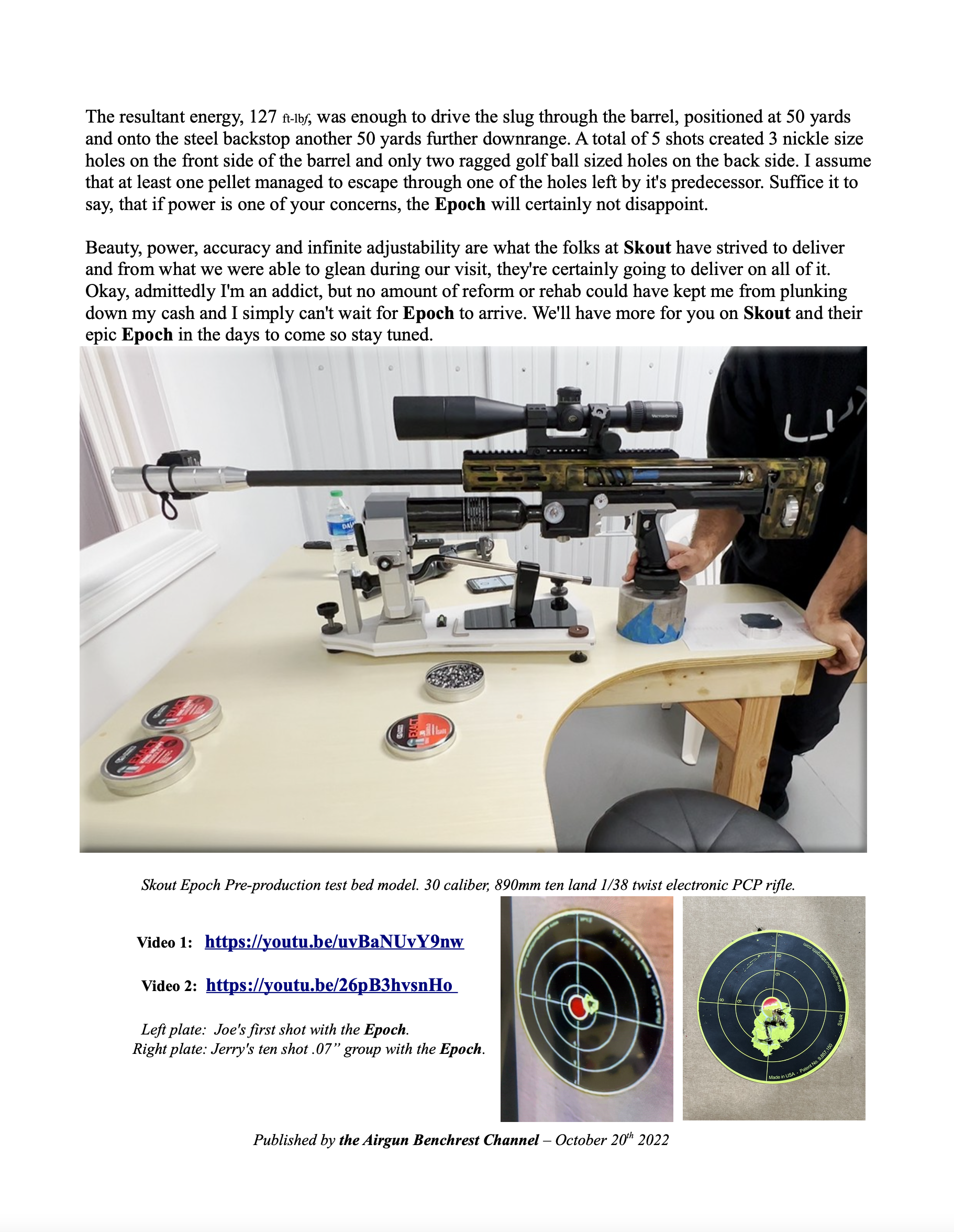

When you purchase the rifle you can choose a 889mm (35") barrel or a 630mm (25") It will come with 3 barrels in total. All 3 barrels are with with-in the same caliber and about a 1 tho difference. All 3 barrels will also come with a carbon sleeve permanently attached.
When will these rifles be available to purchased by public?
Thanks Darryl, do you have the estimate of price for this rifle?
Retail is $2,950. As you might know, it comes with the 3 barrels in the same caliber each this is own carbon sleeve, a Plano 42" hard case, a very nice Compensator along with a carbon 500cc 300 bar tank and custom grips with 3 different palm swells and all the new technology someone could want. Hope this answers some of your questions. ~Darryl

I hope that there is enough regulated plenum for power and efficiency and that the valve as well as the transfer port can be changed for the needs of a larger caliber. We'll see if Epoch lives up to its name as the New Epoch in the PCP world!...
The valve orifice is much larger than anything available. It allows us to produce velocity with a smaller plenum which increase efficiency. The transport is very large with a tremendous amount of volume. Most guns need to change springs and hammer weights to shot the larger slugs. We can achieve this in all calibers by simply adjusting the regulator.
I understand the system operates at a lower than normal pressure. What is the max and min regulated pressure the system CAN operate?
Dave
Hey Dave. We are still doing some testing. But we have the top end at 2400 PSI . We have the low below 400. We are currently at Sub 12 to 145 ft/lbs. and shooting pellets below 400 up to 2400.~Darryl
