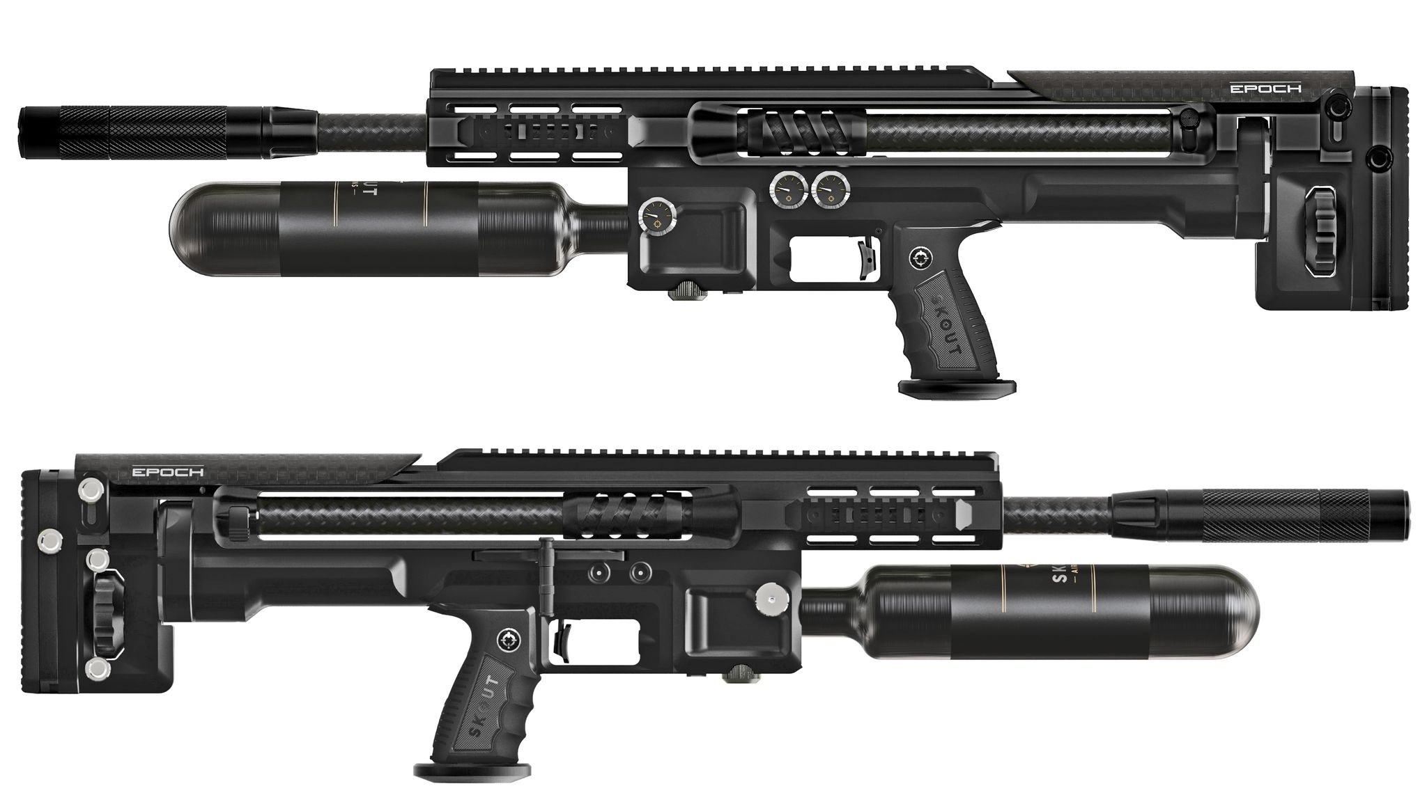

In my opinión, a Wolverine at 1800 - 2000 and a Vulcan 3 1800 are perfectly in price.
The Epoch implies a new Technology or a Technology closer to the HUBEN, LCS, Rattler and Sidewinder. It is absolutely clear that the future is in this new way of firing, hammer less.
If the Epoch happens to be efficient, accurate, solid made, reliable, confortable, silent, an with a wide range of fps adjustment possible, could worth 2500 with one barrel, easily.
The idea of telling us : we will give you three barrels and you should try them to find if any of those barrels works for you, do not precisely sells confidence.
I think that must of us would say: Just give one barrel, a CZ that we know that will shoot as a champ both pellets and slugs.
All new Technology (ok) But attached to a barrel that we know that performs.

-Lets talk about what really matters here: -Plenum size and valve size equate to velocity of the projectile (44 grain 30 caliber) at pressure , will launch this projectile at 880 fps @ 1000 psi or 68.95 bar with a 889mm barrel (35")
That sounds great, and how many shots can it achieve with a full tank of 0.5l 300 bar at that power and that regulated pressure? Does the efficiency change if the power is increased?
On a 300 Bar (4300 fill) with a 500cc tank shooting 880 fps using a 50.15 grain JSB pellet with a 35" barrel, we achieved 100 shots before any noticeable drop off.~Darryl
😲 Wowza! That's 100, 86fpe shots, from a single fill off a 500cc tank!?!?!
Running the numbers of total fpe from a given bottle.....and comparing that to all of the airguns I've played with.....that's astonishing efficiency.
Usually, something like a combined 2000fpe out of a single fill from a 500cc bottle is pretty decent (40 consistent and useable shotsx50fpe).
You're talking about 8600fpe from a single fill from the same 500cc bottle (86fpe x 100 shots)
Youre filling to 300 bar instead of the typical 250, and you've got a longer barrel on that thing than normal, but I still wouldn't expect the total fpe output to be more than 4 times as much. Impressive indeed, bordering unbelievable (and I say that from somebody who really hopes your claims hold true and you see success in the market, a huge leap forward in performance is always welcome).
