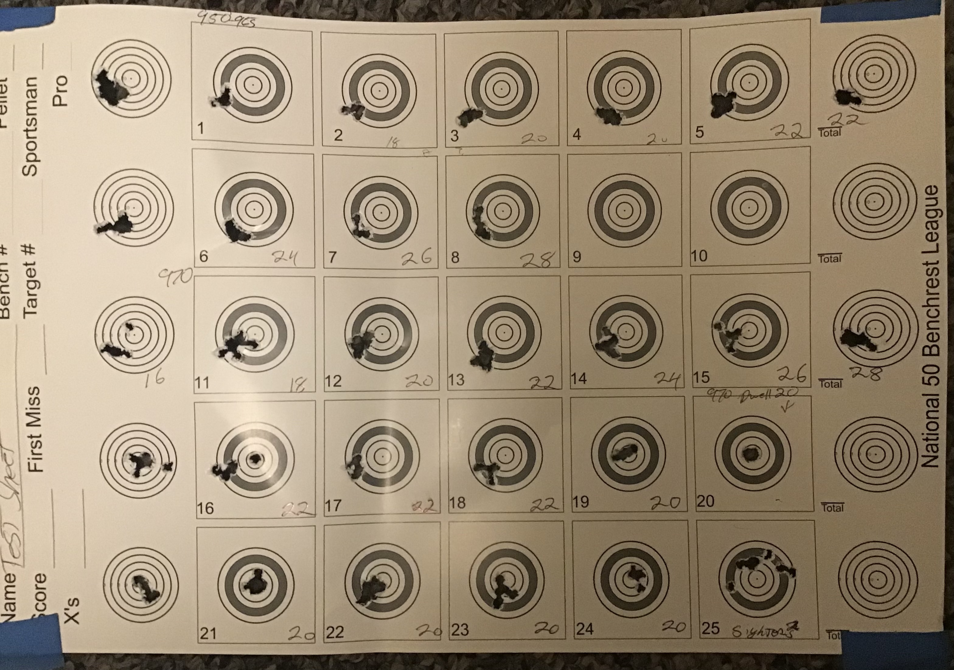

When i got my Epoch, i went by the recommendations of others and never really tested it out for myself
In the past, i was timid to try out different settings in fear that i could not get back to my original, but this fear has been calmed by the ease of adjusting a Skout rifle..especially if it has digital gauges.
I have normally been running my Epoch with JTS 22.07g pellets, flying @970fps on a 27 dwell. HPR-1500 LPR 190
I am using a highly polished Lothar Walther Bull barrel
With this system, i did well at EBR. scoring in the top 20 for 50yard benchrest.
for the testing, i started with a lower fps of 950-960 and adjusted the dwell setting to 16. Take 5 shots at the bullseye
Move to next target, raise the dwell by 2 and take 5 more shots...Just like Bill described
These were shots1-8, including the sighter on the right side.
On shots 3rd row, sighter-sighter, were shot@970-975 fps
the 4th row, i revisited the settings at 22 and 20 ..target 20 being the best so i kept those settings for row 5....not quite the same as target 20..but good
I went back to the range the next day to try out some more settings.
I wanted to do a row of 5 shots after seeing what happend the day before on the final row
I looked at the previous days results and started with 950fps ..looking for consistency
each row was shot with a different dwell setting-5 shots per target
Pellets were weighed
Will try some more next week
Mike
Mike, thanks for your detailed post. Was the testing done at 50 yards?
What settings have you finally settled on? Do you believe 970-975 is actually better than 950-960?
Appreciate your testing and insights.
Thanks
Barry
Hi Barry
All the test were done at an indoor range at 50yards
The settings i am using is for 975-980 with a dwell of 27. i have used these settings outdoors
Mike
