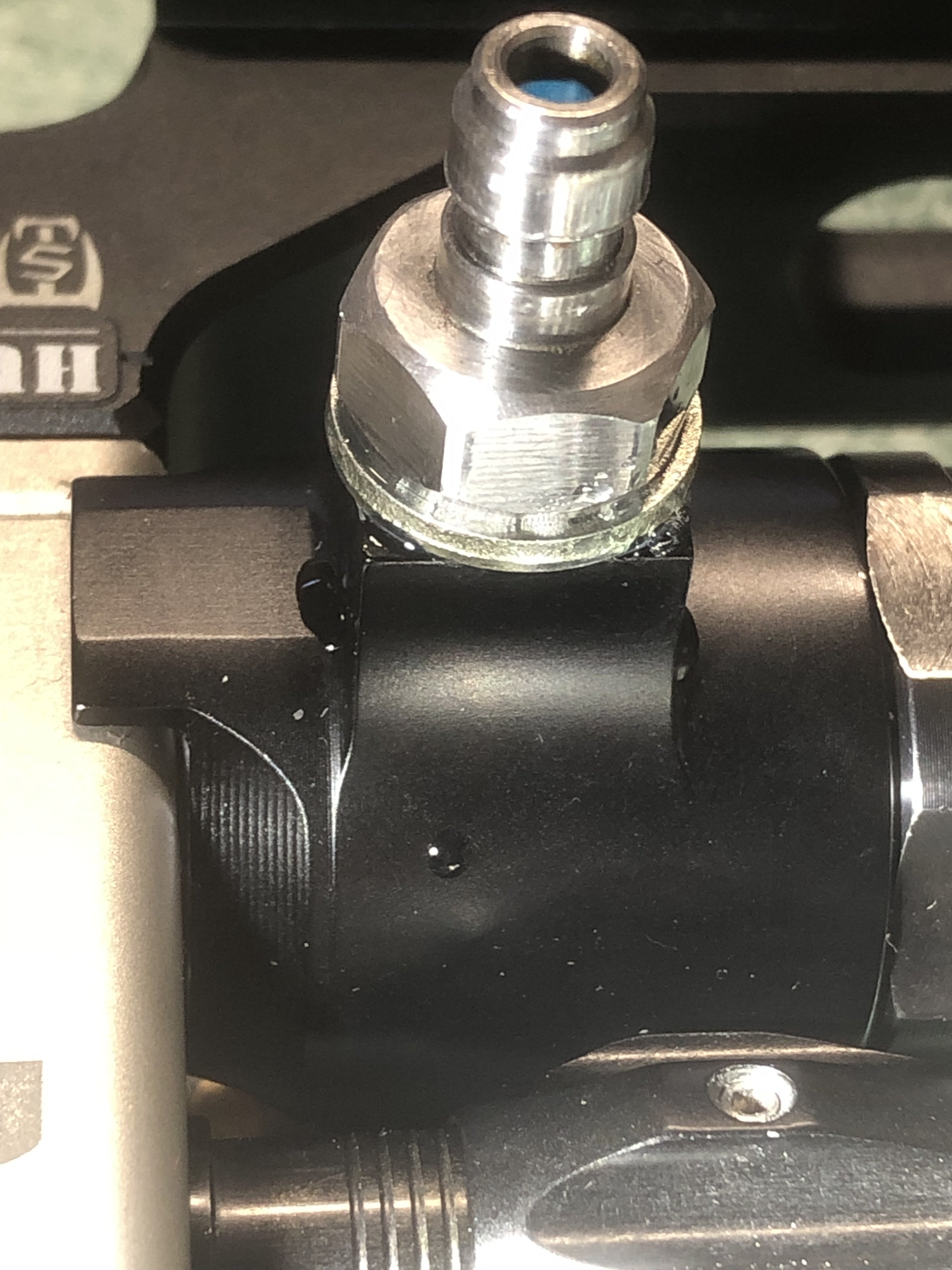

Question for you all, what is a good liquid solution to use that I can apply to surfaces to find exactly where a leak is coming out? One that won't cause rust or damage OR's. Near as I can tell the leak in my gun is coming from the HP reg but I'd like to make sure. Or maybe it's coming from two different places??

100% Silicon oil to find the leaks worked for me

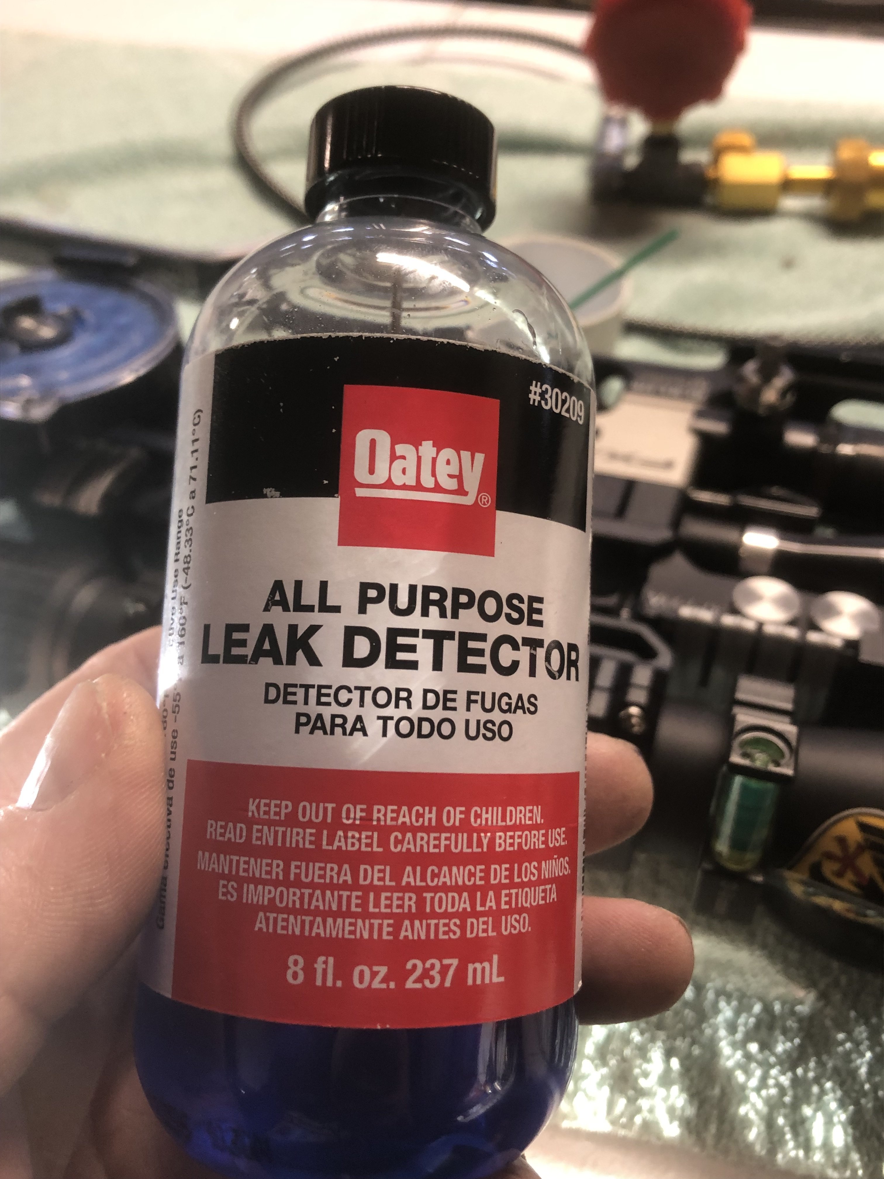

As far as finding leaks, I’ve tried many types including electronic beep detectors, which only work best if it’s a substantial leak. Same with the CRC spray foam that already has bubbles that make it difficult to find small leaks, and those foam detectors leave a mess.
What’s worked the best for me, is the gas leak detection fluid from Home Depot made by Oatey’s. Blue in color, and I use tiny sponge tip swabs(the type women use to color up their eye lashes with), that I dip in the leak detection fluid and apply it onto all the different potential leak points in a pcp. Since I’m applying tiny droplets at a time I use a flashlight to help spot the tiniest of bubbling from a leak. Clean up is easy with isopropyl alcohol when done

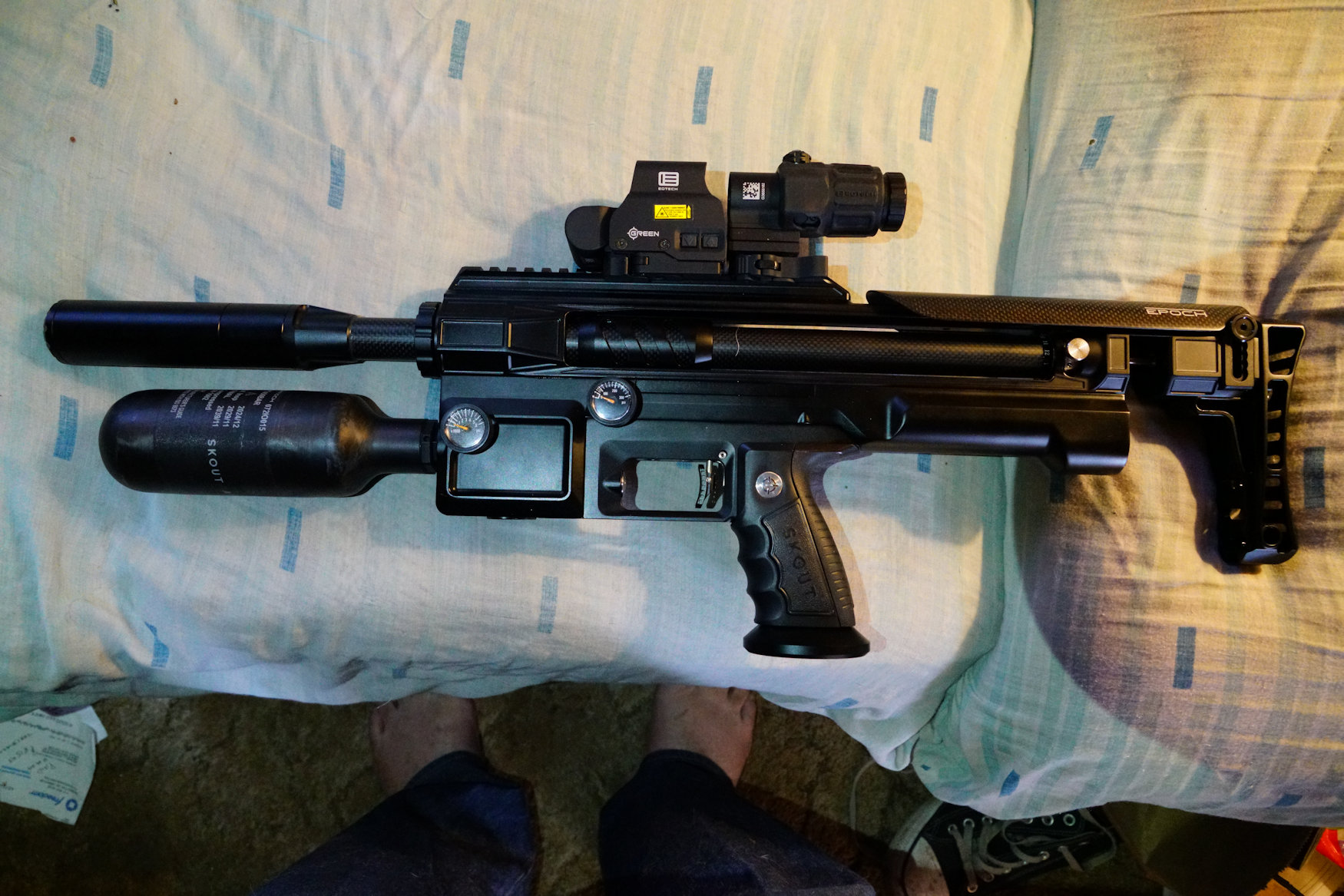

Kieth at Skout has been quick to respond to me and sent me that brass piece which arrived in 4 days, included the weekend. My EVO still leaks though after installing it yesterday morning, which I told to Kieth about. Now he's sending me the entire HP reg assembly to see if that fixes the problem. If it doesn't the gun will likely be going back to the company for repair or replacement.

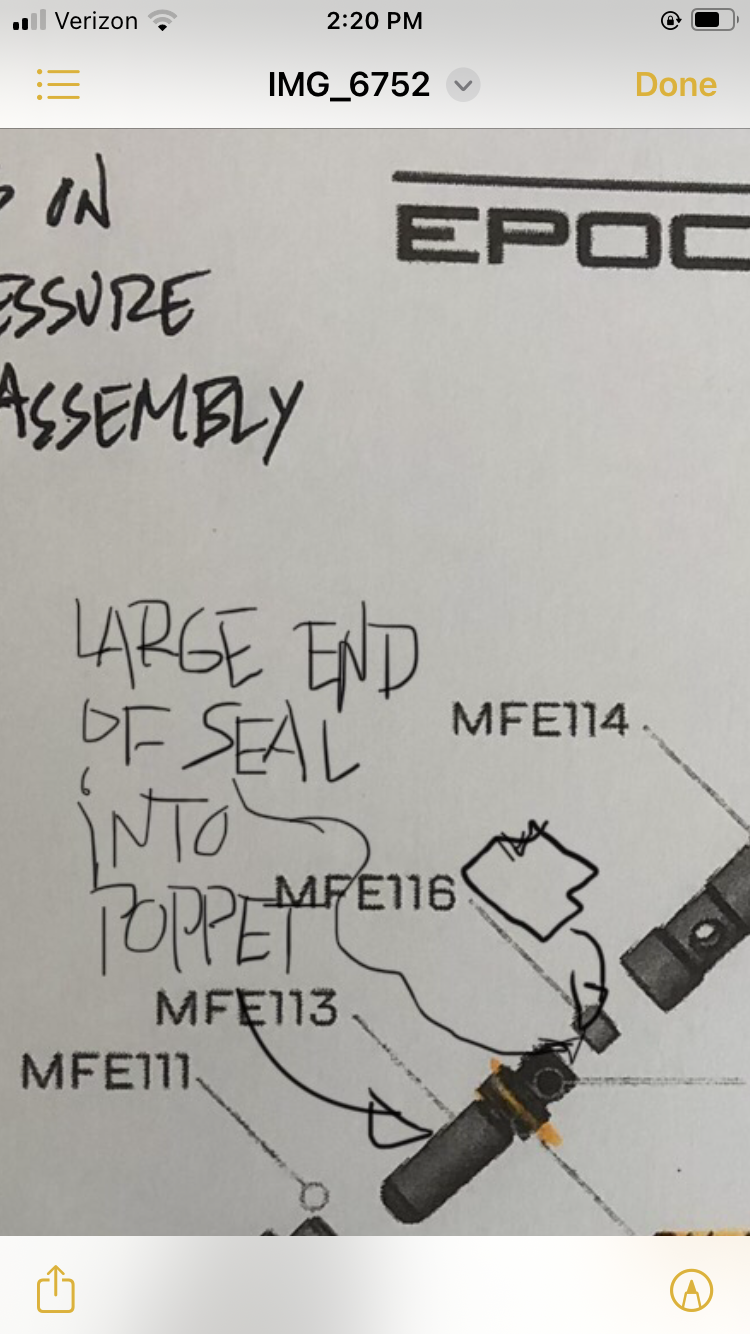

Steve disassemble your LP reg and check that tiny bugger sized(a healthy bugger, if I may)plastic seal. Yours may be hammered or installed incorrectly. In your spares box with all the seals look for a plastic bugger sized rod with a step in to it. That’s the seal that goes into the LP reg. Originally Skout used a white material but has since changed to a better material that a clearish green in color. The correct way to insert it is large side in as shown in my sketch notes

Steve disassemble your LP reg and check that tiny bugger sized(a healthy bugger, if I may)plastic seal. Yours may be hammered or installed incorrectly. In your spares box with all the seals look for a plastic bugger sized rod with a step in to it. That’s the seal that goes into the LP reg. Originally Skout used a white material but has since changed to a better material that a clearish green in color. The correct way to insert it is large side in as shown in my sketch notesView attachment 549564

Kieth did send the new reg assembly out with 2nd day shipping, I installed it today, and it worked fine. I filled the gun to 4000 psi but right away I discovered there was also a leak coming from the bottle gauge so I tightened it down a tad which fixed that leak.
I shot 30 rounds of 22 cal 32.2 grain Altaros slugs down the barrel and got the velocity to 828 fps/49 fpe by bringing down both regs. This is because a UFT match I intend to start using this EVO in has a max fpe limit of 50 fpe. 25 yard groups in 12 mph winds coming from behind me were 1/4", just ragged holes so I was happy about that.
