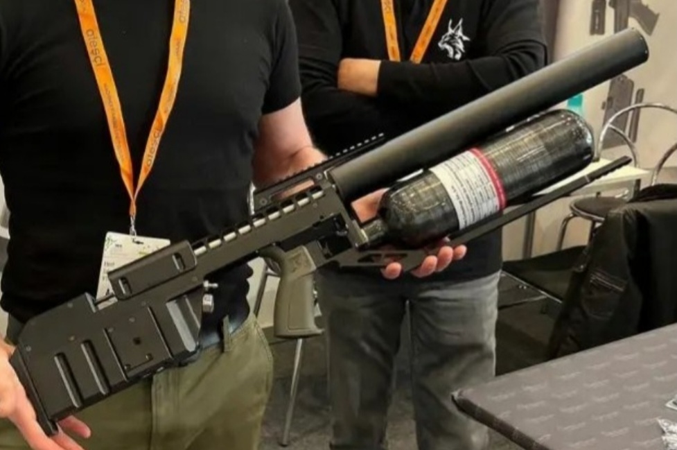

We are on the same page. Happy to know that I'm not crazy. I had the pleasure to touch and shoulder it, I was in RTI 3 weeks ago. What a f***ing BEAST.
you got the pleasure to hold this..? .. I'm definitely putting coins aside for one I all ready sold my 22 cricket.. and canceled the purchase of a prophet compact..just waiting on information on this thing..
View attachment 294291you got the pleasure to hold this..?
Yes sir, but this is the first proto. They have changed something (buttstock size and external finishing). It has 2 plenum, balanced valve, externally adjustable reg, externally adjustable HS, 600mm and 700mm barrel, built-in moderator. Apparently, it can reach over 140fpe in .25. Knowing RTI, I suppose they are not lying.
