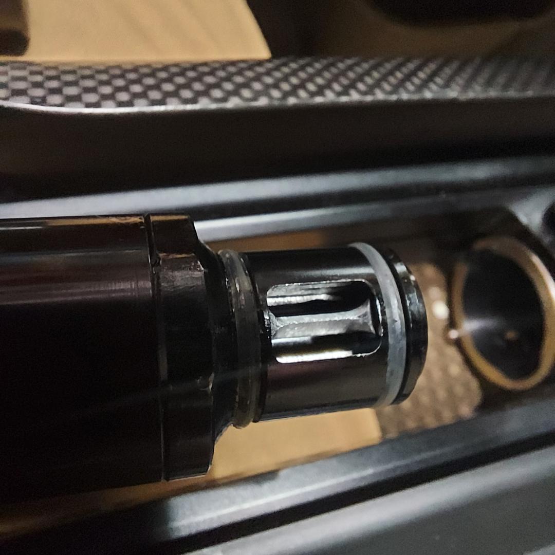

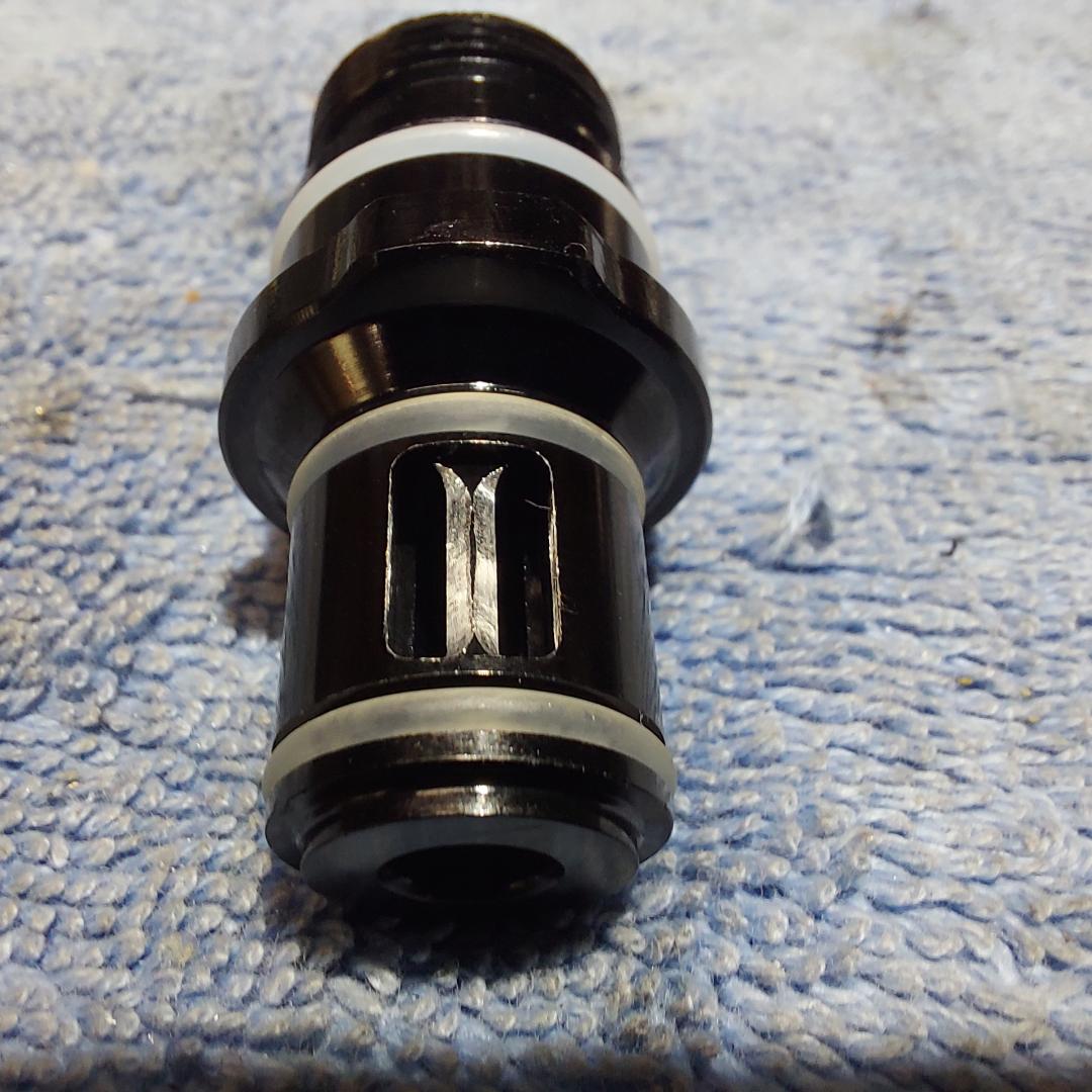

Also made a change to the BARREL THIMBLE .... as was found with the .30, the center bridge area between the port slots was very wide and blunt being IMO flow restrictive. This was my first go at it to just thin the bridge at ports entry to a air parting edge. Testing saw a slight FPS increase.
Went back in and reworked the bridge again making it THINNER all the way into bore. Retest showed a 35 fps increase changing nothing else.
SO YES .... IMO as SKOUT is manufacturing / machining these 2 slot / port barrel thimbles, they are being a tad conservative leaving some room for improvement.
