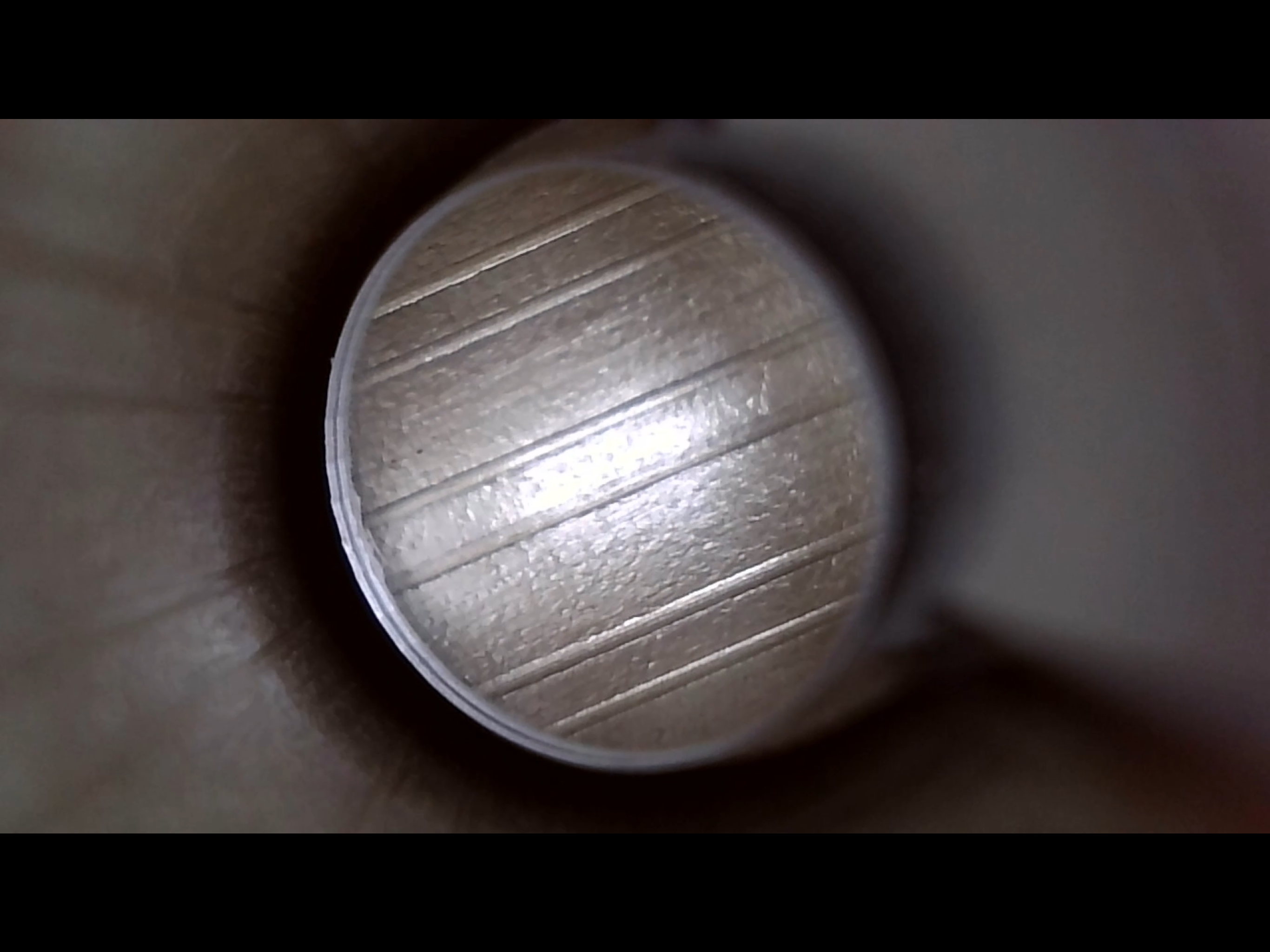

The one I tested looked very rough on the inside, and yes they are aluminum barrels.
Accuracy wise it was still doing very well but I did not like to see the inside finished like that 😅

There appears to be RANDOM Flecks of something adhered to the bore / coating, like small grains of grit / dust ??? You push a pellet threw with a rigid rod and you can absolutely feel it. Being whatever is the impurity now part of the coating applied can't see it wearing away as it is HARD as the coating itself.
Now said ... weighted against a conventional steel barrels bore it is indeed ROUGH ! ... But in actual shooting these plated / coated aluminum barrels they do shoot well tho :D
That mottle pattern looks almost like etch marks from before the nickel Teflon coating was applied. As ugly as it looks, providing there is an even bearing surface for the projectile to glide over, the texture may not matter. This, providing there is no raised edge to the texture that can shave the projectile; or a long gap between high areas that the projectile can fall into and either "crash" or yaw.
If you think of the mottle as hone marks in a engine cylinder, then they may not be as upsetting. If the mottle fills with lead flakes and grouping ability drops off after a few dozen shots, then this texture is a functional problem.
If the mottle runs all the way down the barrel, end to end, what I am suggesting is more likely. If it is only at the muzzle, then it seems much more like a defect, that should not be explained away. What does the breech end look like?
Part of me wonders if what you see is large patches of Teflon impregnation next to "bald" patches, so, the Teflon rich bits have less friction than the Teflon poor areas; hence the uneven friction. It is very hard to tell from one image.

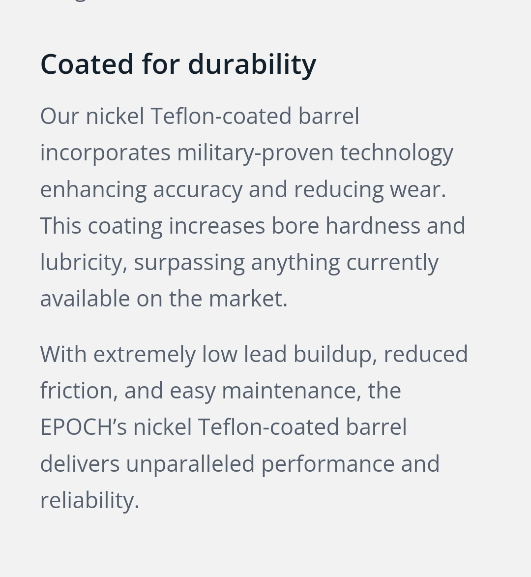

Our barrels are made of an alloy and the coating that we apply to them is extremely hard and wear-resistant. The surface unevenness that you see is just the coating, but we have found that it does not have any impact on the performance of the barrel. if you have any other questions please let us know!
