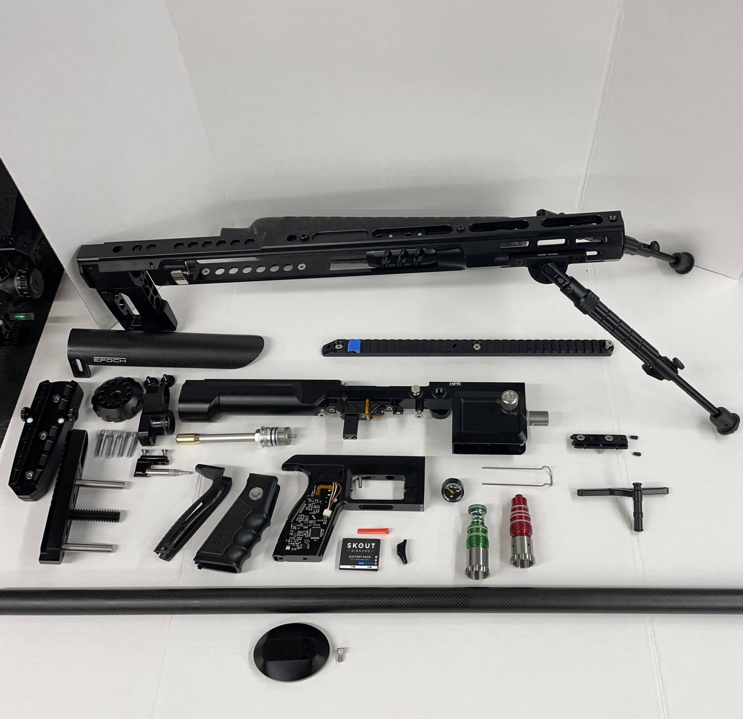

I'll start with a basic parts strip.
I received mine on Friday and had a chance to disassemble/reassemble today.

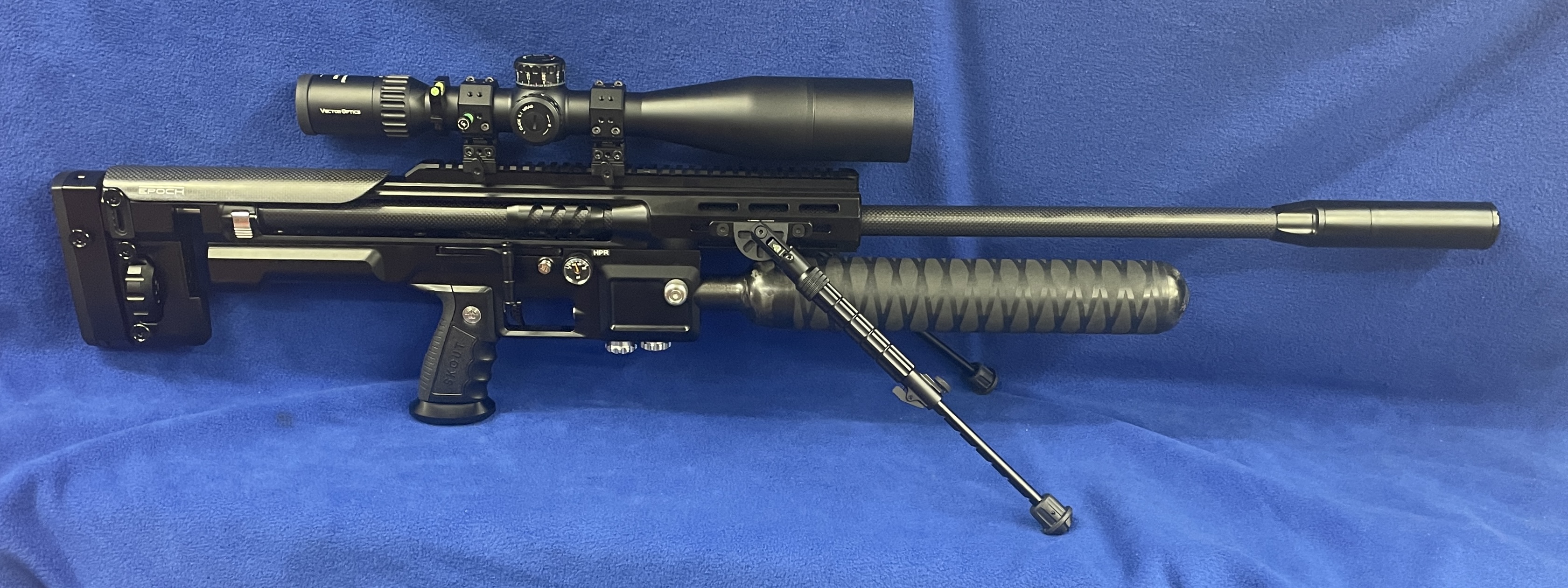

Installed the 895mm barrel and 700cc tank.
Topped it off with a Vector Optics Continental 5-30x56 FFP 34mm scope. LOVE this scope!
Added a UTG recon flex two piece M-lok bipod.

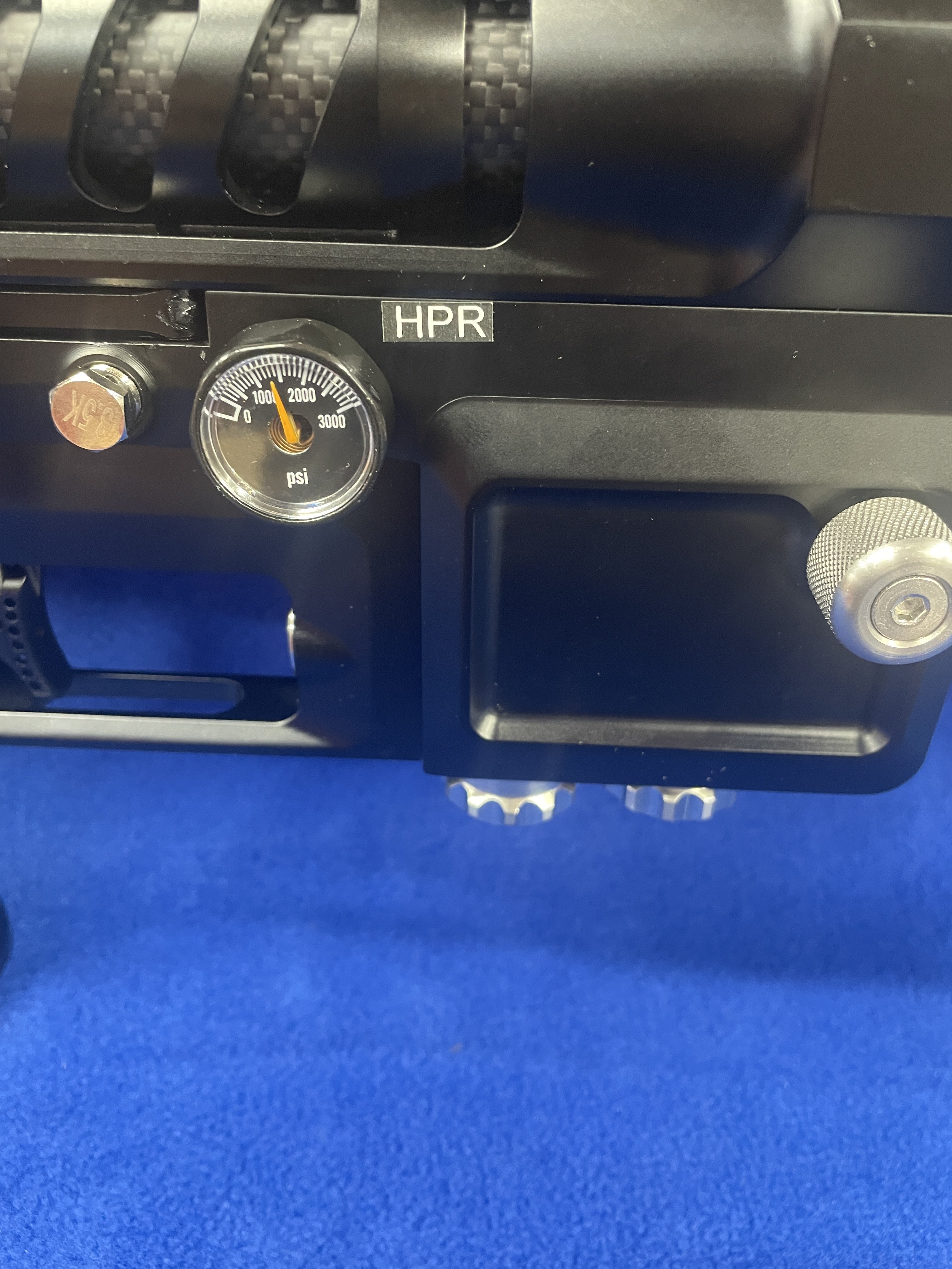

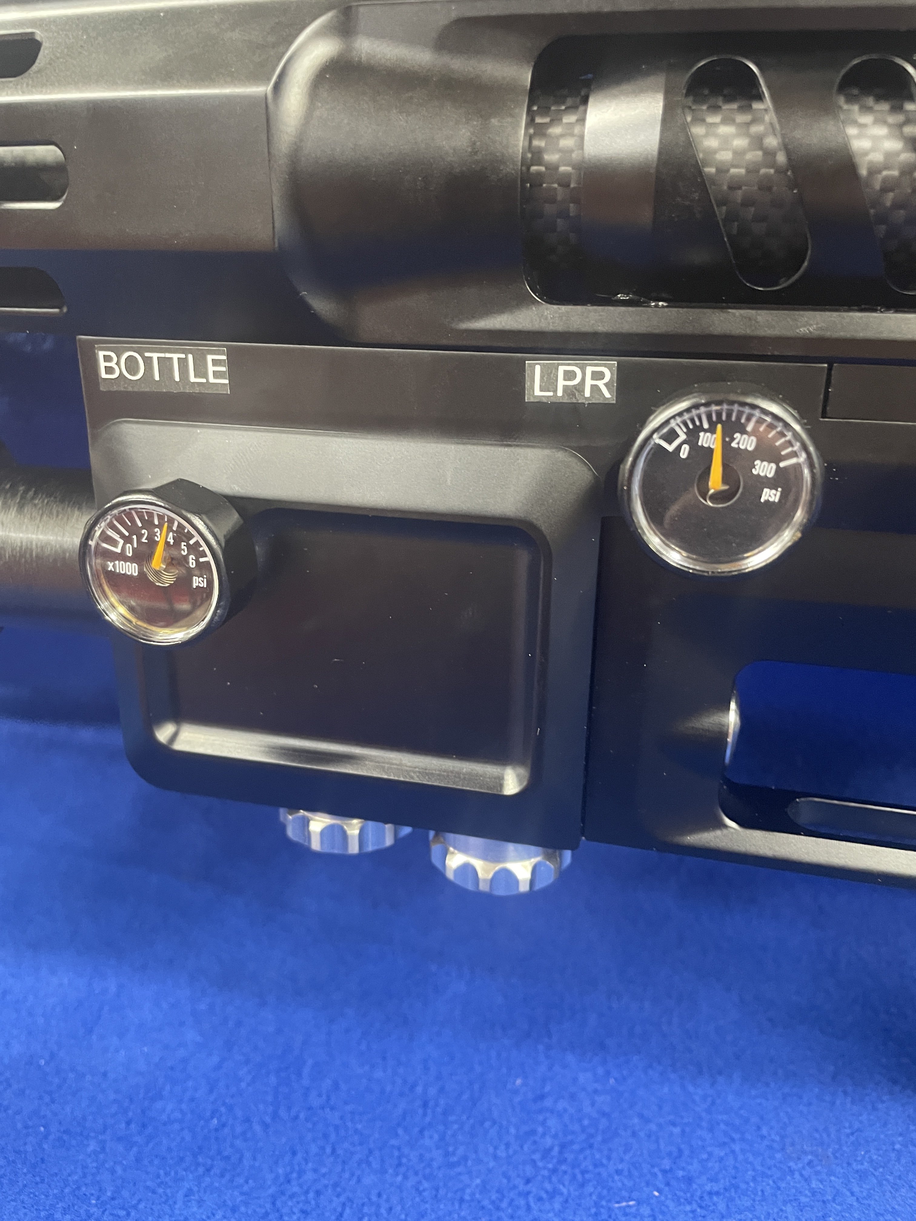

Stuck on a couple of labels to remind me which gauge shows what.

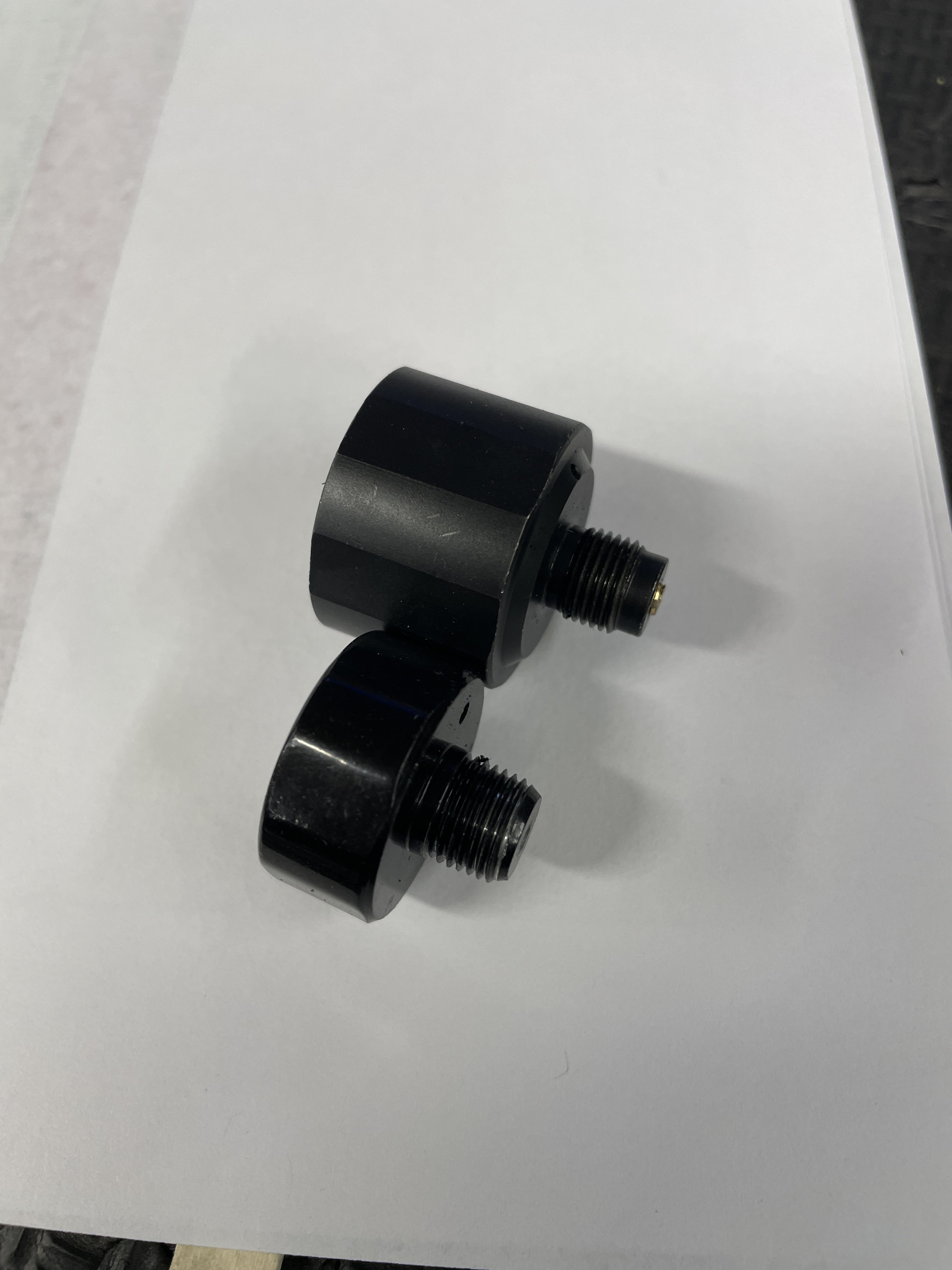

The first thing I wanted to add was a Sekhmet digital gauge but the ones on the Skout are NPT - no go.
Also the hole for the gauge is on the edge so it can't be sealed with the delrin washer.

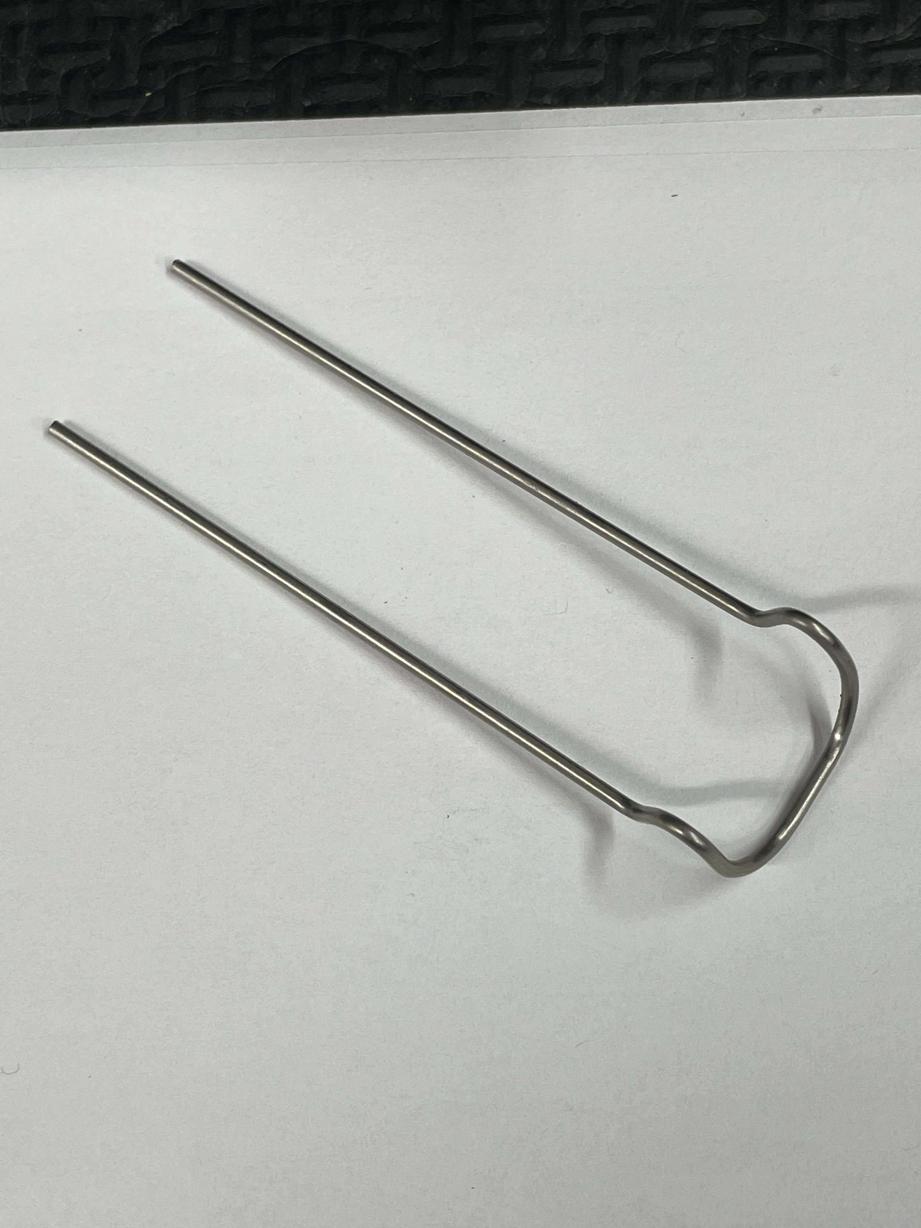

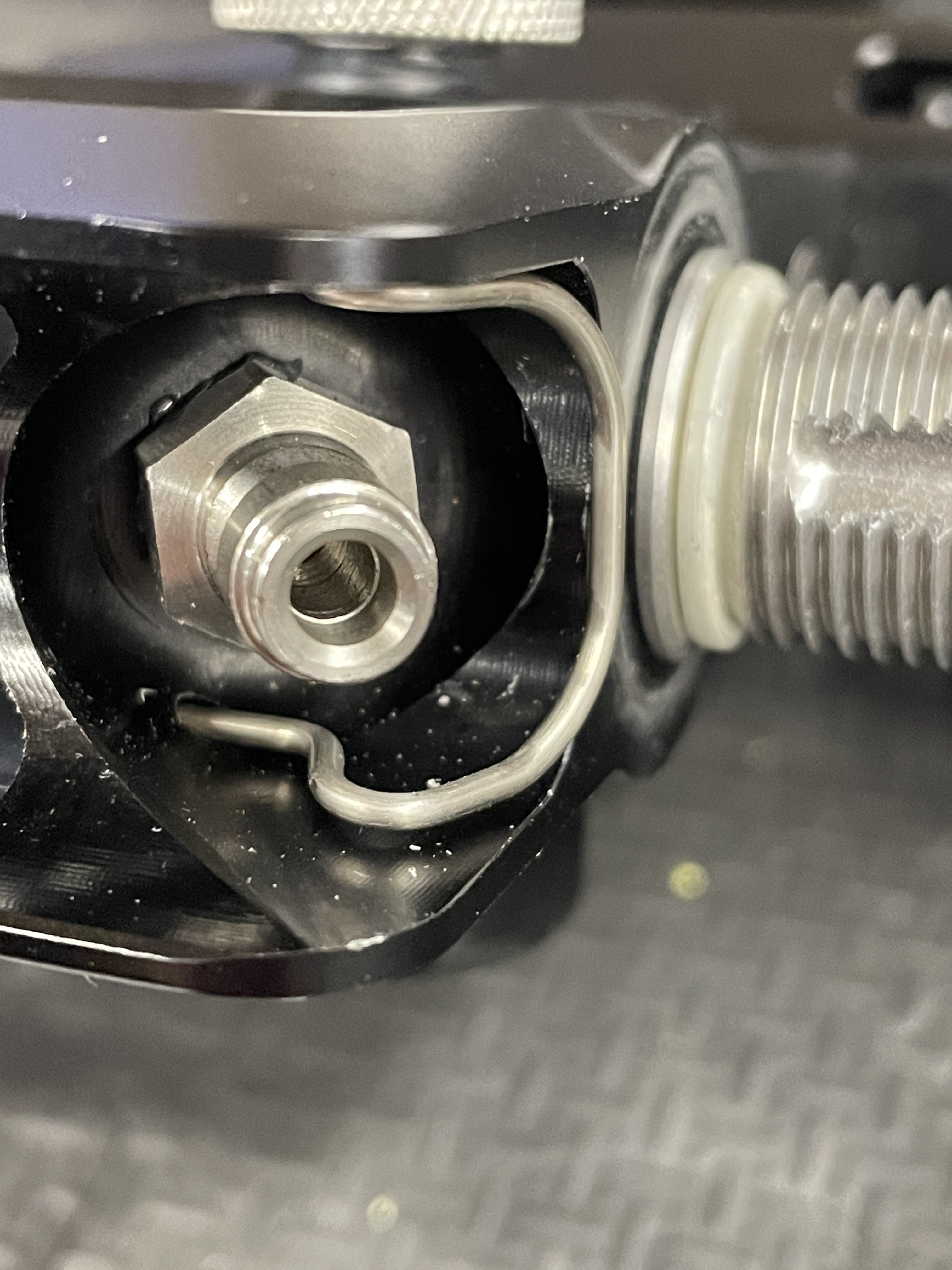

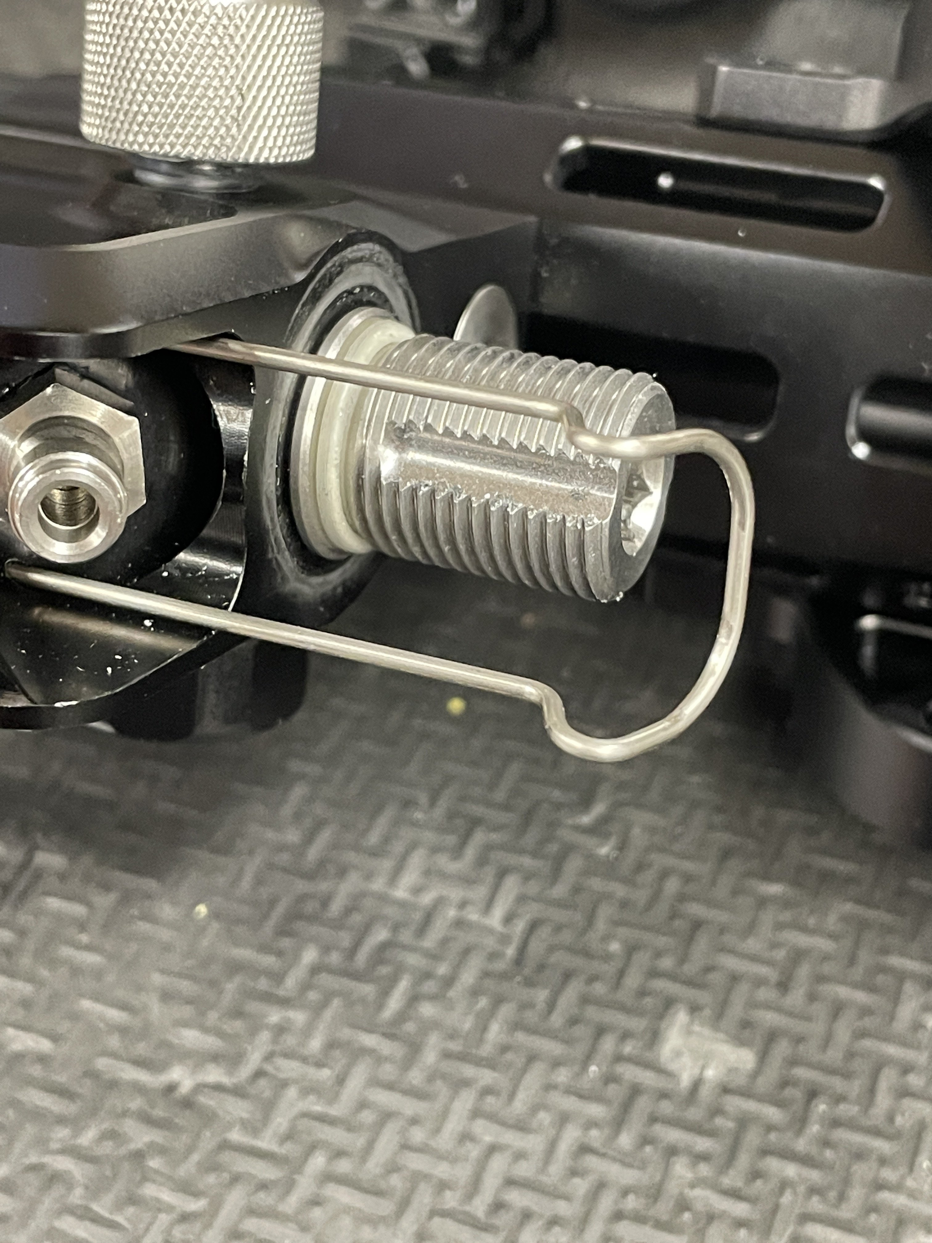

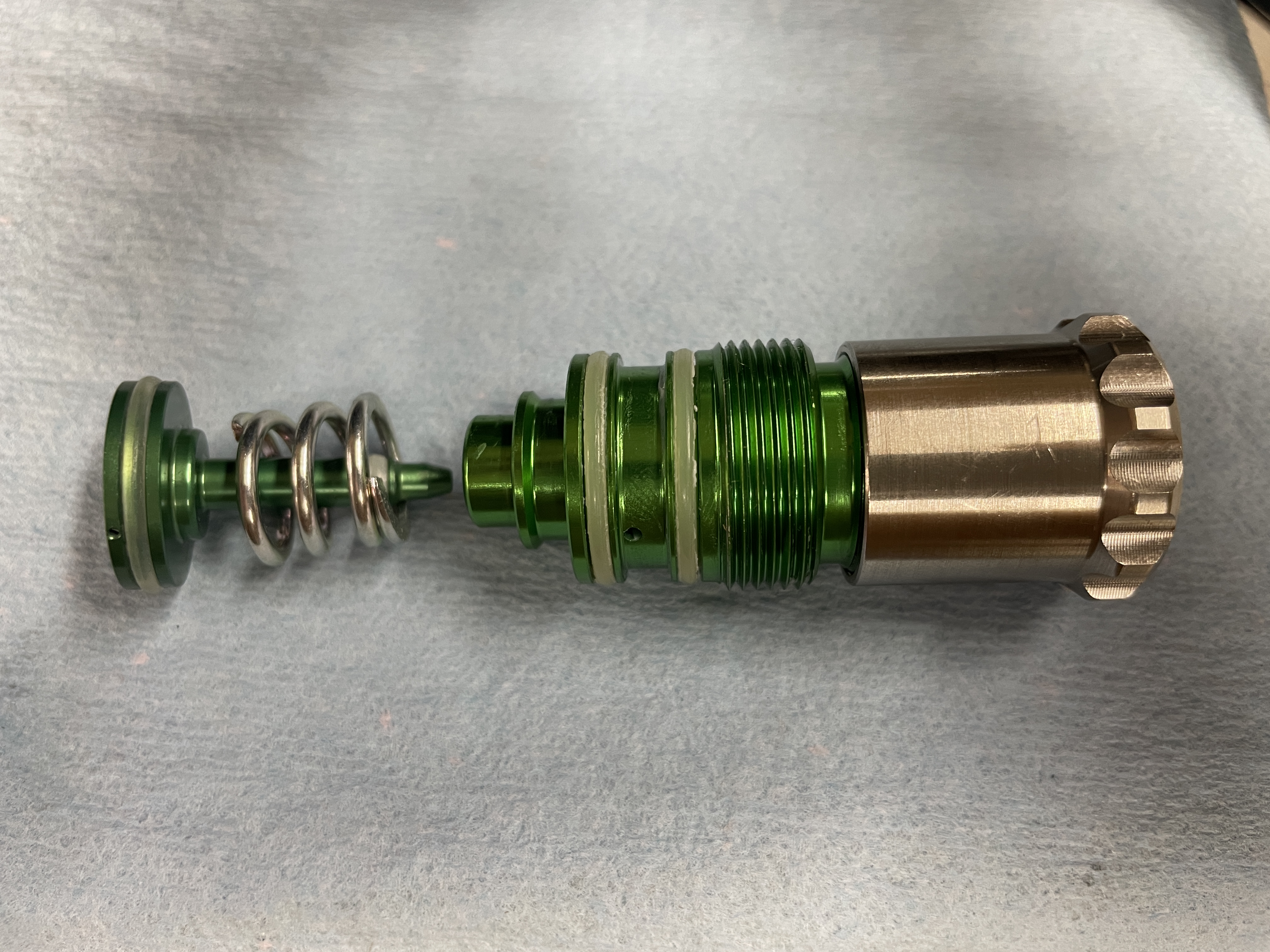

The regulators are held in with a wire retainer which I really like.
The regulators are very well constructed.

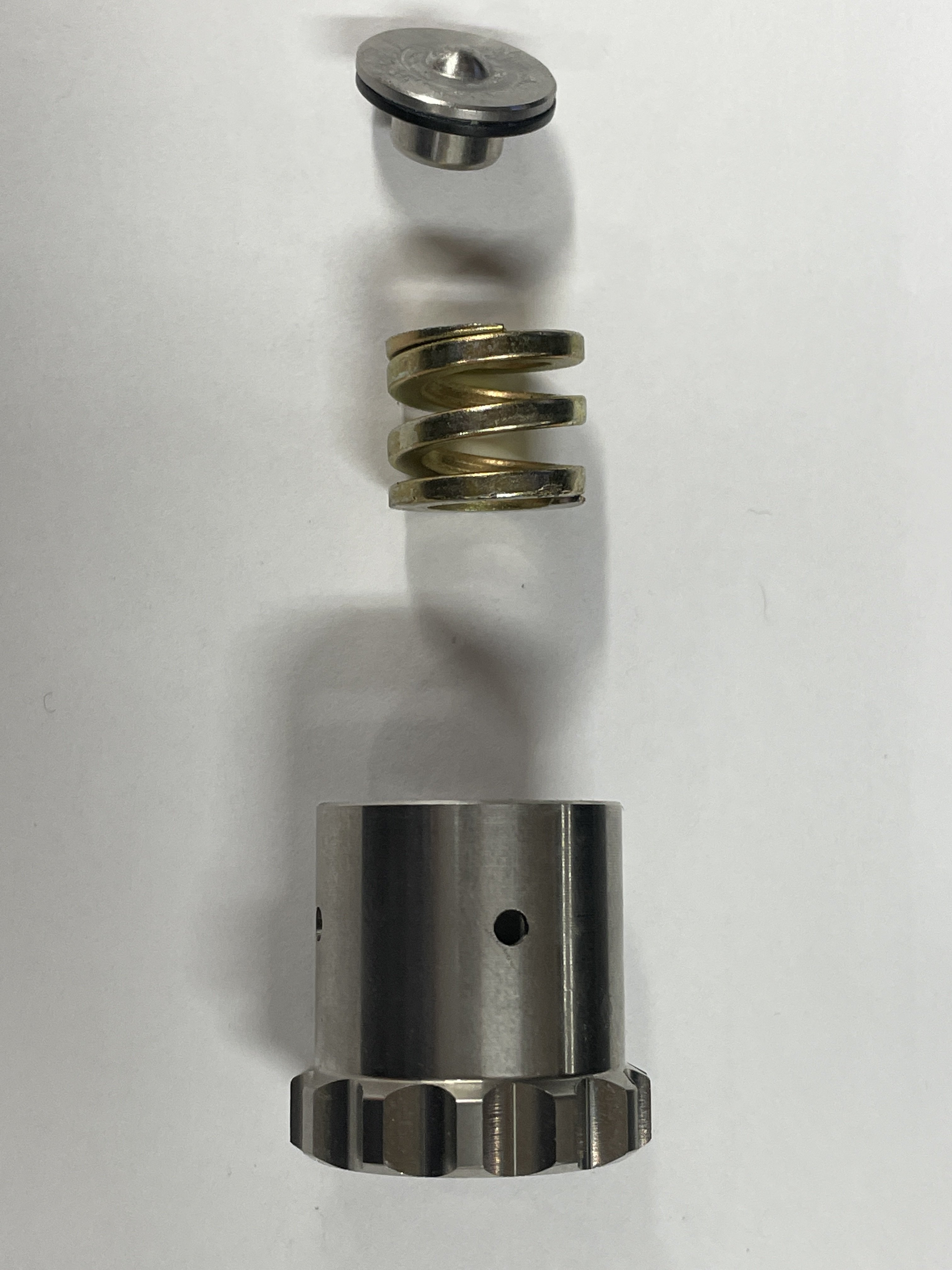

HPR
LPR

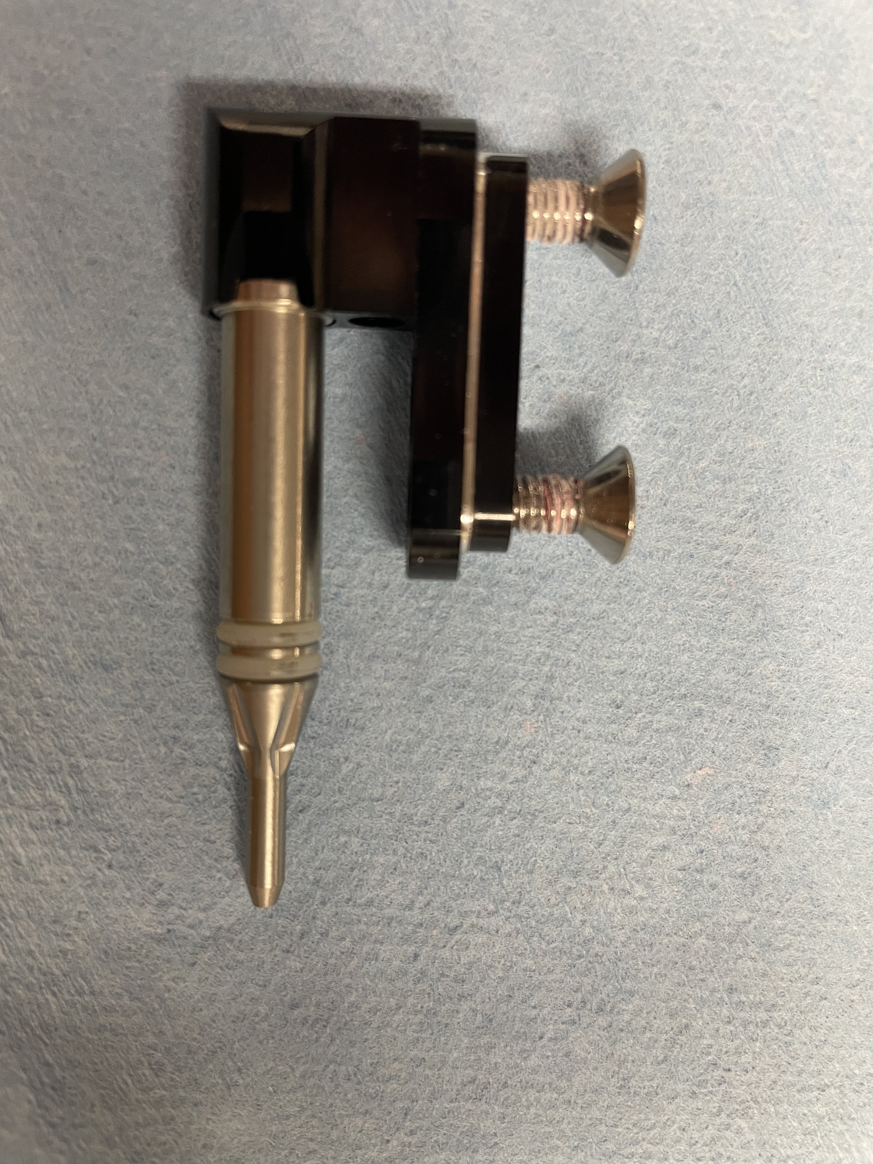

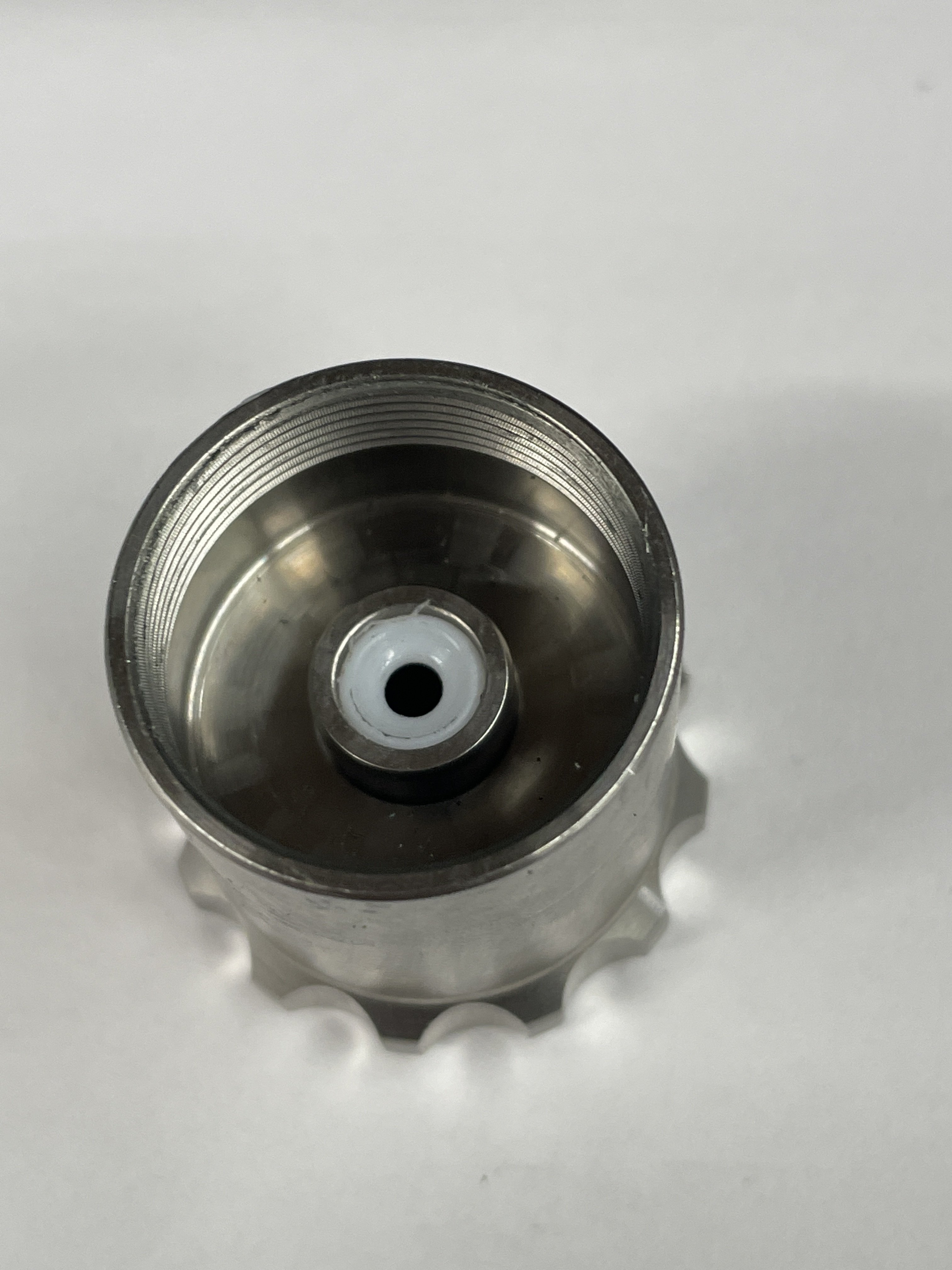

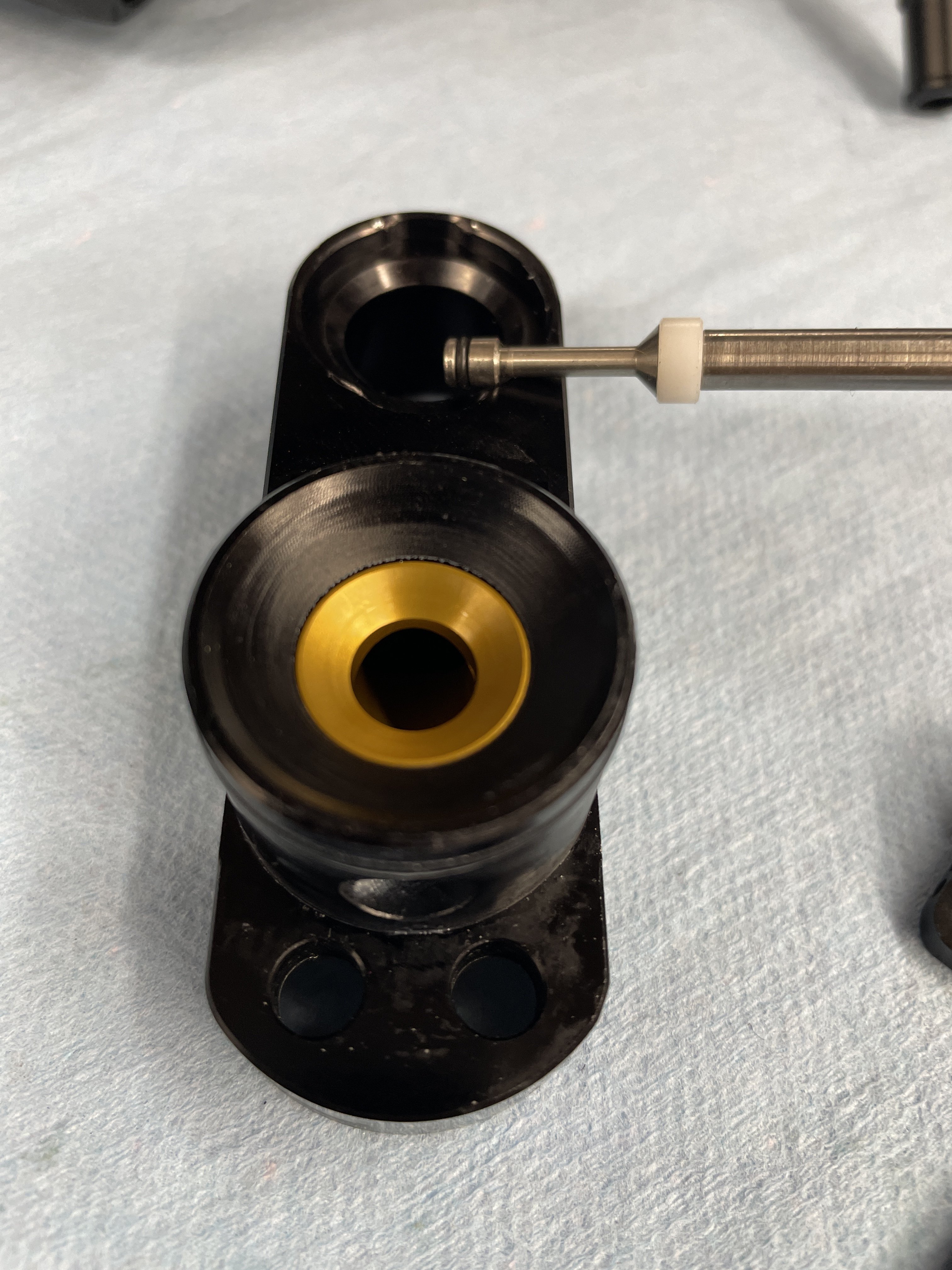

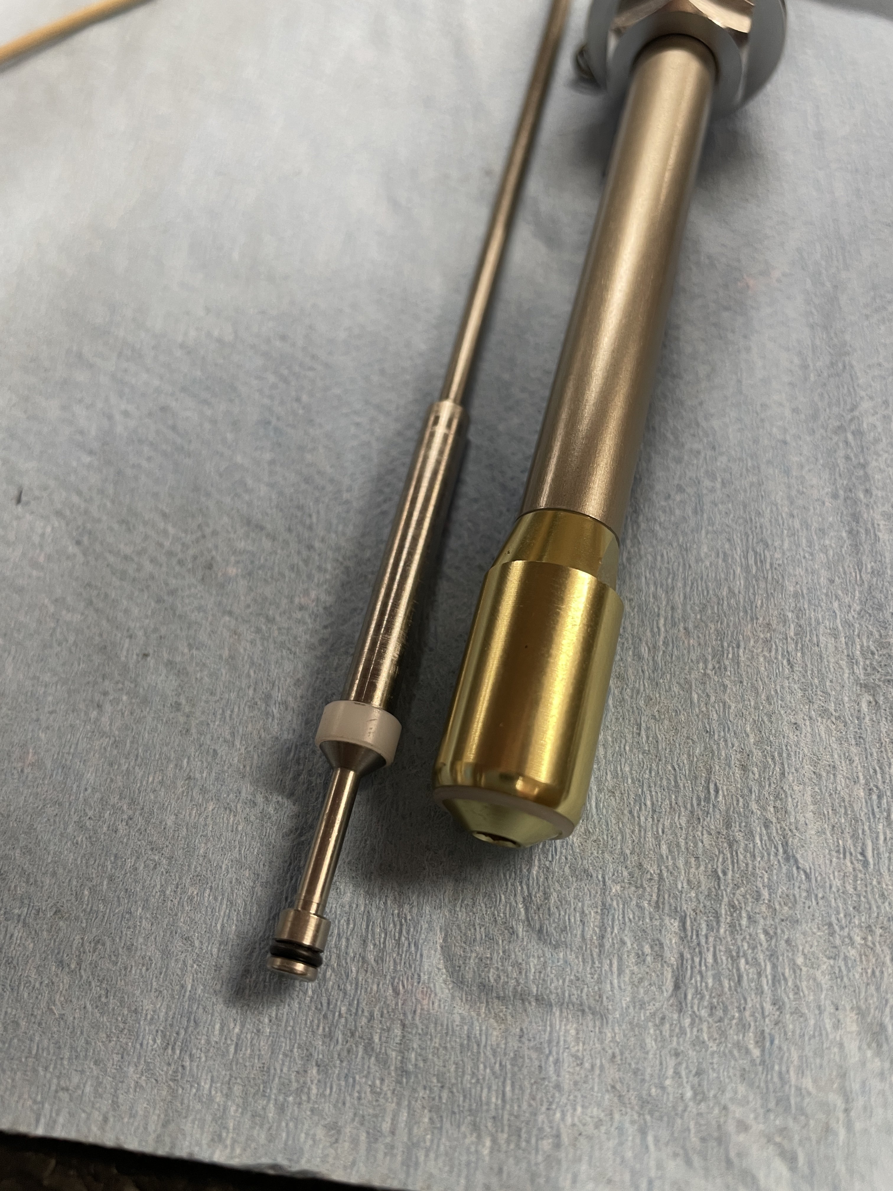

Robust pin probe with the seals on the pin instead of inside the barrel!

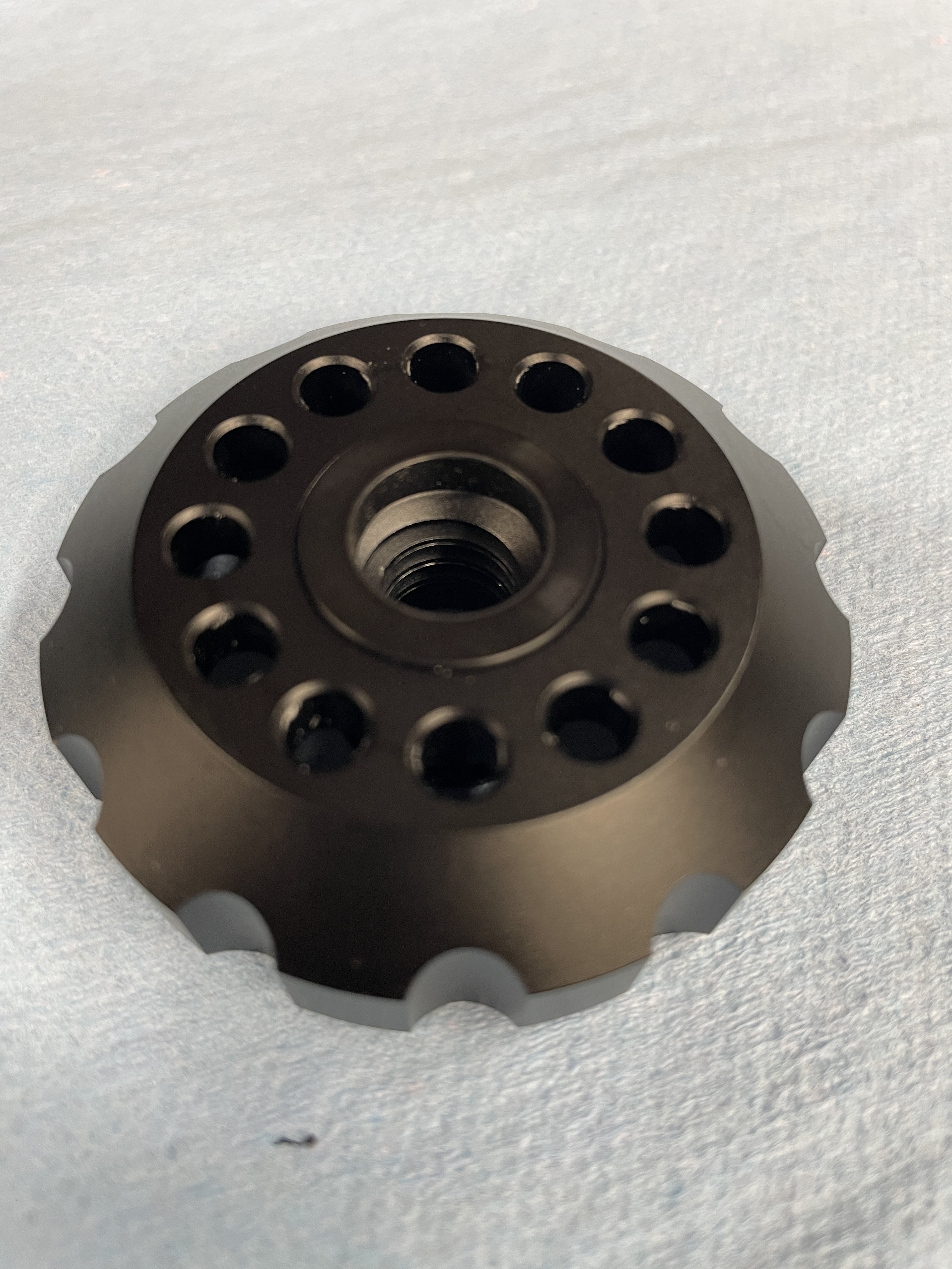

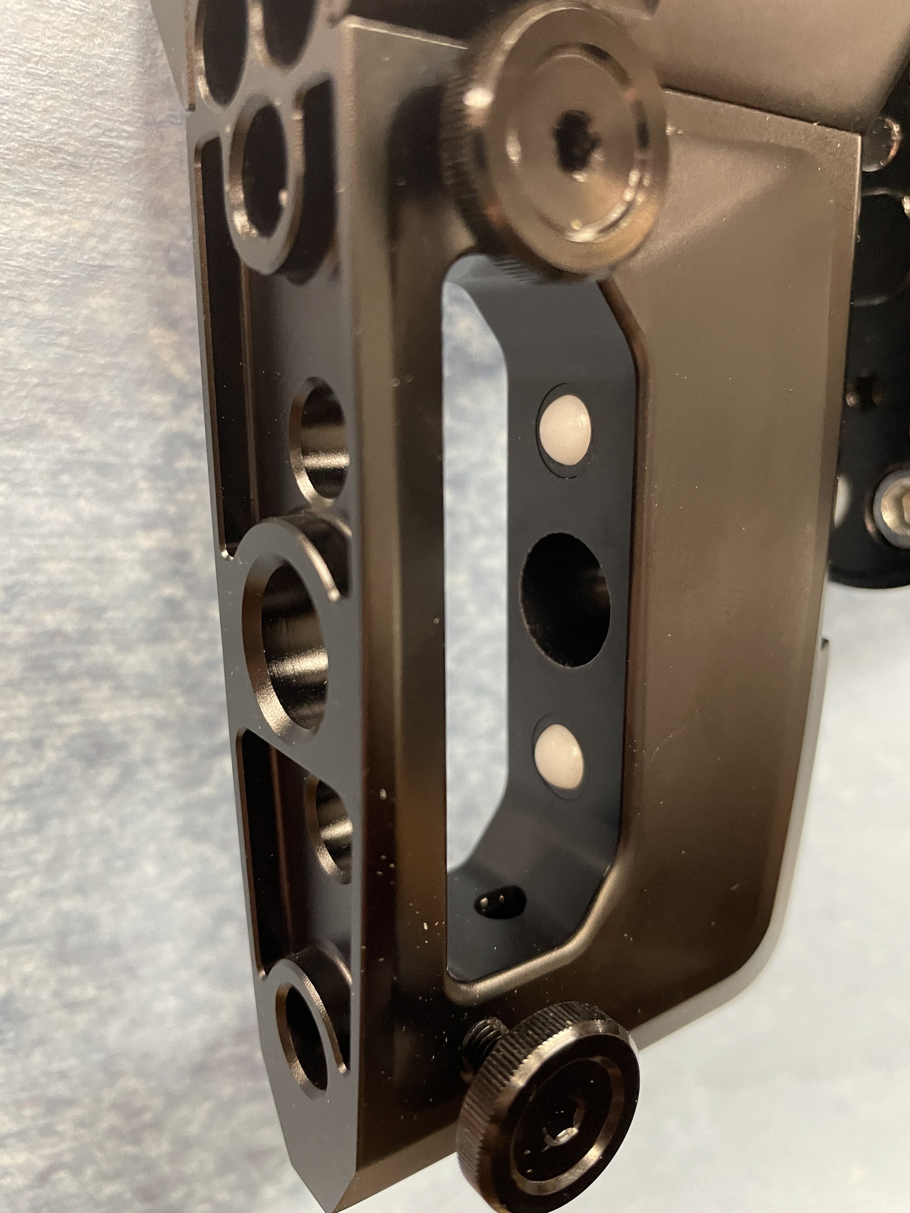

But plate adjustments all have captured ball detents.

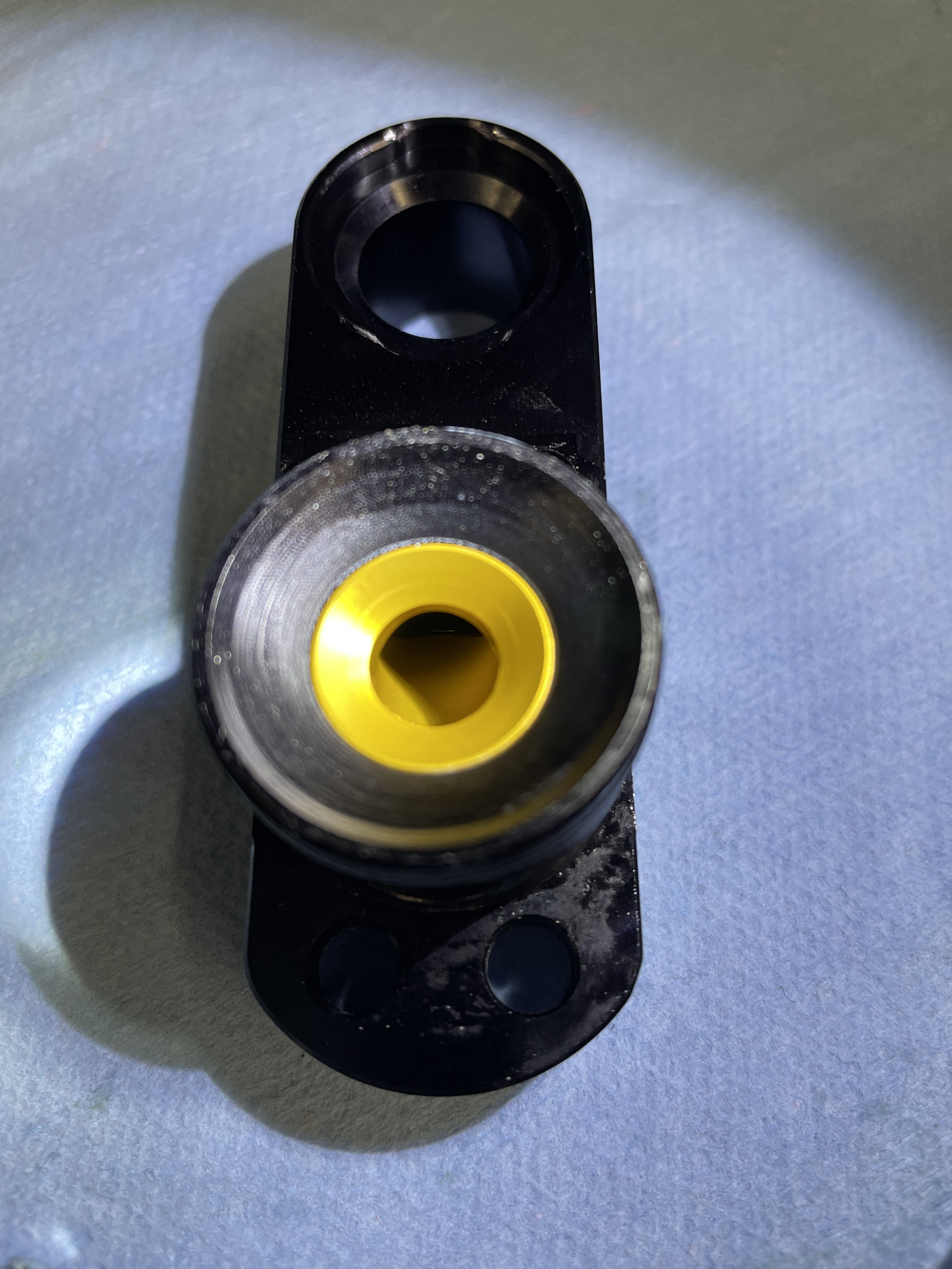

The valve dwarfs the one from my Impact.
The air passage is angled nicely.

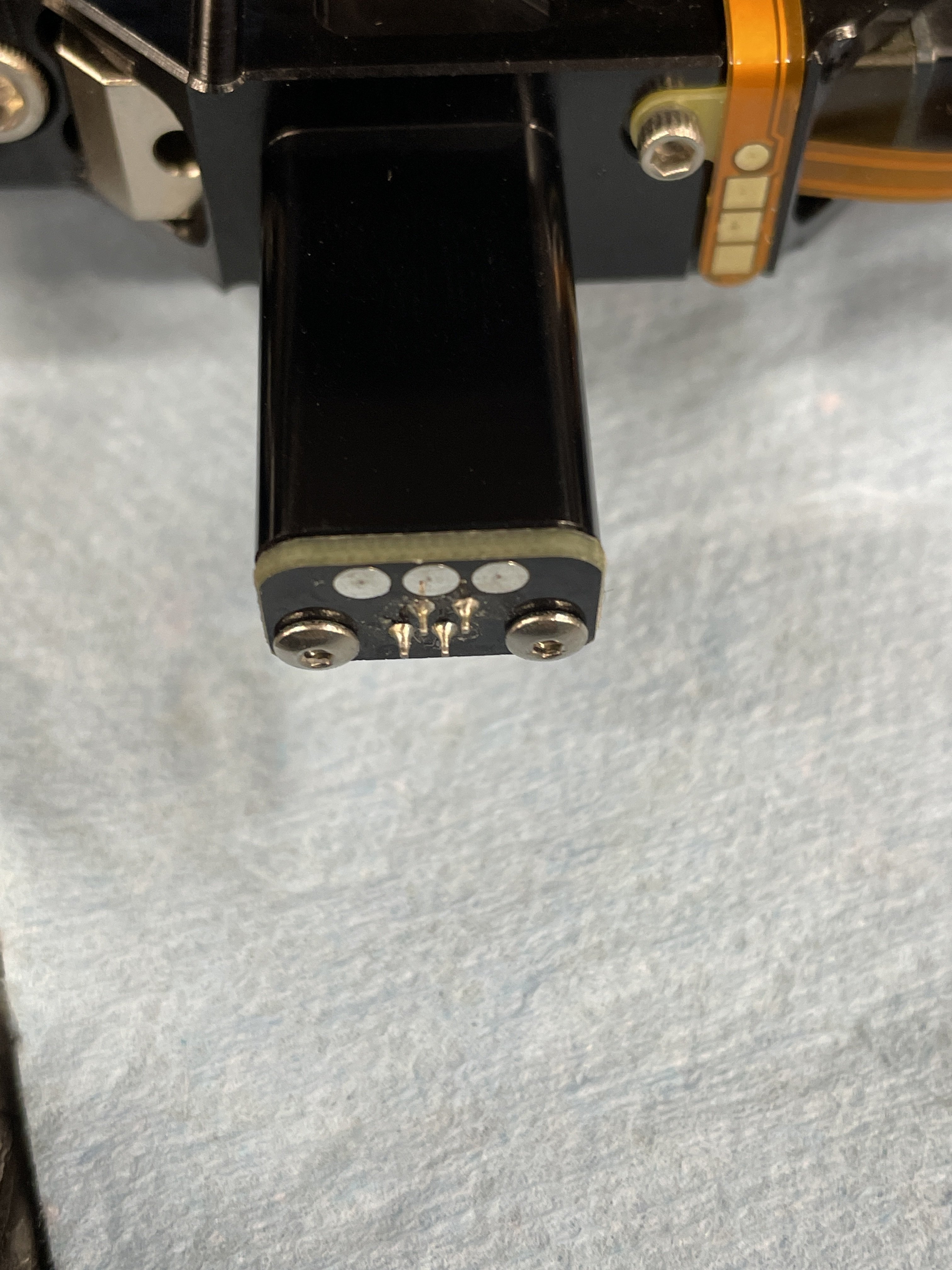

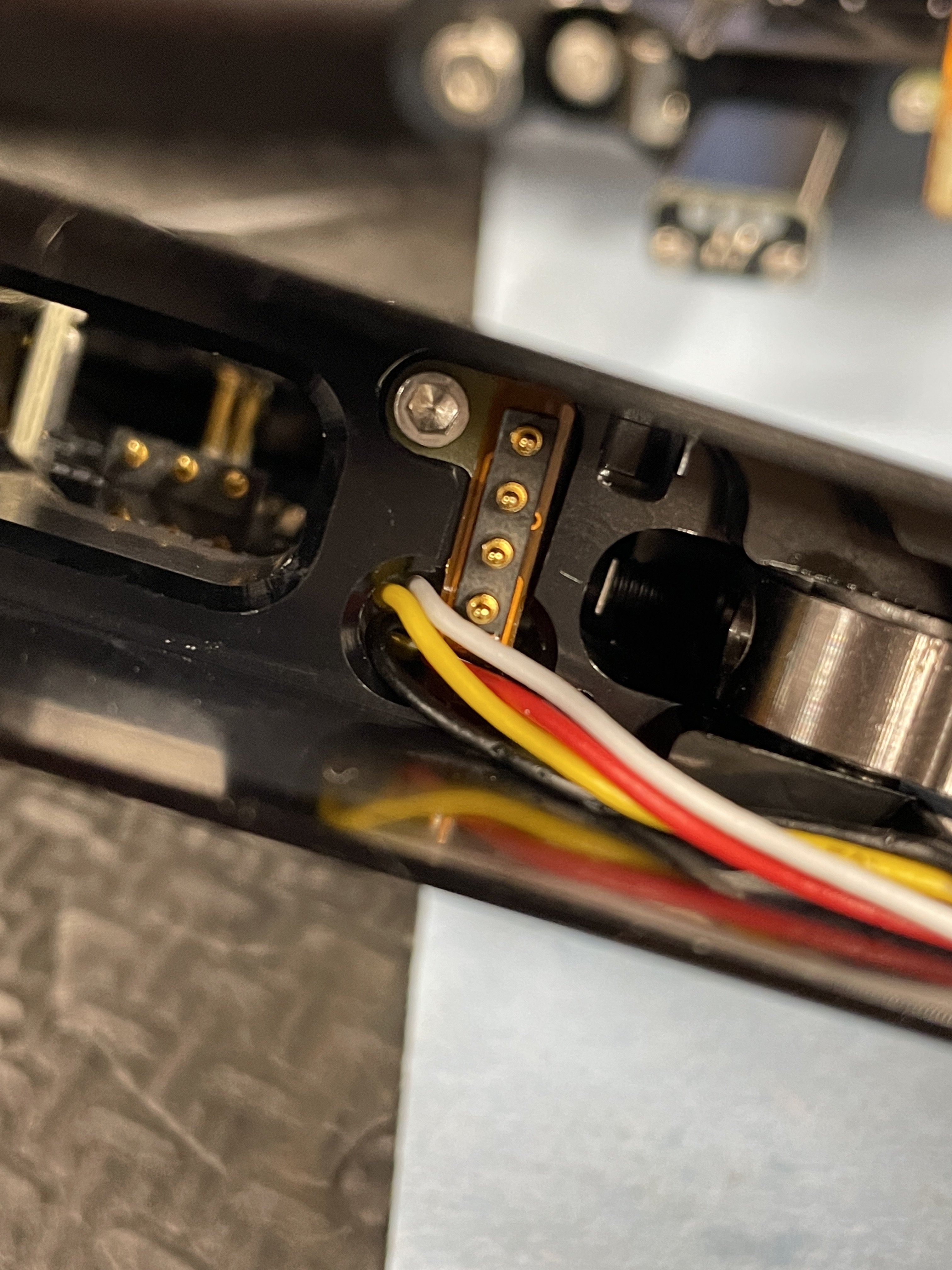

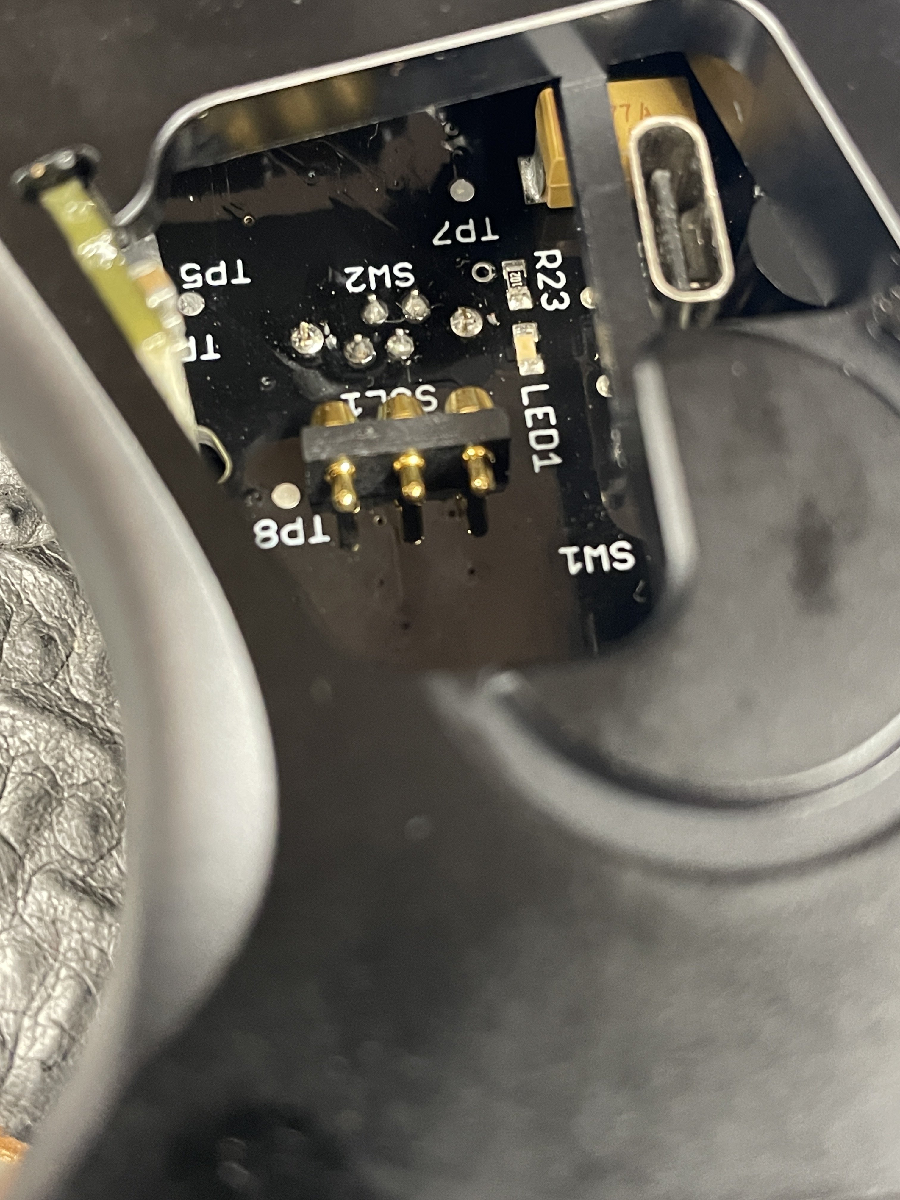

All the electrical contacts are pogo pins at detachable points.

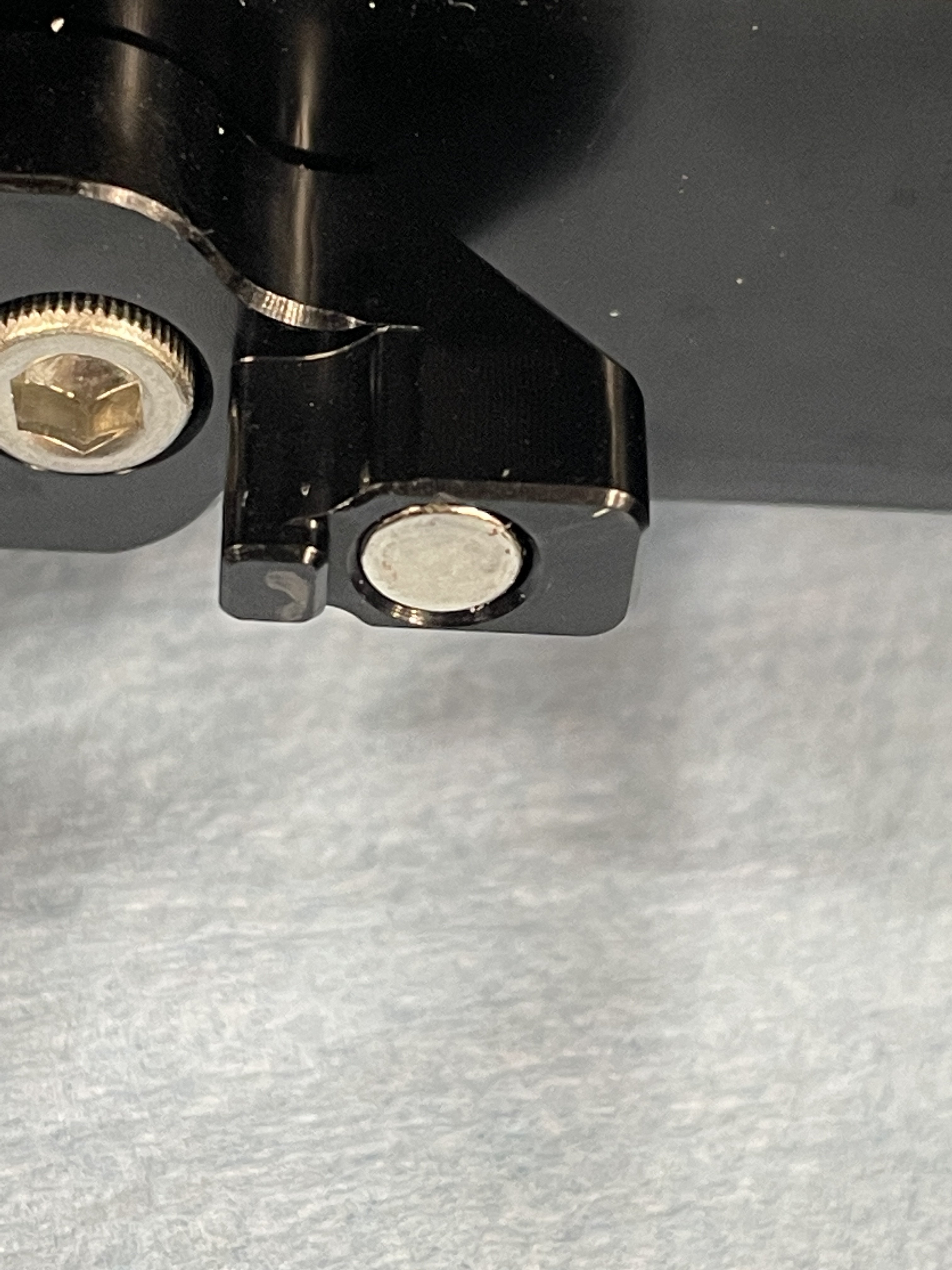

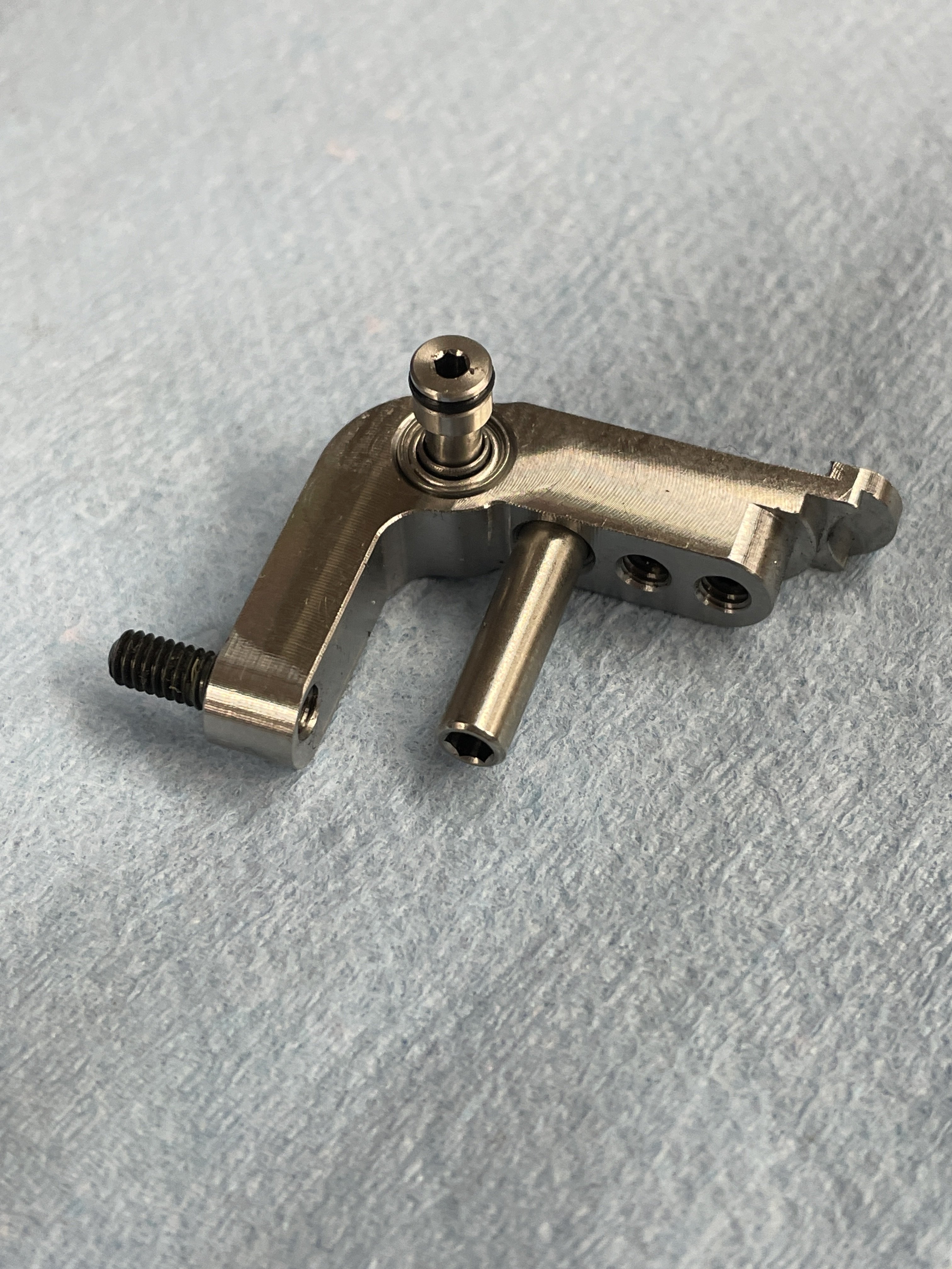

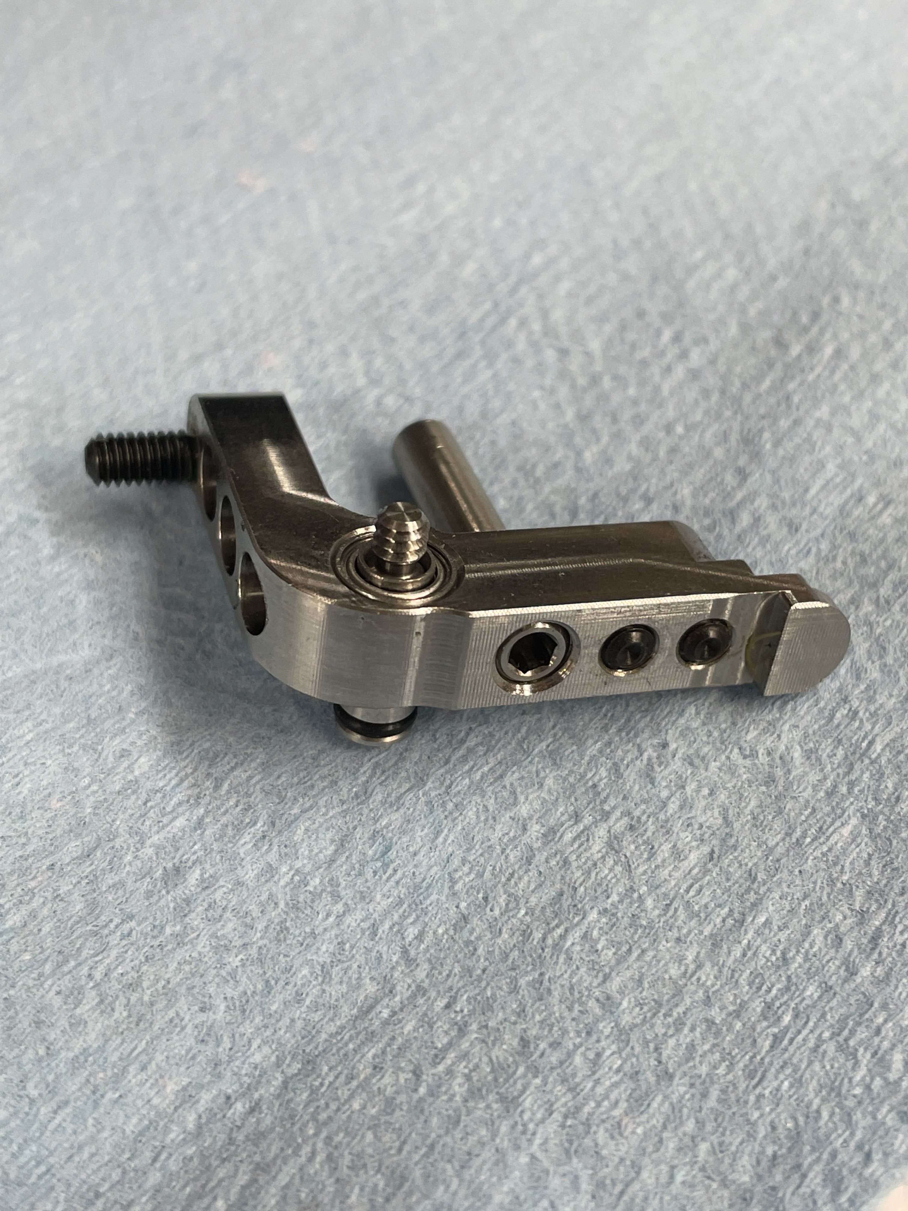

The trigger rides on bearings and uses an adjustable magnet as a return spring. I set mine to a 5 oz pull with almost no post travel LOVE IT!
Only broken down to the basic components. All in all, very impressive.

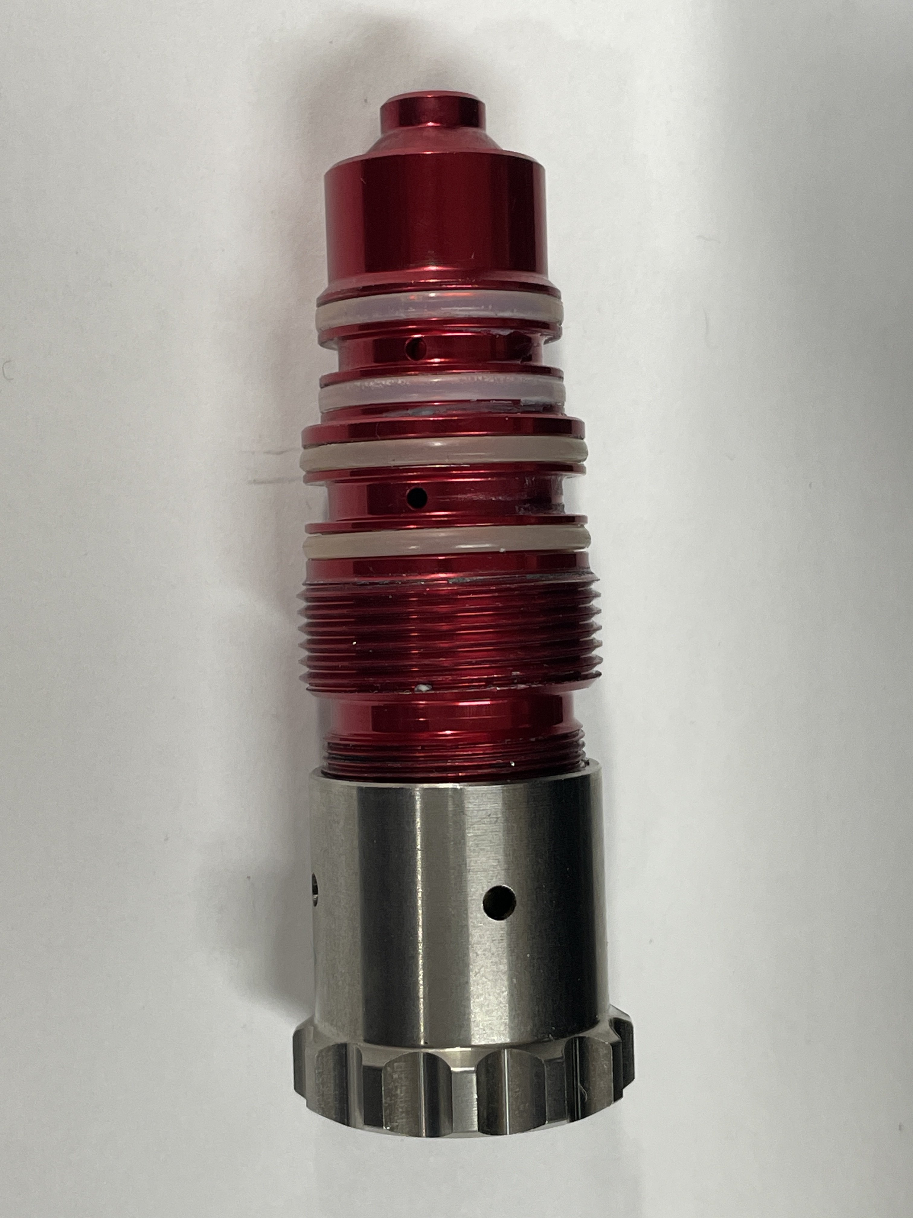

A thought had early on, that is showing to be true and may not be ideal for every location ?
Polyurethane O-rings
While there the toughest of all the materials, there one of the worst to take a shape set having poor shape retention elasticity.
In DYNAMIC locations absolutely, Static locations far better served with a Buna/N IMO :rolleyes:
Looking at above pics, one can already detect flat siding of some and pressure side shape shift on others.
This has NOTHING to do with the design or engineering ... Just that they have chosen to use pretty white / opaque Poly o-rings threw out that IMO are not the ideal choice for many of the locations.

Their use of non Buna material derives from their 30+ years experience with paintball markers. Spool valve designs tend to eat orings and they prefer the higher durometer materials. It's not uncommon for a typical tournament player to shoot over 20,000 balls on a weekend. With that many cycles Buna don't last ....
A spool valve ( Cyclic loading plunger ) paintball type has a lot more DYNAMIC & Long stroke positions to seal than the valve shown in there PCP ... FYI
No need to explain, I've got 20 plus years on the National Paintball circuit, besides being a competitor, I've repaired and serviced thousands of Paintball markers.
It is not a paintball marker ... MFG states poppet travel or SPOOL is something like .050" .... a paintball marker spool closer to 3/4" .. HUGE difference.
Along with some NOT READING that dynamic locations are best served by poly and not what was the bulk of original statement made, that of static locations. :cautious:
yep it doesn't shoot .68 caliber gelatin capsules at consistent 300fps. Length of travel and size of valve operation has little to do with their choice of oring material. They want to ensure reliability and hope their buyer appreciate going an extra mile for the 3k they're asking.

Well as a service mechanic for near 50 years now, we'll leave our educated opinion as it best suits us. :rolleyes:

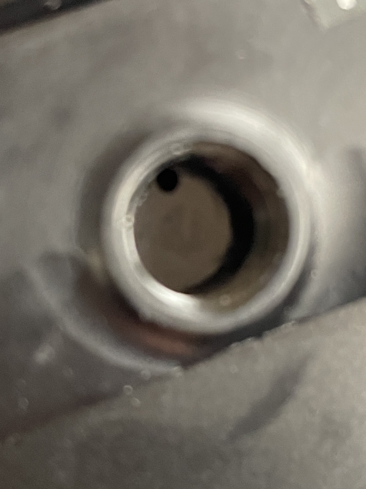

I would like you to measure the plenum in the Epoch, what is the diameter of the valve neck and what is the area of the air inlet to the barrel?
Because the valve rod is in the plenum it would require filling with liquid and measuring to get an accurate measurement of the plenum. there may be better methods but that's what I would try. Similar to combustion chamber measurement. This might be a question for Skout. The area of the inlet to the barrel will be limited by the transfer port on the barrel itself. I can check the orifice size next time I have the barrel out.
