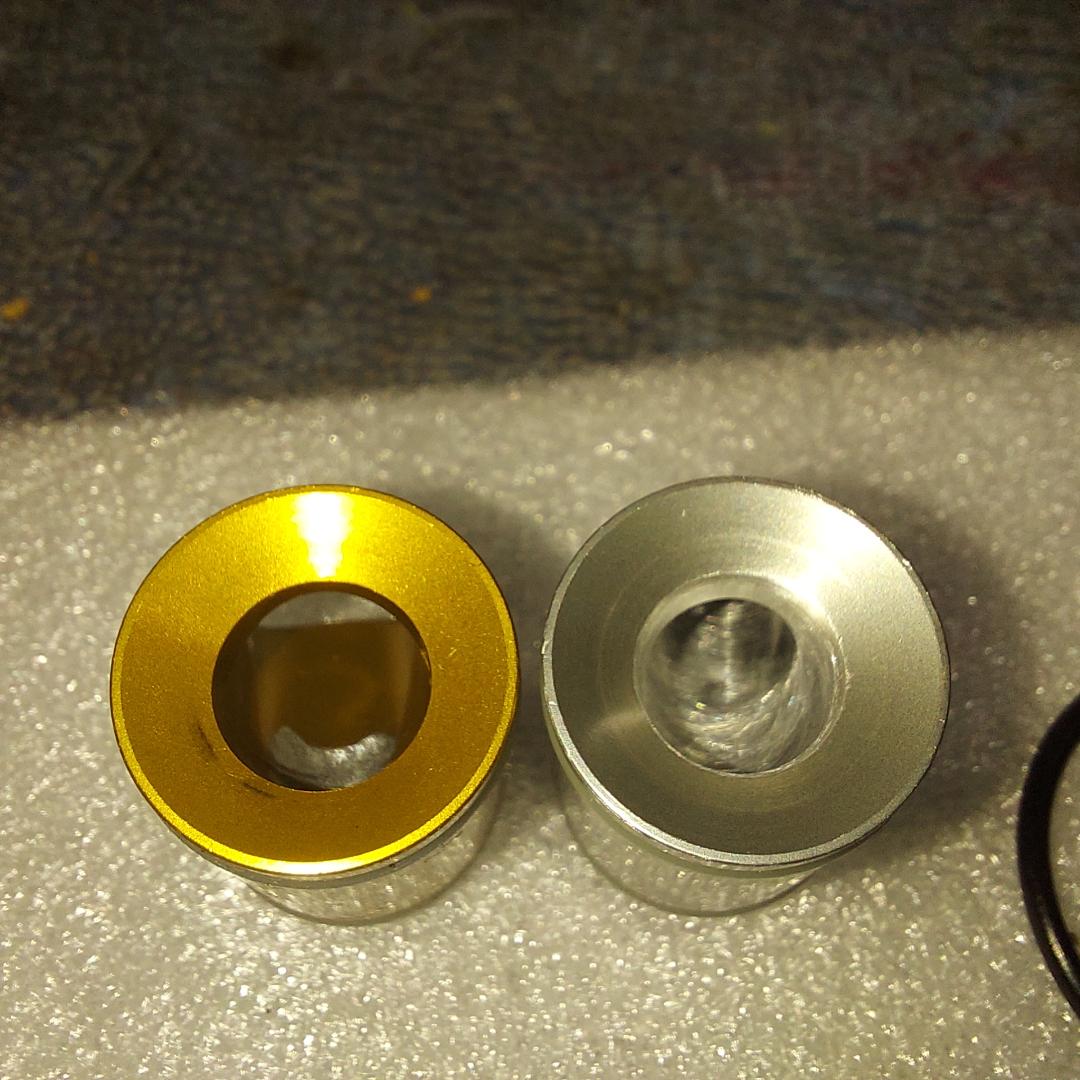

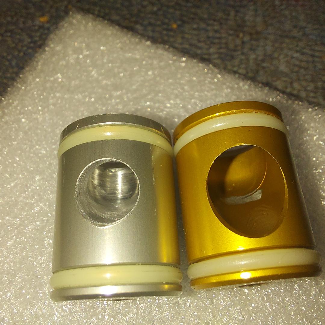

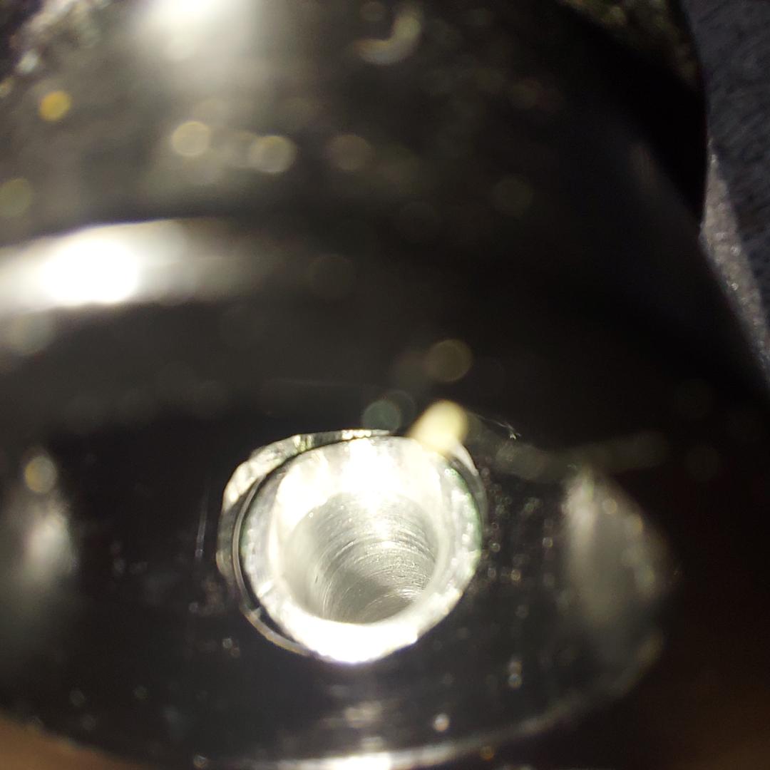

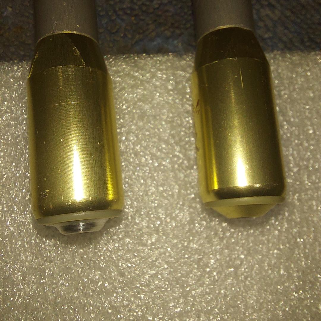

Ok it has been a bit having the EPOCH running as a .22 cal.
Early on this spring I had done some valving modification that catered to gaining some efficiency while running as a .30 cal.
Those changes lightly outlined below:
Heavier spool return spring ...
.002" Larger vent hole in poppet head ...
Tapered transfer path in Seat/Barrel manifold taking the .350" down to @ .250" at exit.
Cleaned up bridge on barrel thimble.
Now permanently running as a .22 cal have decided to go back in and re-calibrate most of it with similar mods tho smaller in area / size etc better suited to the caliber.
Those changes are outlined below & shared in pictures added to this post 🥰
Took out the HUGE poppet seat ( .350" throat & transfer ) replacing with a modified one of much smaller size NOW seat is @ .312" throat and transfer @ .280".
Tapered Transfer tube pulled out and another one made being .280" to .217" at exit. * So we're running at 100% bore diameter and nothing more.
* Poppet head got a small radius undercut to relief the tight clearance inboard of the sealing o-ring increasing flow a tad bit.
Jet hole at .039" being .004" larger than OEM spec.
Had previously cleaned up bridge on barrel thimble.
Testing data pending as I get it sorted :rolleyes:
Few weeks ago took poppet jet to .041"
Heavier spring closing poppet / spool
Kept electronic dwell at #25 setting
Smaller poppet seat ( Silver one )
Newest tapered transfer tube .280"/.217"
25" barrel in .22 caliber
Reg/s ... HP @ 1500 to 1800 psi & LP @ 125-140 psi
Shoots and operates IMO the best it ever has .. simply awesome !!!
quiet & snappy with far less muzzle jump ( less air blast from reduced valve dwell is key to this )
** AGAIN these are NOT required modifications to make ... I'm a R&D guy & Tuner and as such always tinker in search of improved operation beyond the OEM "Works for all calibers" state of tune / set up that production PCP's generally use these days.
