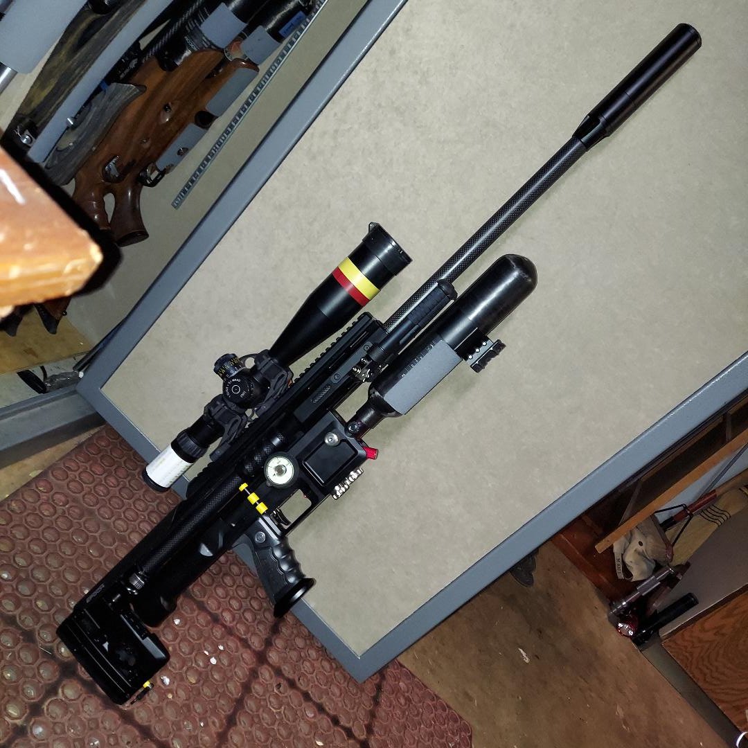

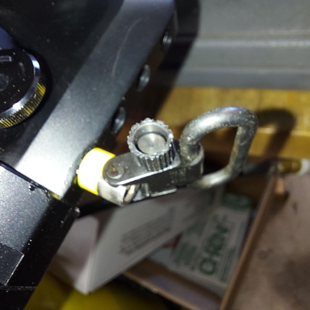

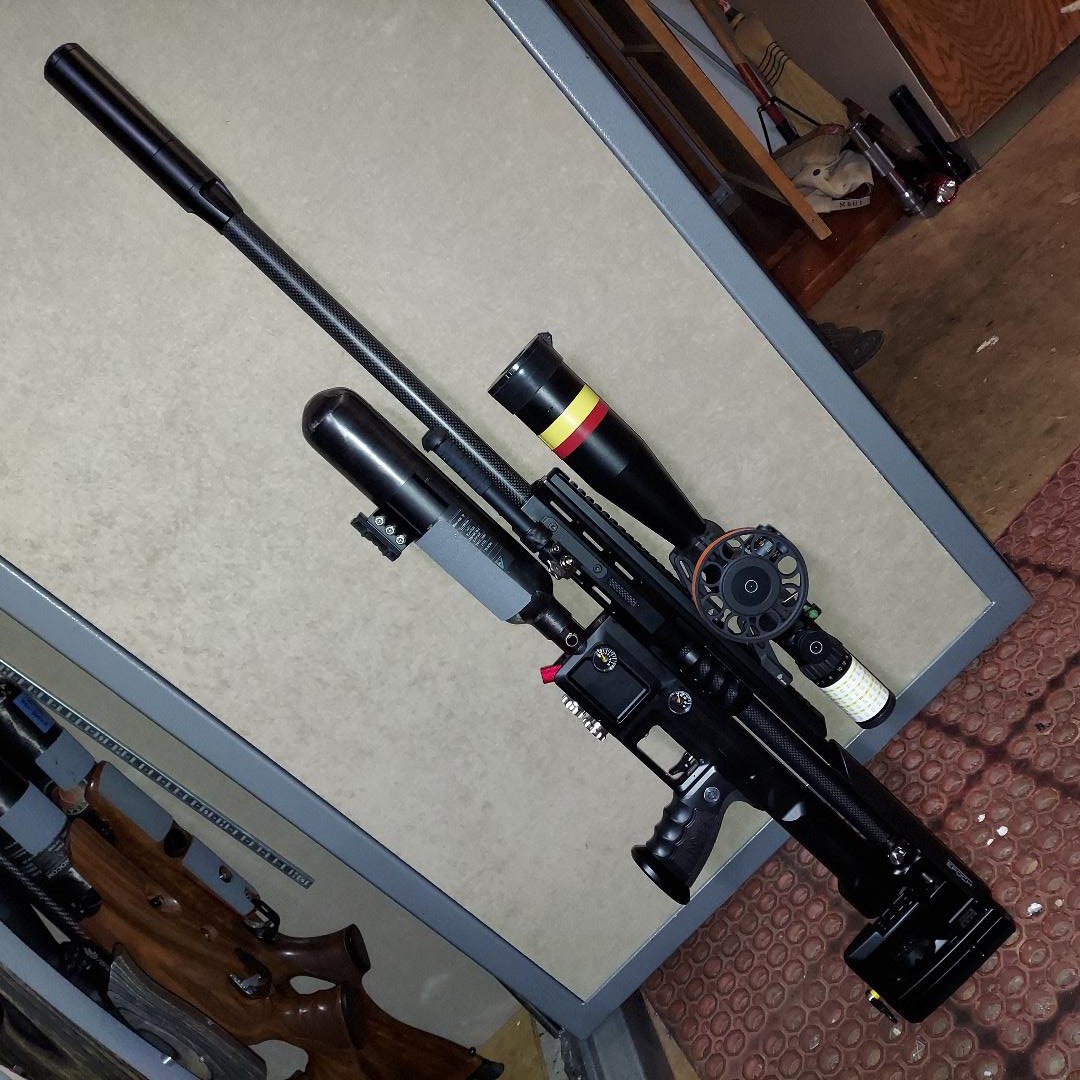

We have the Carry Sling situation figured out. Have a sling stud adapter for the bottle clamp Pic rail on order & made one at the rear.
* There are four drilled and tapped 1/4-20 holes on bottom of butt area. Using a SS cap screw, drilled a cross hole, flattened both sides and a Uncle Mikes sling swivel snaps right on.
