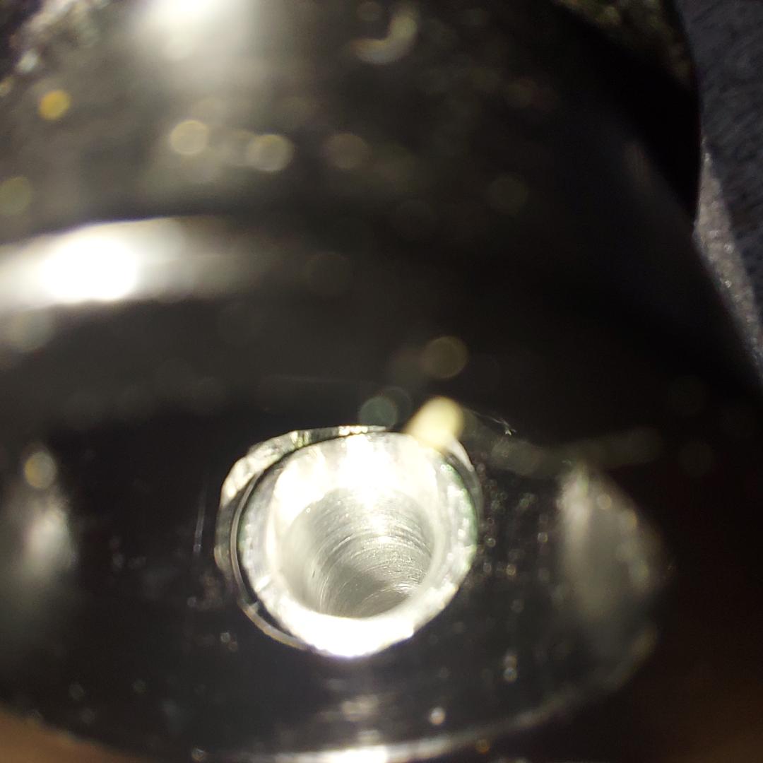

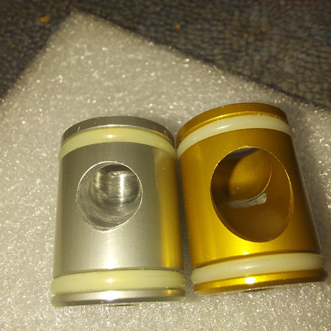

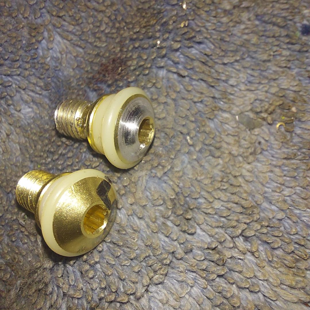

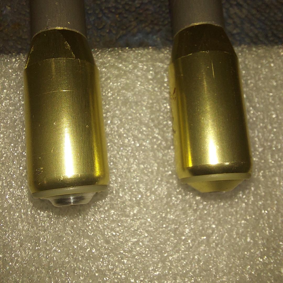

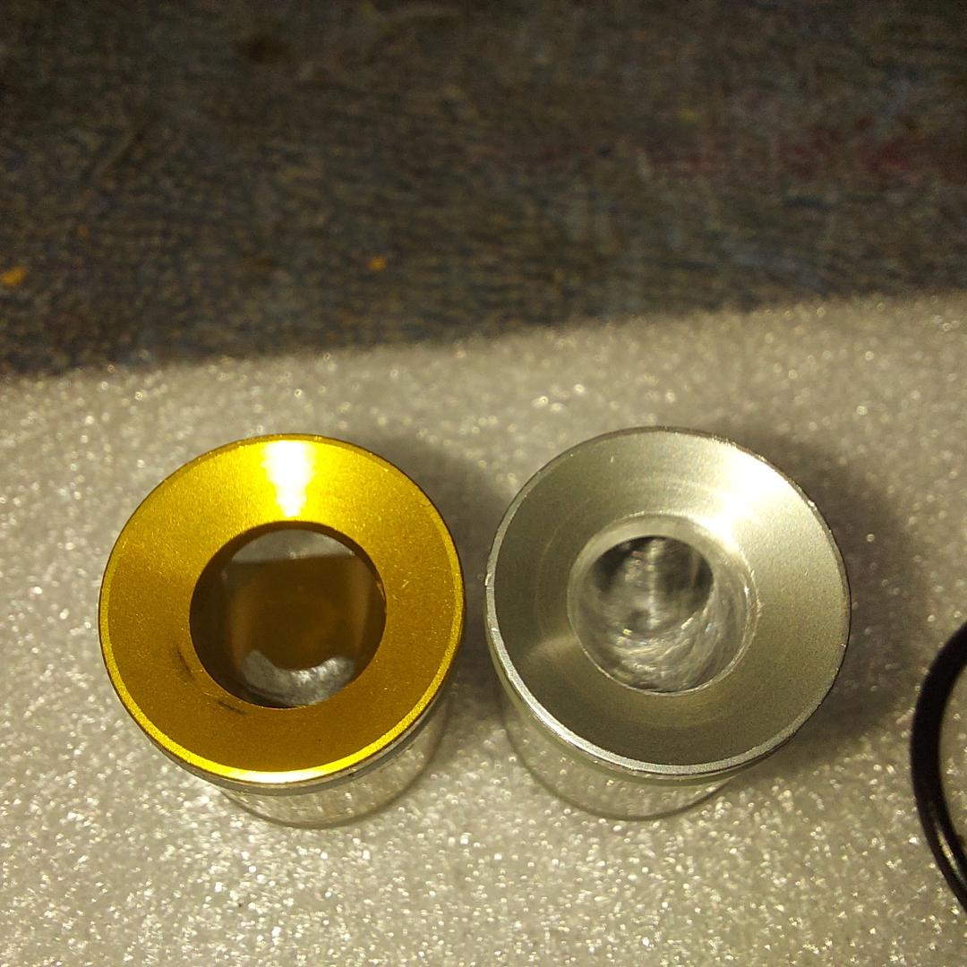

My EPOCH came as a .30 cal and utilized a Massive @ .340" throat poppet seat.
*My intent all along was to one day convert to .22 caliber, which was finally done this past spring.
I had been playing with transfer path restriction ( Tapered ) passing threw that back block/manifold, and was able to get a smaller seat that as I recall was @ 1/4" or tad above 6mm.
* The tapered transfer path tube is still in place and seat along with the path to its edge opened up to @ .280" which was ideal for a high output .22 set up ... IMO
Now the UK liability on output is yours alone to bear ... having a LATHE and a Mill or vised drill press, should be able to modify seat to what ever size you wish ???
As too the VENT size on end of poppet, as I recall the oem size was @ .050" and have increased it to @ .053" to cut the pressure force closure dwell down a tad.

Although this is a brand-new gun I have little faith in most dealers for warranty repairs so will probably end up doing some modifications, looking at you pics it looks like the valve seats/TP are available separately? (don't know about UK though) but I suspect it may end up enlarged slightly as this alone is going to affect just how the high pressure reg and dwell effect the velocity and its control, thanks for the insight. (y)
