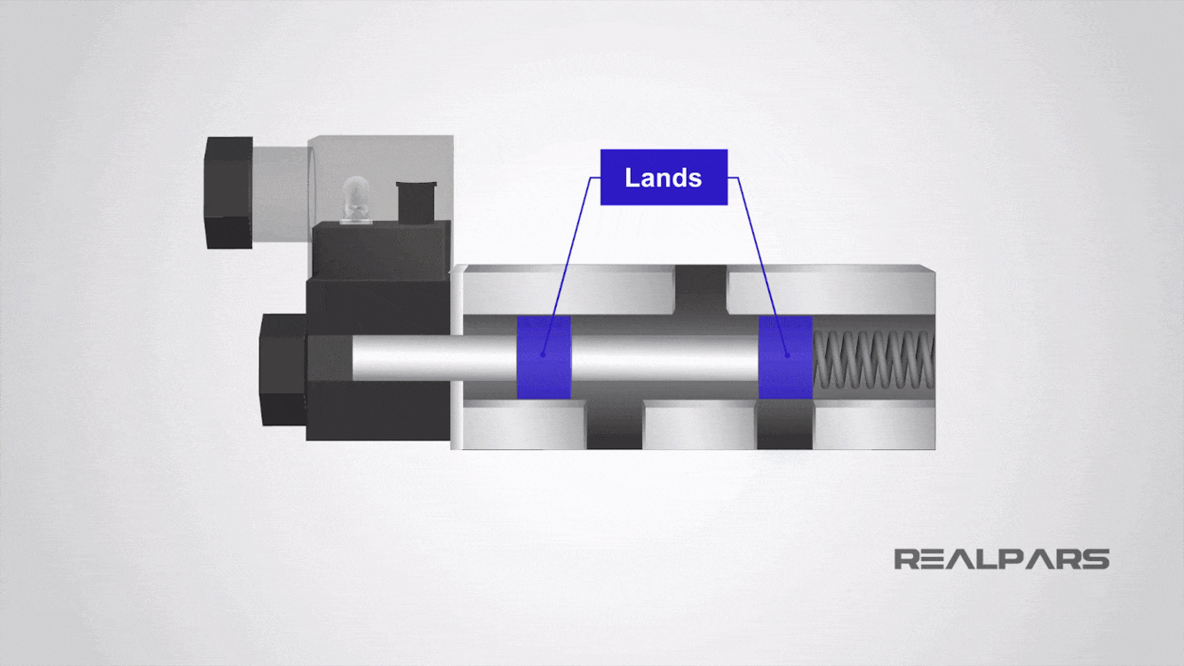

Also @AirShootist - am I right in understanding a spool valve is better than a poppet valve due to the direction of force to push the valve into an open state. The spool moves laterally against the pressure where the poppet valve is pushed against the pressure…? Still early in my understanding of the mechanics. Thank you
(Basing my question off this)

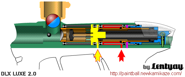

Anyway, on your question about spool valves - are they better than poppet valves? Yes and no. You can have an exquisitely tuned/sprung poppet system that is super efficient and consistent. You can also have a well-tuned spoolie that runs great and is super consistent & efficient. In general, poppets are known to be more efficient, but that is changing as spools get better and better. Like I said my GMek (spoolie, Gamma Core) will shoot more pods of paint than my Autococker (poppet). Lower operating pressure helps with that. My GMek is far more efficient than my cocker.
I'm gonna give you guys a BIG rabbit hole to go down. Check out www.ZDSPB.com (Thanks, Andy!). This is a website with TONS of technical drawings and animations of various paintball marker platforms. Literally days and days and days worth of info there. If you dig through some of that info, I think it will really help your understanding of spool valves vs poppet valves. Look into the tech sections.
Remember, a spool is a dynamic valve (like your graphic). Most spool valve PB guns run so low operating pressure that they don't require an LPR (low pressure reg). The Skout DOES use an LPR because it runs at way higher operating pressure (800 to maybe 1500 psi) but we only need like 100-125 to cycle the spool valve/bolt (or whatever it will be called in the Skout). So the DLX Luxe pb gun (made in same factory as the Skout) only uses 1 reg, an HPR (high pressure reg) because it operates at sub-150psi, so that same pressure can run the solenoid for bolt travel as well as to propel the paintball. It does not need an LPR to run the solenoid. Many electronic poppet valve guns use a LPR to run a solenoid to power a ram or rammer, which hits the valve. That way it doesn't need a hammer spring, it uses air.

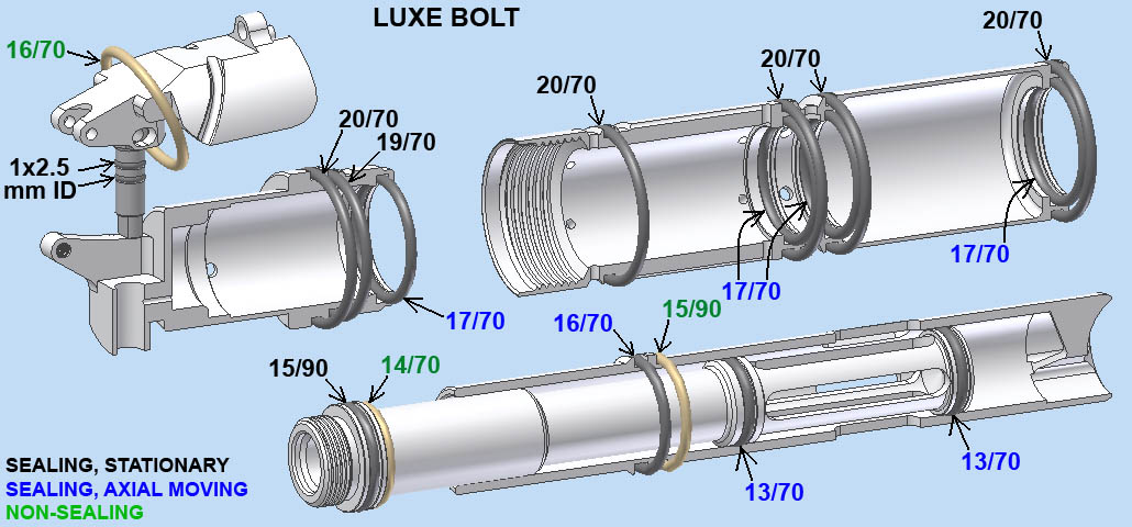

Here is a diagram of the DLX Luxe bolt I pulled from ZDSPB. Hopefully this is helpful. Definitely go check that website and dive into a rabbit hole, if that's your thing (it definitely is my thing...)

Also, I should have added to the "are spool valves better than poppet valves?" question that I answered above: 1 thing that is FOR SURE about spool valves is they are more technologically advanced than poppet valves and require much more advanced manufacturing, especially for machining ID oring grooves. You can plainly see the technological advancement (vs a poppet valve) in the above graphic.
here is the Luxe firing:
You can see the high pressure air (yellow) build up in the dump chamber and then you can see the solenoid cycling air to the front or back of the bolt sail to move the bolt, which dumps the dump chamber pressure down the barrel once it gets to the point of breaking that seal.
Technically there are 2 spool valves in the Luxe, the bolt engine itself and then also the small electronic solenoid (not pictured here) is also considered a spool valve.
