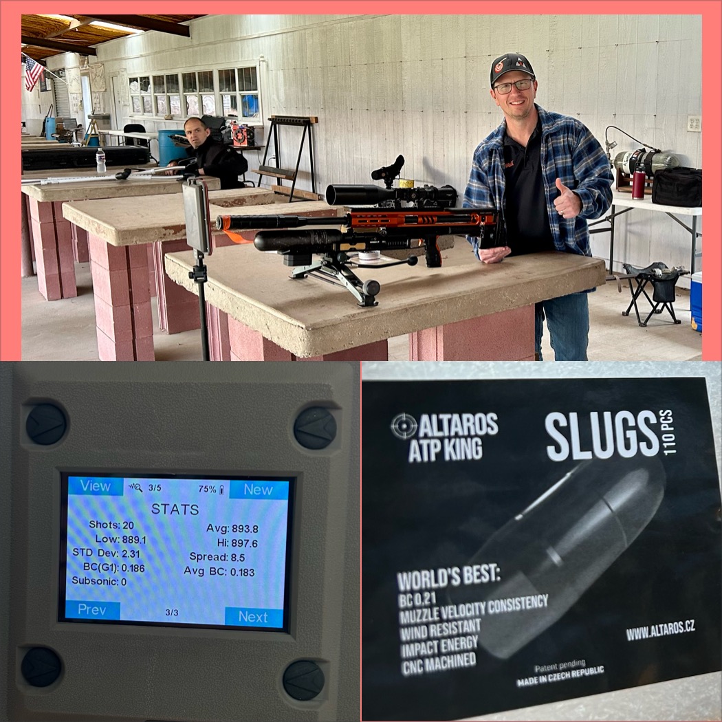

When I saw those results from the slug shots, i knew i had to try it.
I had purchased some of the Altaros Kings a while back, but slugs gave me a headache trying to figure them out
initially, i had some problems getting to pressure to shot the Kings at speed. I thought it was a the spring in the HPR so i asked Skout for a larger spring.
But i didn't realize I had a blown o-ring in the little piston in the HPR.
With both of them installed, ayyaining the pressure was no problem, though i wonder why such a big difference on the hpr settings??
The lpr naturally jumped up as the hpr was raised and ended up at about 260
I shot these on a N50 card at 100yard indoor range at around 885-895 ..all shots are consecutive
Slugs had a HBN coating for lubrication ..a tiny amount of powder in a zip-lock bag and gently tumbled til coated.
This was incredible for me ...never had much luck with slugs until now

The Skout EVO and .22 Altaros 40gr slugs put me on top of the podium with a match high score of 37 of 40 for the Benchrest Silhouette win!! TexTreme Shooting Sports hosted this match in China Spring, TX. I managed to take 2nd in the Pellet class running the same rig in .30 shooting AEA 50.5s. It was a bit hectic changing calibers and tuning 4 times, alternating between setups for each relay but the EVO made it simple!
GZ on the Silhouettes !

i'm wondering what the other guy's expansion is conveying?
Mike
Thank you!
He’s got a Skout EVO as well. He’s shooting a 35” barrel kit with a TJ. I can imagine what he’s thinking. He’s probably thinking slugs need to be considered. Eric is an engineer so he’s contemplating for sure 🤔
Thank you!
question on the Chrono...do you use G1 for slugs and GA for pellets?
Thanks
Mike
