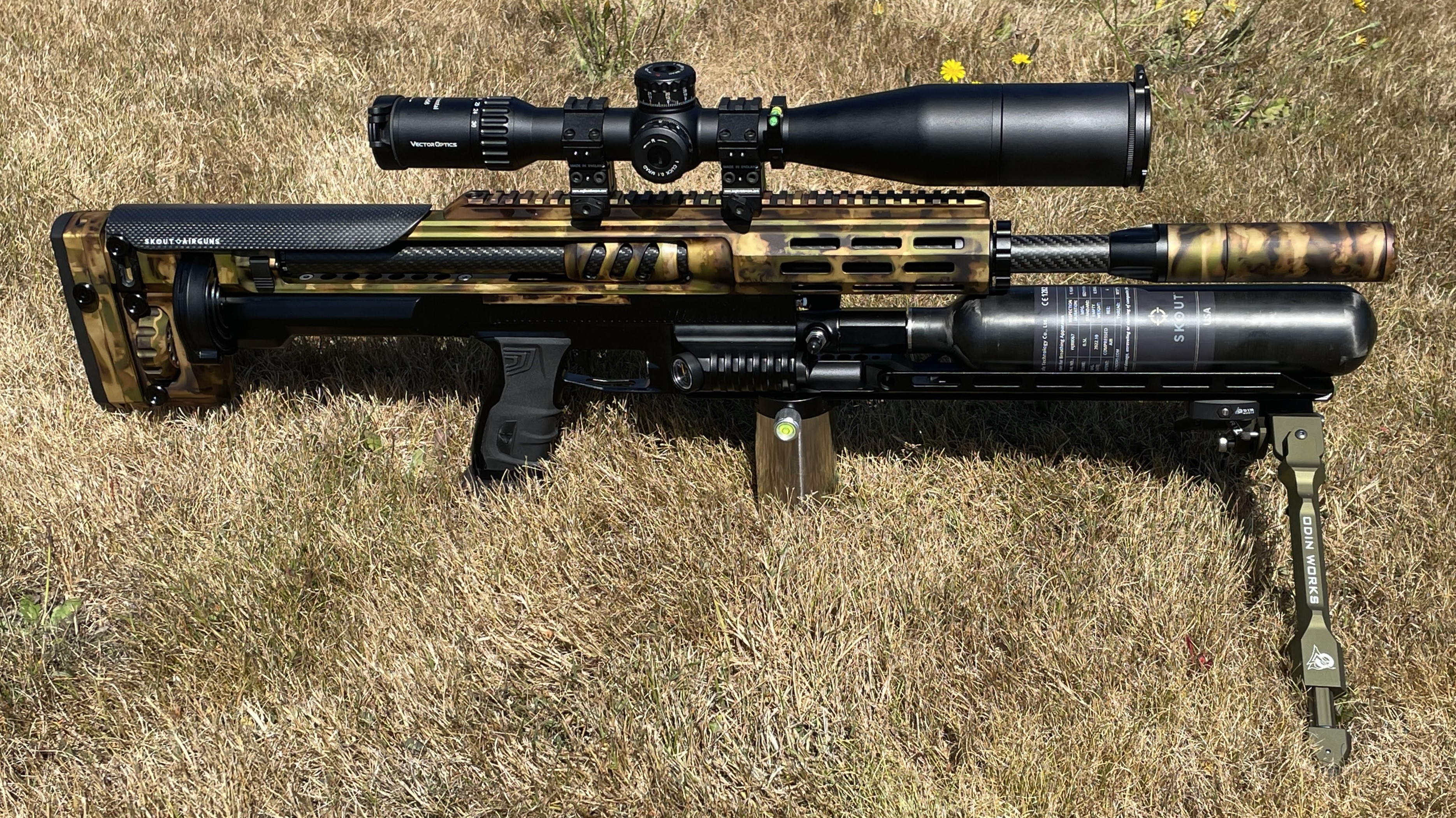

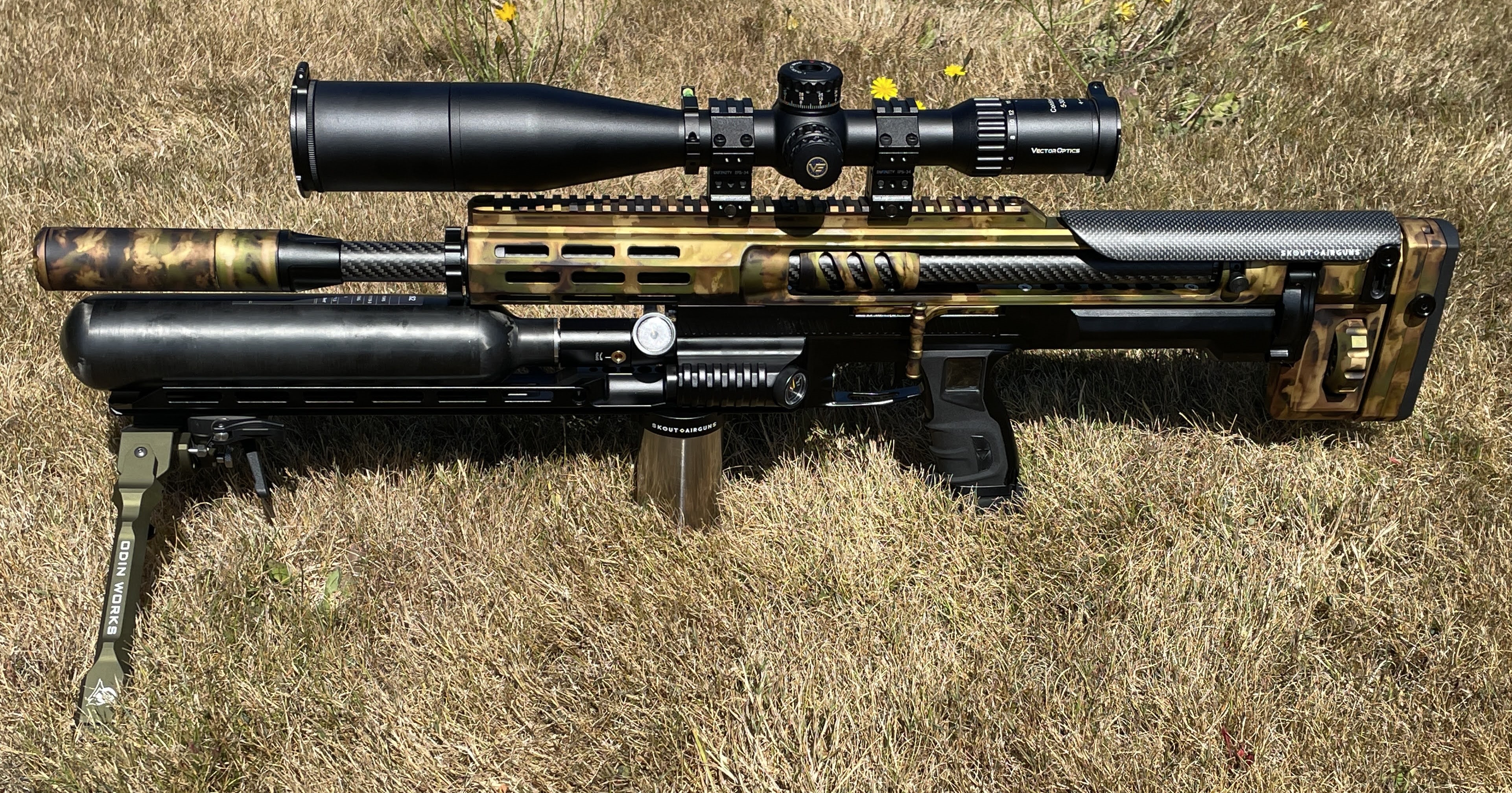

I just got my new Skout Evo. I couldn't be happier!
The new solid barrel system is very impressive. I opted for the .22 caliber Lothar Walther 25 inch poly 1:15.75 twist. This is a full typical LW barrel inside the 1" diameter carbon Skout housing with the entire remaining volume filled with CF and epoxy bonding. It is as solid as a baseball bat!

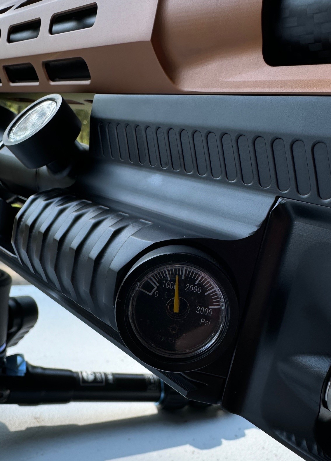

The new indexing is more intuitive, repeatable, and better executed than on any gun I have ever seen. I upgraded to the benchrest buttstock instead of the lightweight Evo setup because I prefer the additional adjustability and I am not looking to save any weight since it will mainly be shot from the bench. The electronics are improved from the Epoch and the larger screen is much appreciated. The trigger mechanism remains unchanged (which is a good thing). The on/off valve is better and both shuts off the bottle and degasses the gun with one twist. As a lefty, I did prefer the regulator gauge on the right side of the gun on the Epoch and I also preferred the tool less regulator adjustment. Although it never happened to me there was a risk in setting the bottom of the gun on a log or bag and bumping the reg adjuster by accident on the Epoch. The new design brings the reg adjustments up and in alignment with the gun lengthwise. Lastly I was able to get it in custom camo which I fell in love with on the very first Epoch prototype!
It is stabilized by an Odin Prizm bipod that is my new favorite even if they are fairly pricy. Atop sits a Vector Optics 5-30x56 Continental 34mm tube. The bad news is that I only took a couple of types of ammo to the range today and the wind prevented any critical analysis of groups at 100. The good news is what I saw so far is very promising! I can't wait till next Friday when I'll have another chance, and I'll get test more projectile options.

50 yards 5-shots group with JSB 25.39 gr pellet. Regulator set at 1,300PSI. Chrono at 858fps.

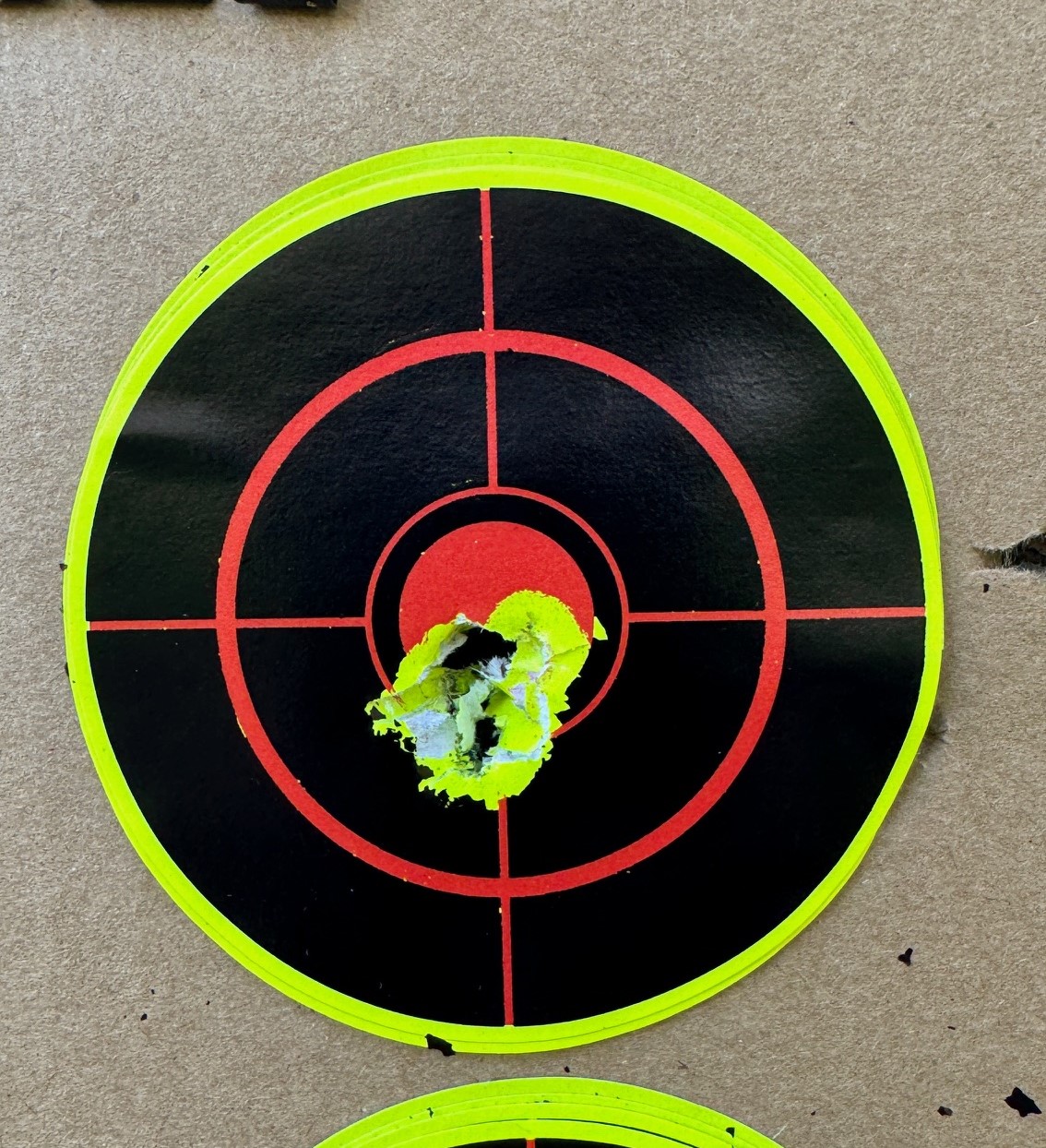

Today was the first day I had to see how it shot at a distance. This is a full mag dump at 100 Yards JTS .22 22.07 gr 930 fps. Please know I am not the best shooter, in the hands of a good shooter this would really tighten up. 30 shots

UPDATE:
I got to take it out today with the intention of testing pellets at 100 yards.
I have over 350 rounds of different types of ammo through it so far and have not yet cleaned or polished the barrel.
All testing so far has been out of the tin, no sorting, cleaning, or lube/wax.
The barrel showed a preference for the JTS 22.07.
970 FPS
High Pressure Regulator (HPR) 1500
Low Pressure Regulator (LPR) 150
Dwell was tried from 15 to 35. My best groups were at 19 but the differences were minimal and anecdotal at best.
In 5 to 8 MPH switching winds it printed group after group with 7 or 8 out of 10 under an inch. No attempt was made to hold for wind, just straight point at the bull and shoot. The flyers opened the groups up to 2-3 inch. These were all 10 shot groups and many of the 5 shot groups were better than MOA. Under these conditions I am VERY impressed indeed!
