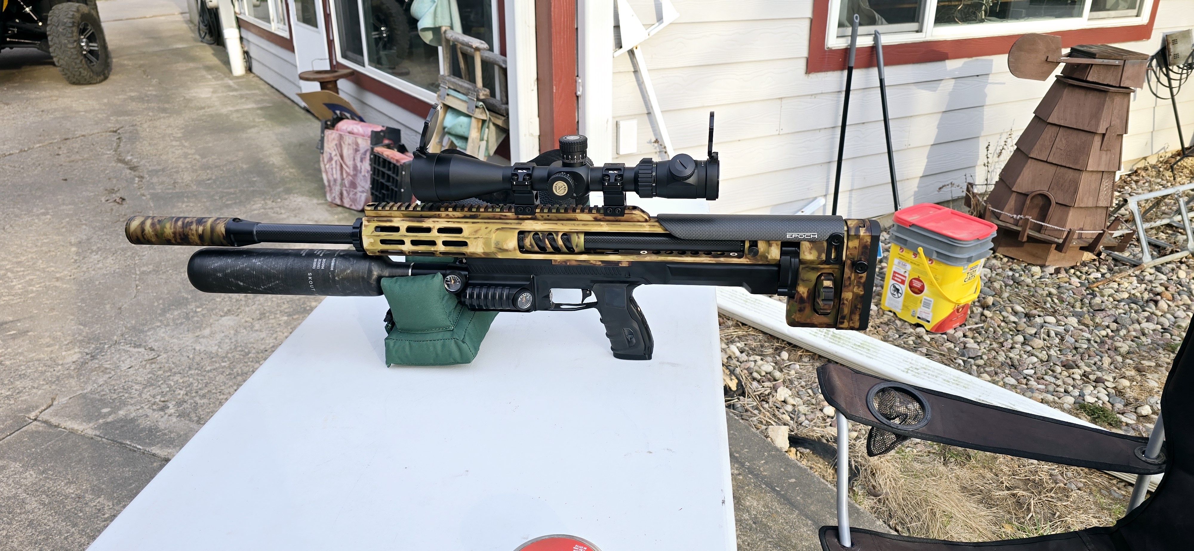

Lewis and others, thank you for the tuning suggestions - it is really helpful in getting my new Evo setup. Can anyone explain how the valving system works? Is the LP the equivalent of a hammer weight? What does the dwell do? I have my dwell set to 12 and it bumping it up really didn't seem to change my velocity (like on a RedWolf). I suspect that the dwell is only for the LP hammer, but not sure.
I was able to get one awesome group after replacing my fill port due to an issue. However, I was getting some flyers that I think are due to sharp edges on pellet probe. I polished the probe and will see how it performs tonight.
Thanks again,
Dan
