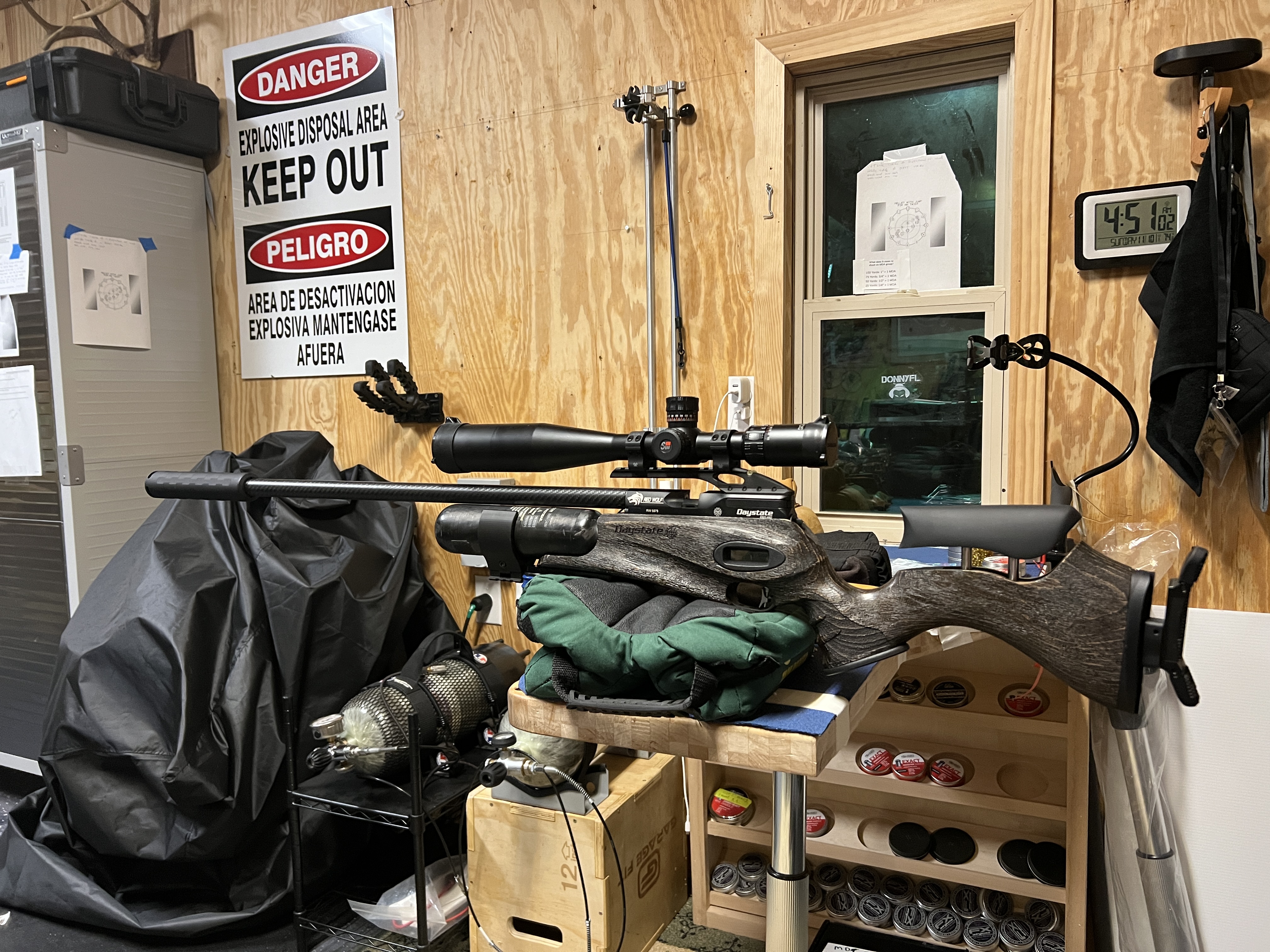

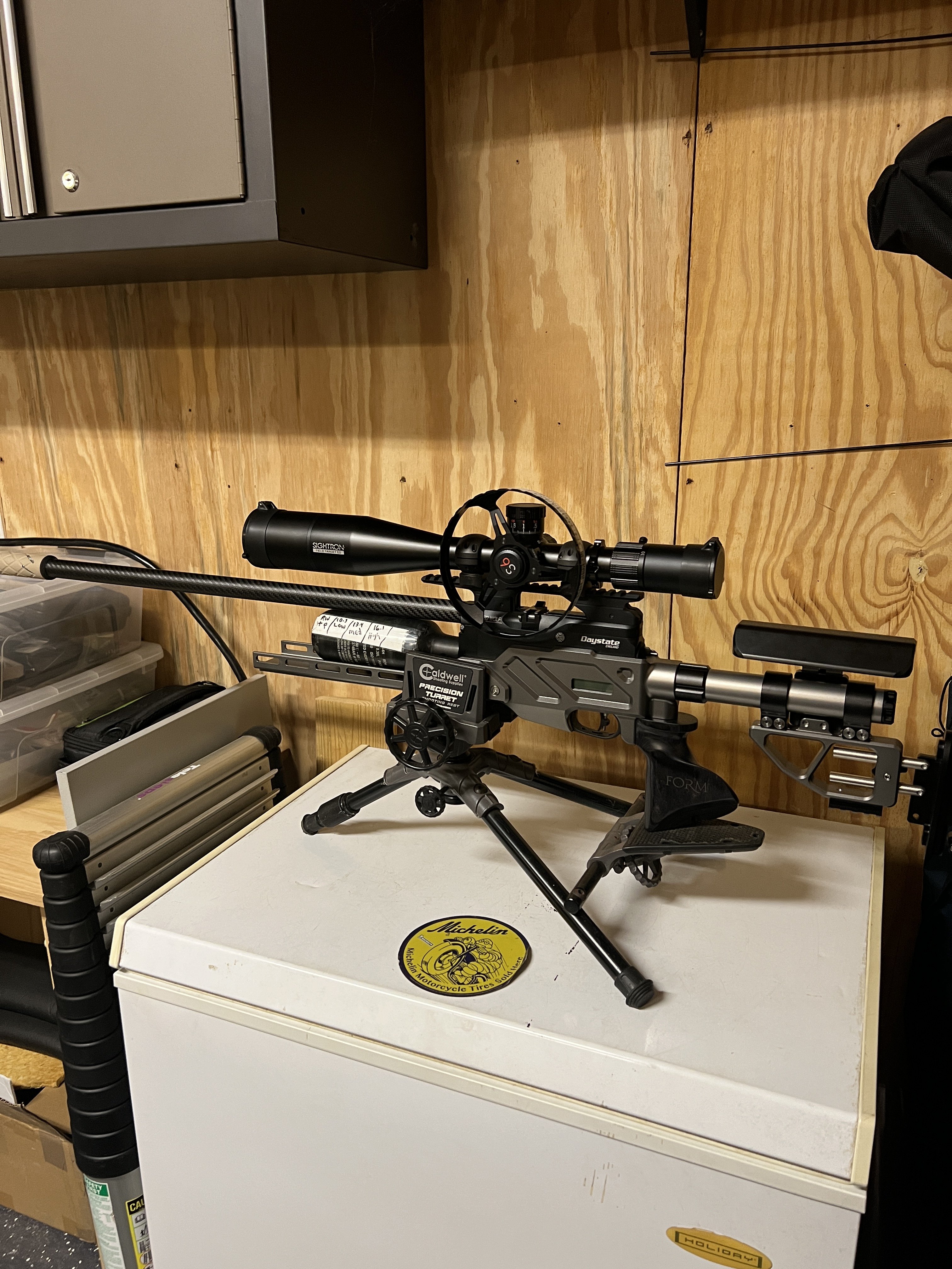

I have owned both…
Red Wolf - You are talking about technology that is years old, albeit very good technology. Might be best to wait and see what the new rifle is this week… They are great rifles, but the limit of 3 settings does kinda suck. I replaced mine with the Helliboard and it was a big improvement with many more settings to choose from. It would still be nice to have smaller adjustments for weather and altitude and such quickly be able to be made on the fly, but you can program those. The regular programming kinda sucks because it isn’t intuitive and you must buy a programmer. It is a rifle platform, so it gets really long too. I like that it comes with an adjustable cheek, but you do need to add something to allow for a bipod, because you get nothing factory. I found that as long as I didn’t fill over 230bar (even on later models), my ES/SD were MUCH better as it did affect speeds. I still like the rifle, but I wish it came in an affordable chassis and had more settings. I would probably still have one.
Evo - Great company and excellent customer service. I owned the Epoch and the Evo. The Evo looked like it would be the perfect upgrade for me with the slight format change. You can have the 35” barrel and still be shorter than a RW. Accuracy is proving to be stellar on this rifle, as good or better than we saw with RW’s. No addons are required to go out and shoot on a bench, but the longer ARCA is nice. I personally don’t like the newer higher powered reg in the Evo vs the Epoch. I never had issues with the Epoch but the design of the new reg is a bit of a pain. The changes to allow for higher pressures has drawbacks. The leaking issues are just aggravating to deal with, even after replacements of orings and full regs. Seems like most people just work around it. Barrels swaps couldn’t be any easier than how easy they have made it. It can also be had cheaper than a RW.
Because I have owned both and am looking for a new rifle… asking me which I would choose, I choose neither because I can honestly say I have sold both. Hard to say right now what I would choose over either though as they are both at the top best options list. I am having a hard time choosing now as well, and I’m waiting to see what the new Black Wolf is like before making any choices.
