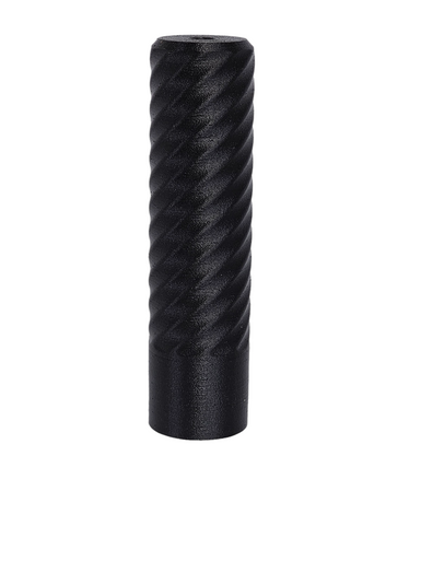

The basic premise of the design is to use Nikola Tesla’s Gas Diode to reflex air back on itself and stop forward flow in the moderator. The moderator uses a three-stage system. First the air is stripped off the pellet, reducing turbulence and improving accuracy. Second it is delayed via compound gas diodes. Finally, a damping system muffles the sound. Most moderator designs focus on one of two capabilities, either sound wave damping or flow delaying, and this is copied the entire length of the moderator. Why though should the sound and flow at the back of the moderator be the same as at the front? It didn't make sense to us either, thus the design adapts along its length to maximize sound attenuation at a given flow level while minimizing size and weight.

Interesting rip on Silent Thunder Ord. but let's be honest, it's not like STO invented the wheel here, Nikolai Tesla did.
I think the meat of it will be how the diodes are constructed. If you've ever been inside a STO moderator they are all soft bits and foam construction. Can Skout do this with a more solid medium? Time will tell.

I had a really long winded reply written but erased it and will only share this thought on moderators, which is still...long winded lol.
Airguns at their optimal power levels and tuned efficiently release around 1cc per 10 FPE at 2,000 psi in the modest power range of 20-60 fpe. For a 40 FPE airgun that is around 4cc of air at 2,000 psi.
Releasing 4cc's of air at shy of 2,000 psi into a .25 cal barrel of 20" in length which is roughly 12.5 cc's of volume, the barrels pressure towards the muzzle end then becomes roughly 575 PSI, which rapidly empties into and through your moderator at over 9,000 inches per second... where moderators are then able to work their magic but must do so quickly, as we're working with milliseconds before air reaches the end of its journey. The air then takes its final exit from the moderators bore into atmospheric air, where you'll have roughly 50-250 psi evacuating into 12-14 psi depending on your elevation. All that to say, once at atmospheric pressure, the total volume discharged from the 40 fpe airgun which was once 4cc's at 2,000 psi, becomes roughly 500 cc's of air once equalized with the Earth's atmosphere, the same volume as many larger airgun tanks in their entirety!
Handling the expansion of air going from 12~ cc's at 500-600 psi to 500 cc's at 14 psi quietly is quite the tall task. Airguns allow a lot of different approaches with their design due to their lower operating pressures. Sure is exciting to see on-going research and development being done here for the industry /community.
-Matt
Any idea when these will be available? Would you need one for each caliber, or are they configurable?
Available currently on our website as well as your favorite airgun dealer! They are caliber specific, but you’re welcome to go with the largest caliber you have and they still work pretty well with smaller calibers!
