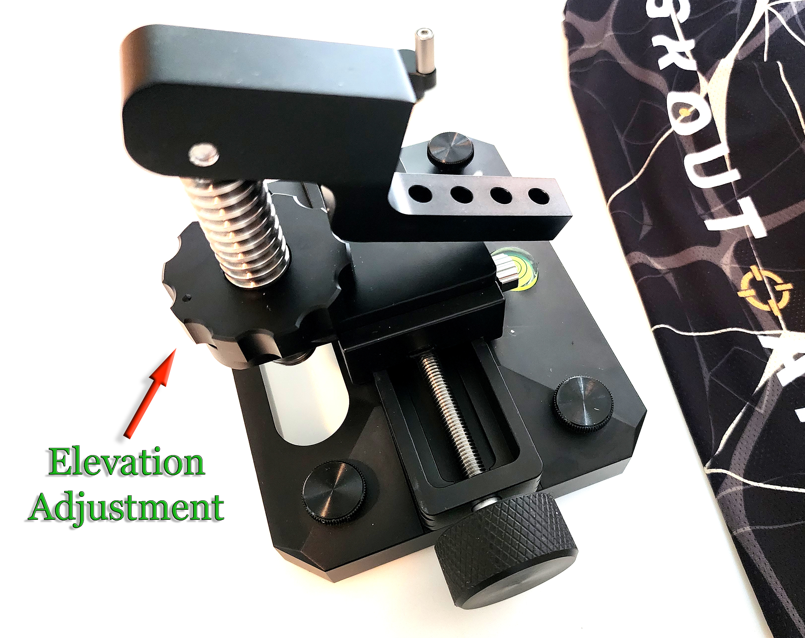

1: Overall Weight +/- 7lbs.

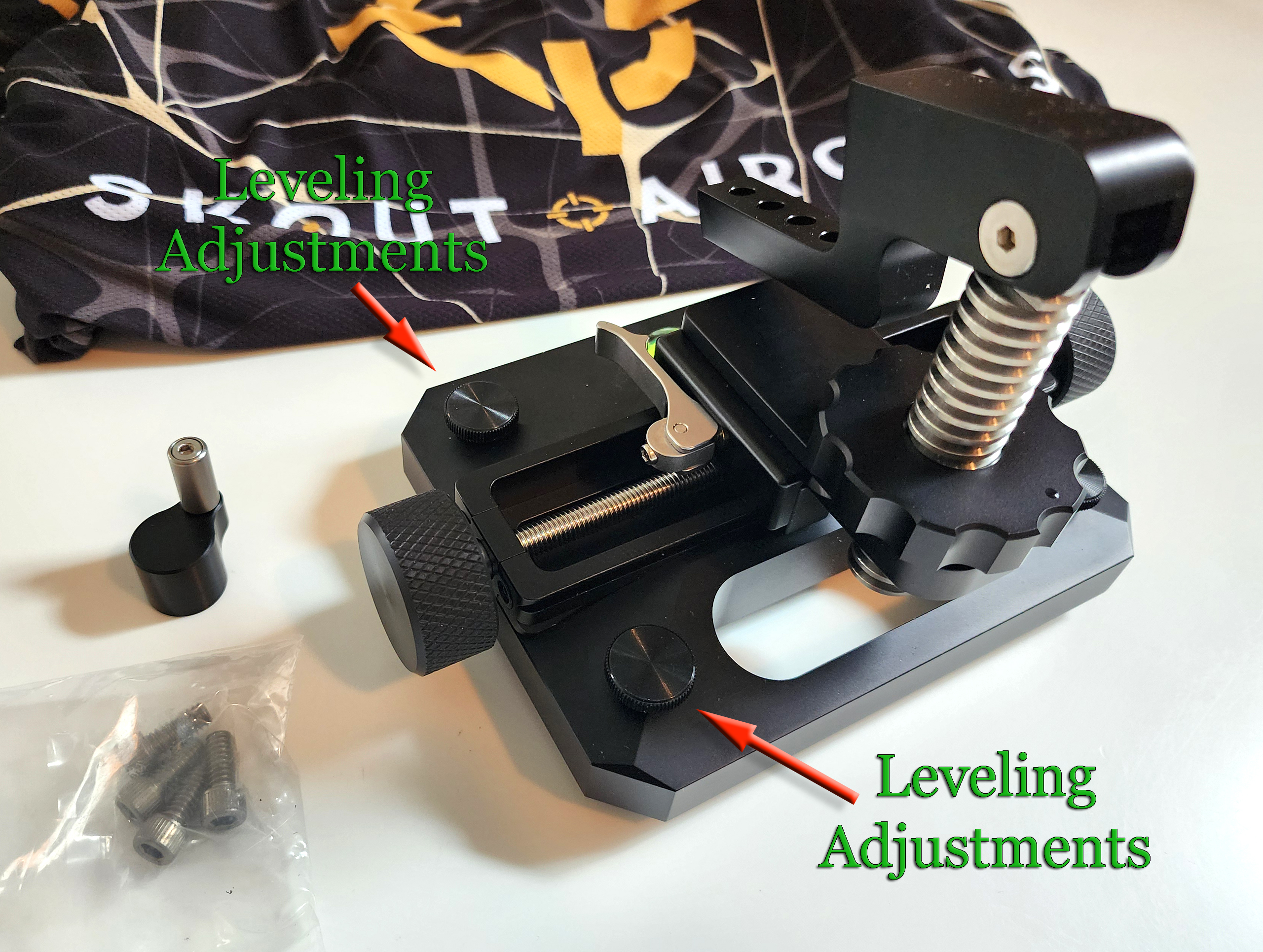

2: Micro Adjustable Leveling Feet

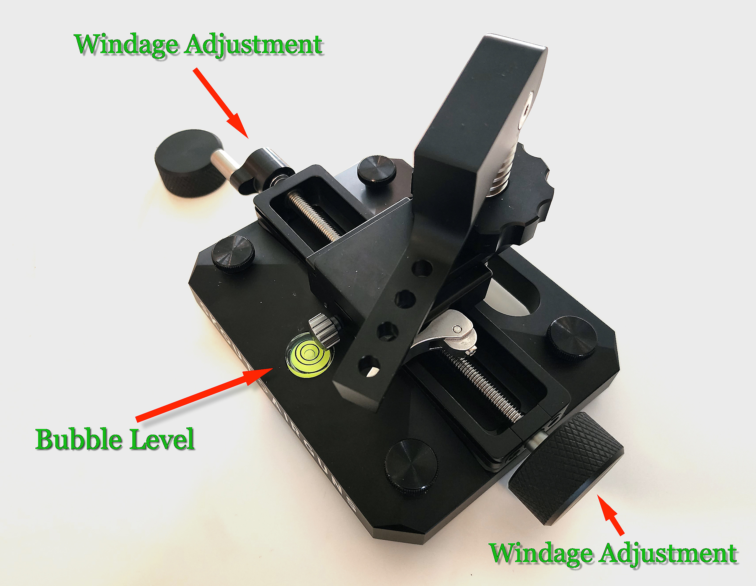

3: Precise, Ambidextrous Windage Adjustment
4: Interchangeable, Magnetic Windage Adjustment knobs (two variants included)
5: Large, Precise Elevation Adjustment Wheel

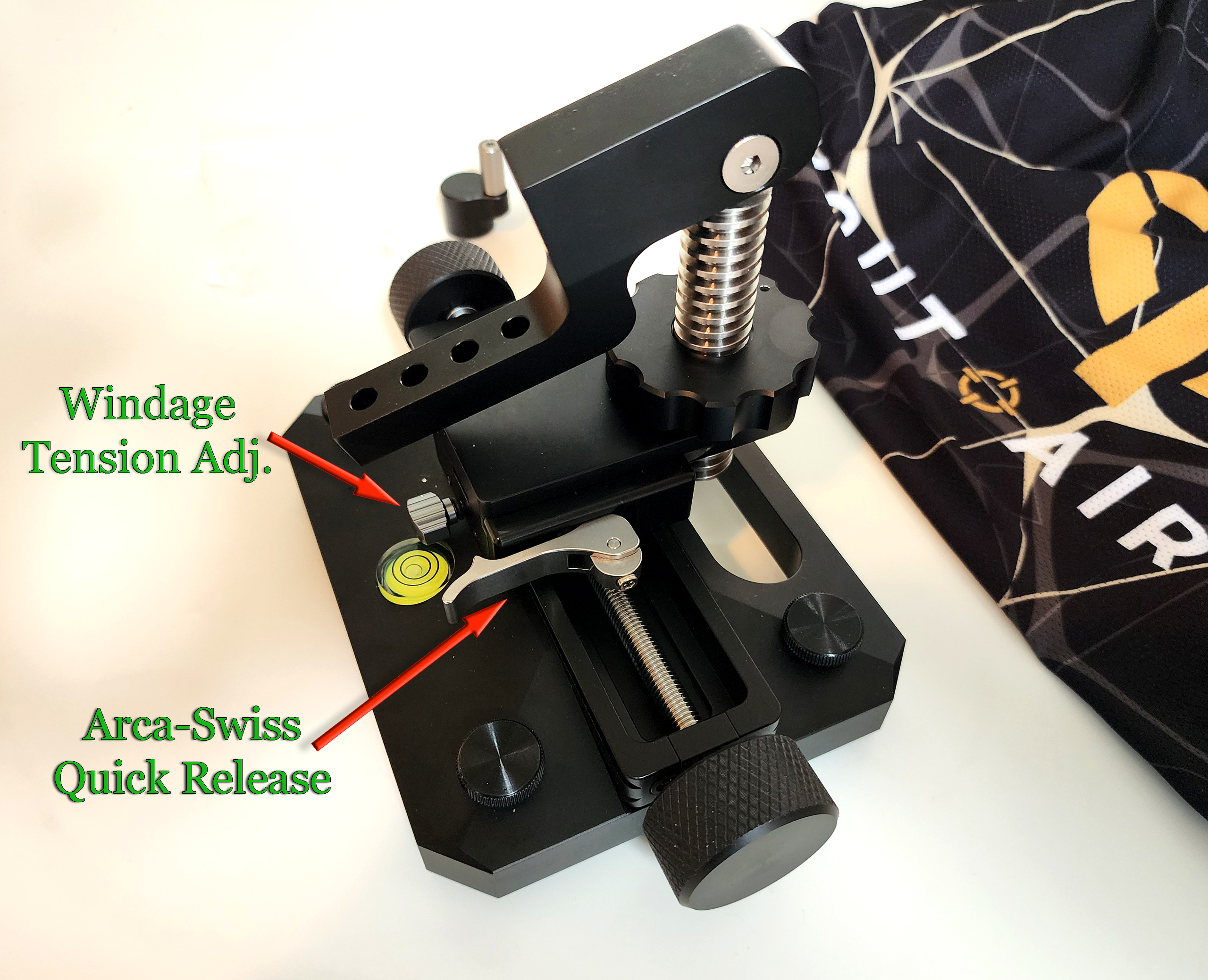

6: Arca Swiss QR Mounting Plate
7: Windage Tension Adjustment & Position Lock
8: Bubble Level

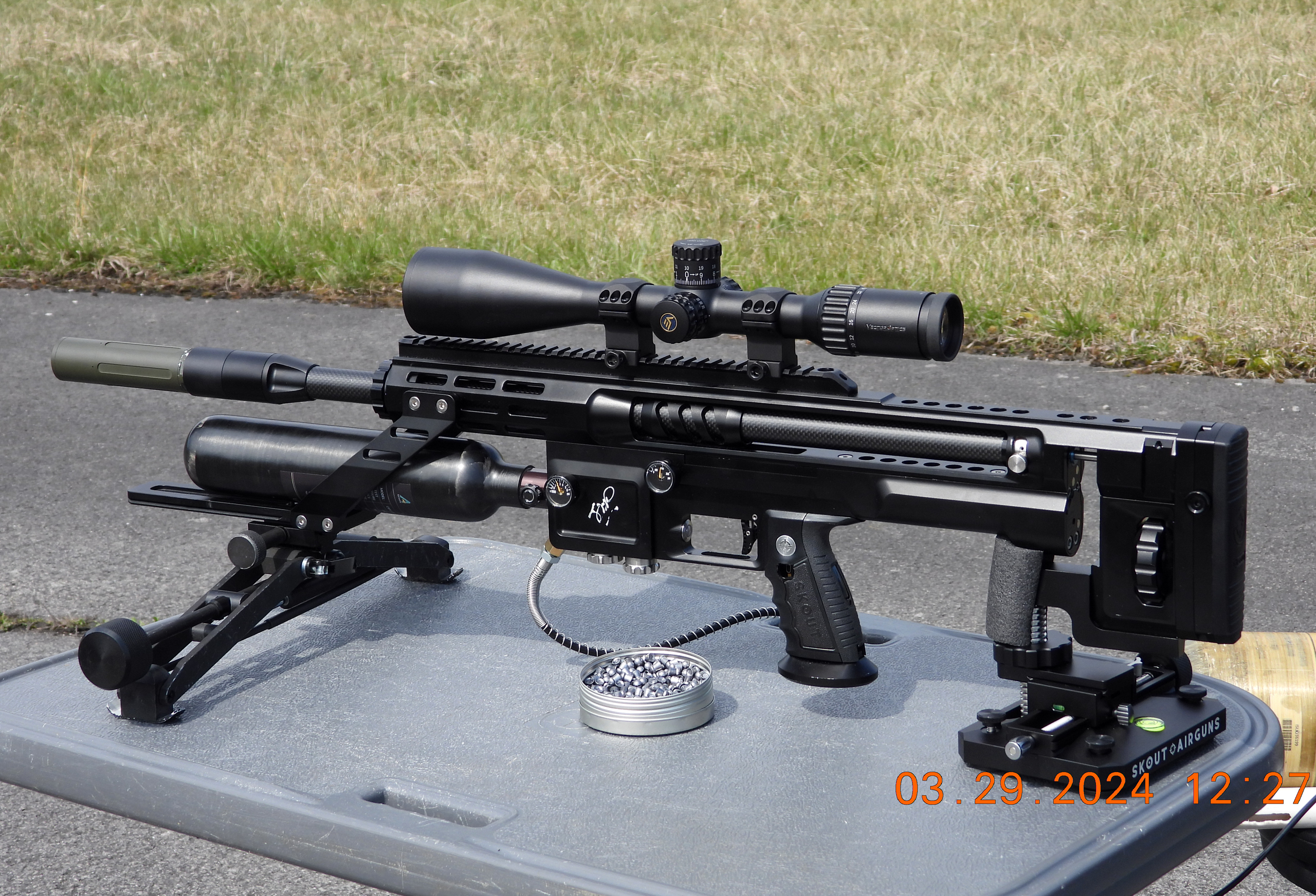

I found the use of this rear rest far preferable to adjusting with either my front rest (a Russ Bear bi-pod) or
any rear bag rest if which I have many. I was able to achieve enhanced consistency in my shot to shot
placement with considerably less effort even when “chasing the wind” as during the period of time
after making any adjustment, I found it unnecessary to manually hold the gun in that position while
waiting for “my preferred wind”. For me, that was the real hook.

So does the rest physically attach to the gun? If so, what absorbs recoil?
Thanks for the write-up.
Dave
In it's initial configuration, the rest is currently being sold for use with only the EPOCH. With proper setup and grip, any recoil is distributed between the weight of the rest and shooters shoulder. The short barreled .25 cal (the configuration I typically use) has the most recoil of any of the configurations I have tested. (.22 L&S, .25 L&S, .30 L&S, .35 L) I found the rest to greatly reduce the amount of shoulder pressure the gun requires.
Glad to see Skout adding a rear rest to their lineup. I do have some questions though. It appears the rest has 4 leveling legs. If so, 4 points of contact are a hinderance to level a rest on any surface. Wouldn't it be more beneficial and logical to use 3 points of contact?
The elevation adjustment also makes me scratch my head. It appears that the leverage ratio of the cantilevered mounting arm creates a moment on the elevation post and therefore potentially binds the elevation screw threads in a less than ideal design of application?
