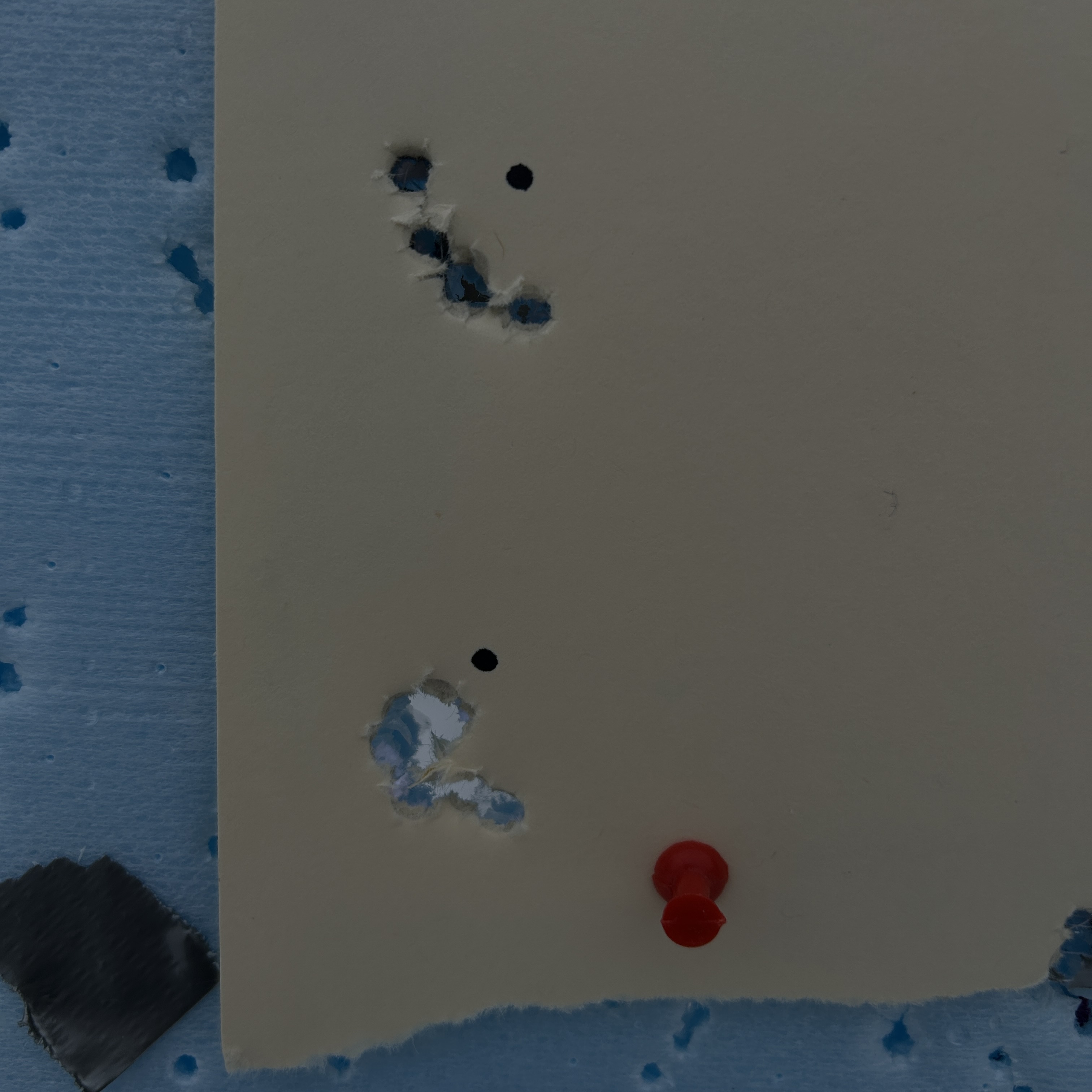

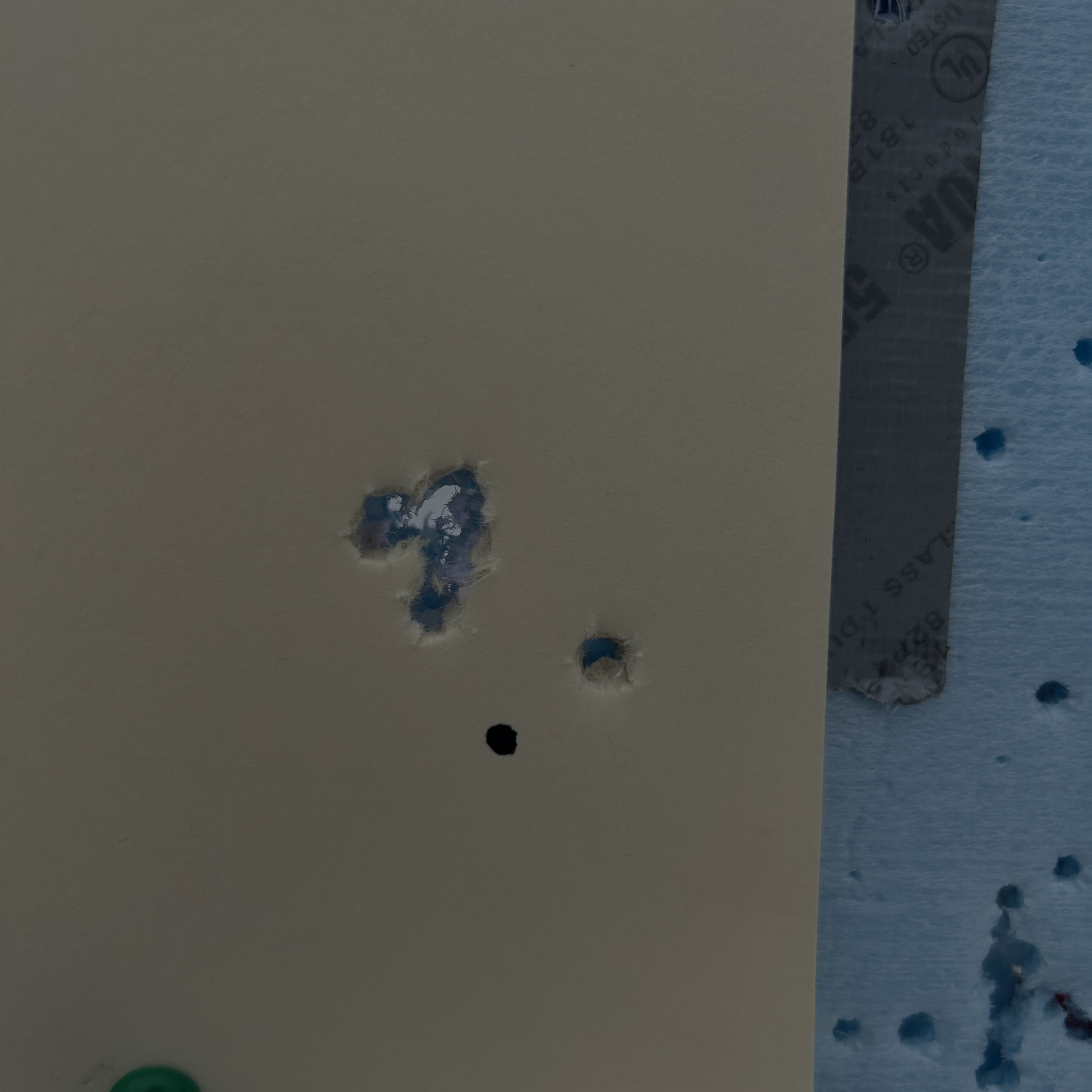

Update, shot about 4mags thru the gun (15deg. First day) these were taken yesterday 35deg. And very, very foggy, two were 15 shots one was five. 34gr. jsb’s At 50yds last group was five and after shot realized when I went back into the house it was below hp reg. ( I hope explains the bad vertical )
It seems to like about 2 mags thru barrel after fully cleaned to settle in.

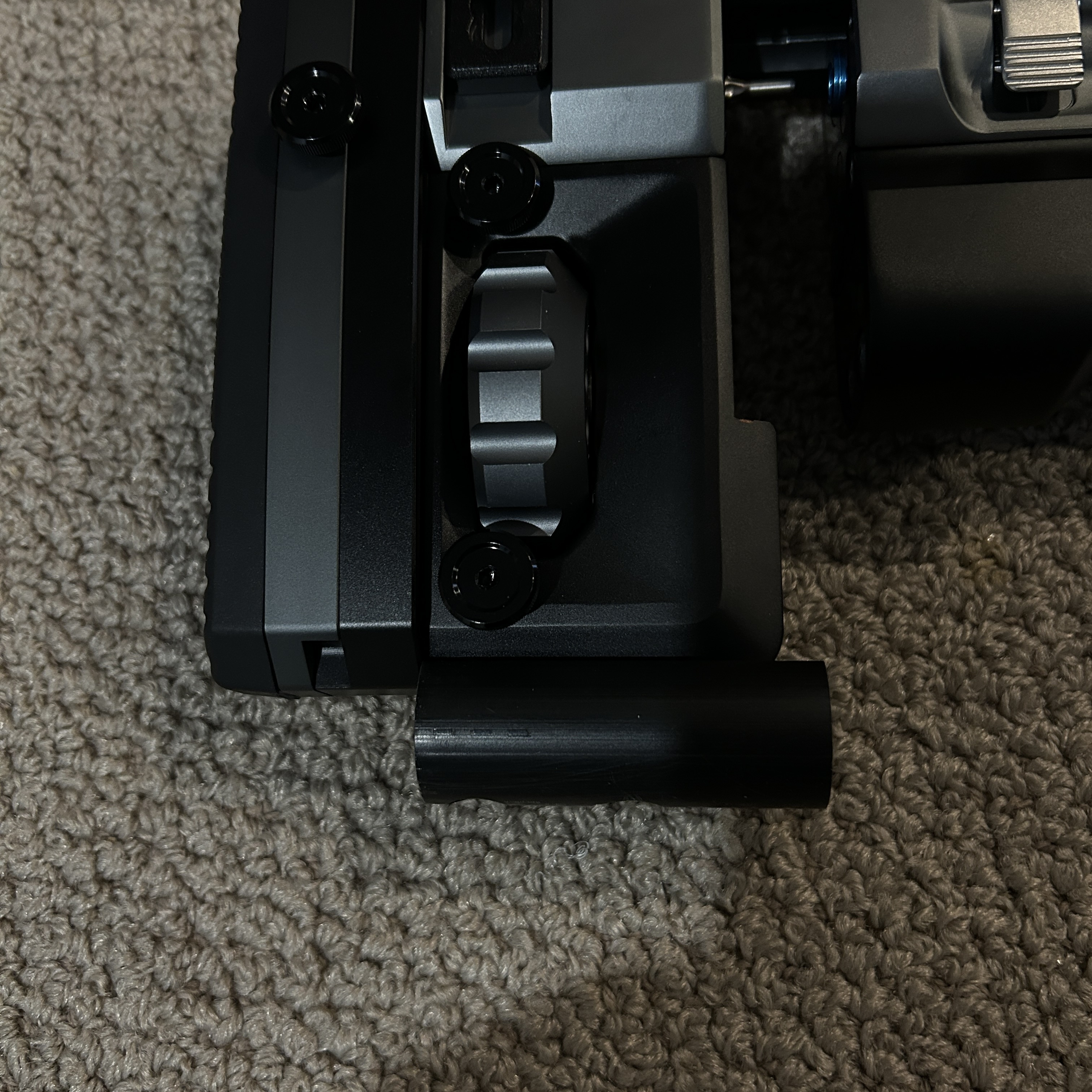

Also made a rear bag rider out of delrin.
I am very happy with my purchase of this rifle. It is quite loud I must say! Go USA…
I want to clarify something after returning to the house I discovered that I had not fully opened the air tank isolation vlv.! I believe this contributed to the vertical I was seeing? Especially the last 5 shot group which was directly after the last refill. Please make sure your isolation vlv. Is fully opened!
