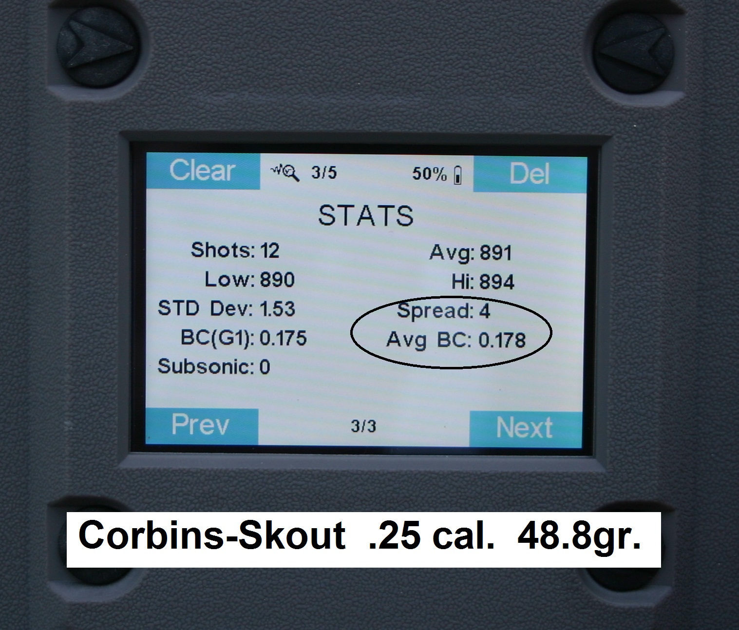

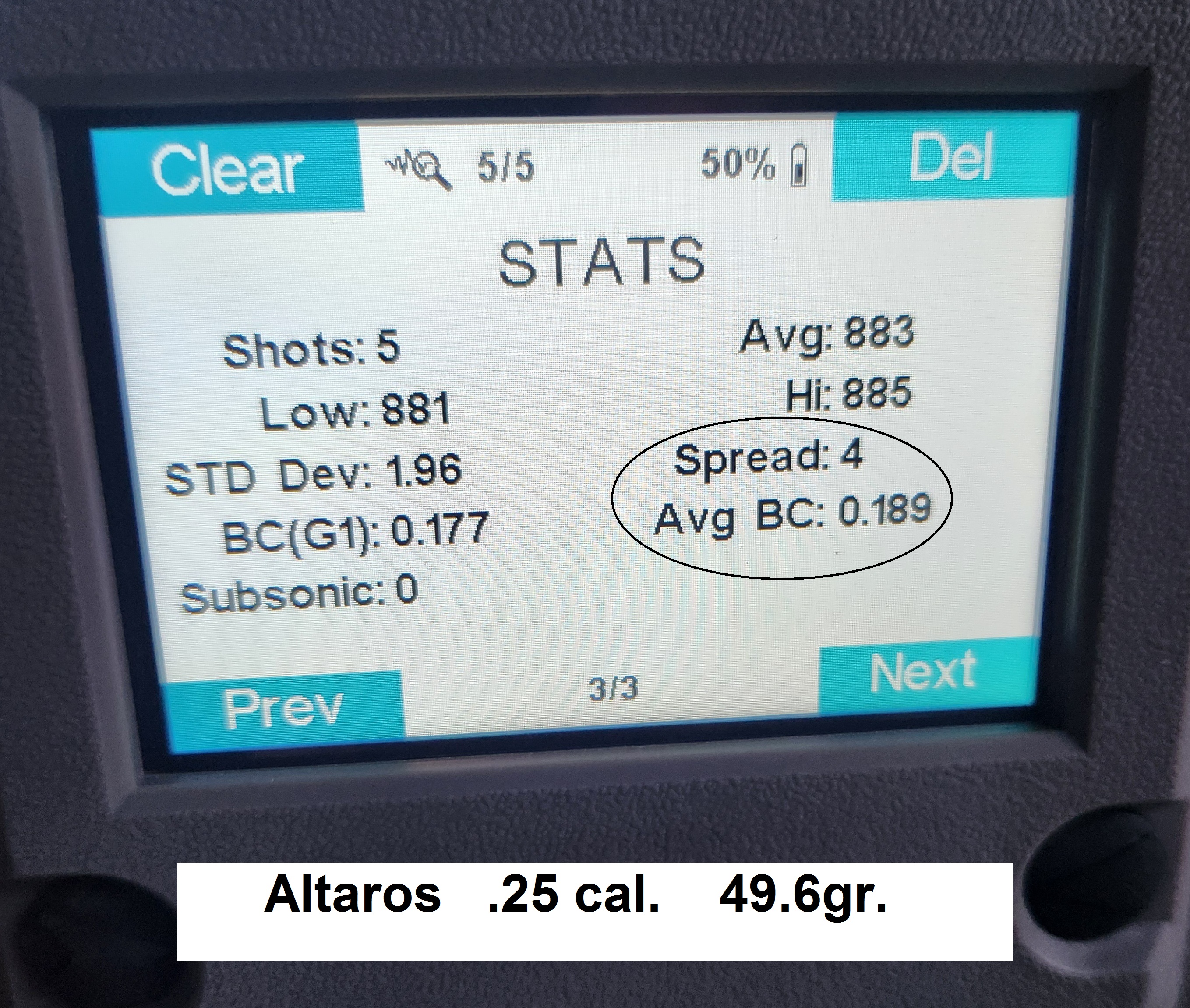

Data shot from my gun doesn't actually show a 17% difference in BC. Just for a reference here.

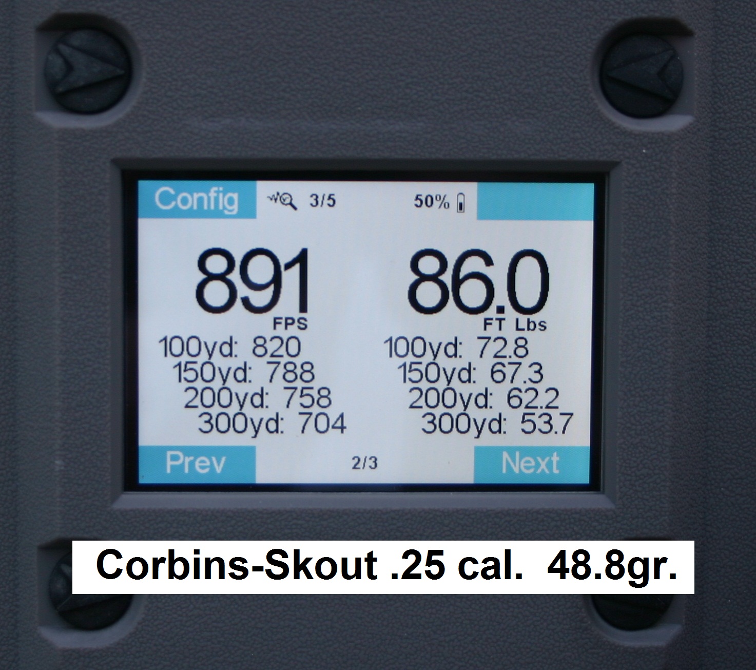

View attachment 452542 Even at 100,200,and 300 yards the chronys theoretical data below shows decent velocity and Ft Lbs for a well designed HP to still work effectively.
if you want to measure something accurately it is need use the right tool, unfortunately, this device looks like it, but it is no.
The FX True Ballistic Chronograph is mostly a random number generator as far as BC measurements are concerned.
I've had a LabRadar for many years and recently also bought a garmin CX1 chronometer and the aforementioned FX "True" ballistic radar, as I foolishly thought it would save me time measuring BC (that I wouldn't have to calculate BC from the data like with LabRadar but I will see them directly on the screen).
The reality is that the FX radar can produce somewhat usable results after firing 25+ shots, averaging them out to be at least remotely close to reality. It can be seen with every measurement when the current BC is even tenth different from each other (yes, a tenth when the BC measurement is, for example, 0.25).
After several tests, I decided to sell this FX radar, because LabRadar is much, much better for measuring BC (gives real results when operated correctly). Maybe this product works well for firearms, but for BT slugs to measure BC, LabRadar is much better.
