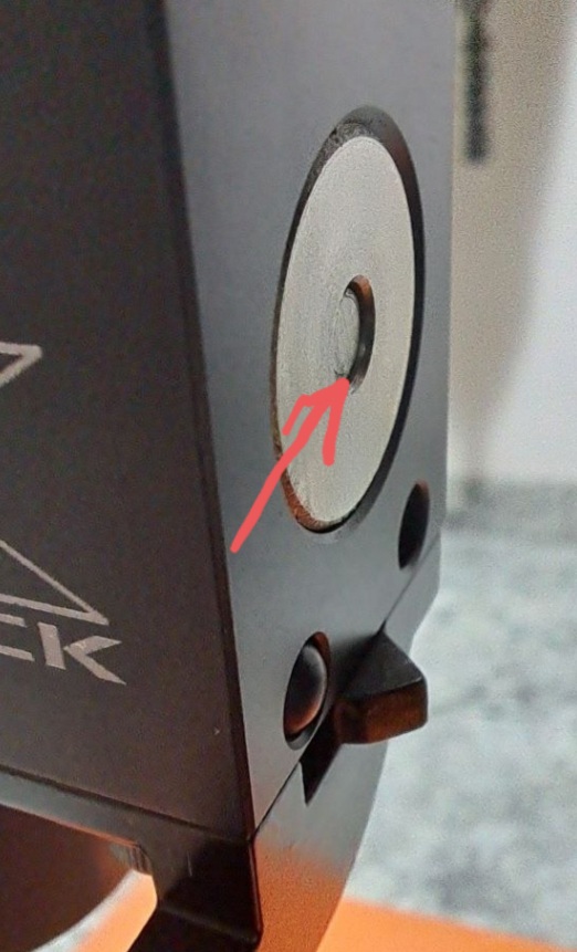

I need some advice please. I bought a new Fx impact 700mm .22 m3 fitted with a slug liner and slug kit (pinprobe/tungsten hammer and lighter valve return spring)
The 1st reg is on 150 bar and the 2nd reg on 108 bar. Shooting 25 grain 218 H&N slugs 984 fps and grooping is very good at 100 meters. Hammer on 12, mico at 3.75 and the valve 3 turns out. Shooting 30 grain H&N at 935 fps but with a problem
The problem i have is, once you open the valve 4.5 turns and put the hammer on 16 and shoot a shot there's an air leak at the rear end at the magazine/power block rear/barrel area ONLY when you pulling the cocking lever back to load a slug. You can hear it clearly it is not the plenum filling with air. Once you push the cocking lever forward the leak stops. If you turn the valve in say to line 3 the leak stops.
If you just pulling the cocking lever back without shooting a shot, there is no leak. The gun is also not leaking air when standing for days.
Could it be the lighter valve return spring, causing the valve to stay open longer.
Would you recommend to put the stronger original valve return spring back.
