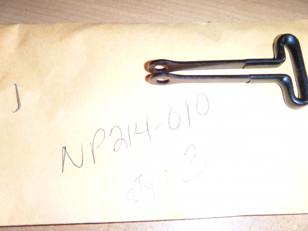

Well you can order one directly from Crosman and they attach to the connecting rod hinge pin at the foreend of the breech block and look like this.
I believe this is the part number and this came from the NP2 air rifle. A word of caution, not all air rifles have enough room between the connecting rod and breech block to slip one of these in there, others do so check your rifle to see if there is enough slack/free space in that area before ordering and also check to see if your hinge pin is about the same size as the holes you see here, for example my Weirauch HW30 has absolutely no open space to slip one of these in there and in that case I would have to use a barrel band type of sling swivel. If you are not adding this to a Crosman/Benjamin rifle then this may be a little hit or miss.
