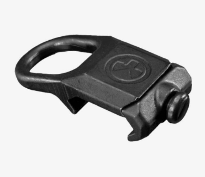

If you have the available real estate on a pic rail, you could try one of these single point sling mounts...

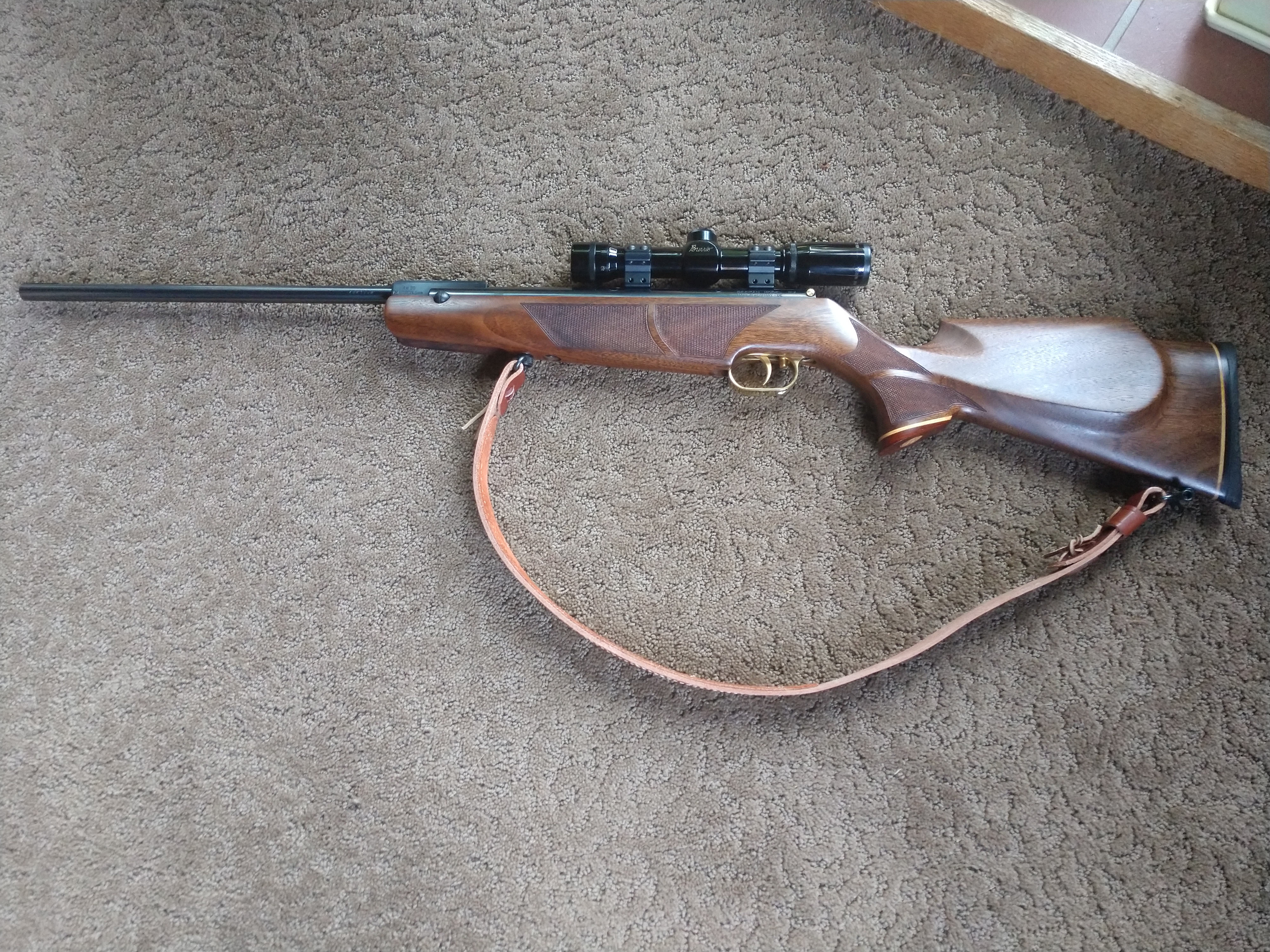

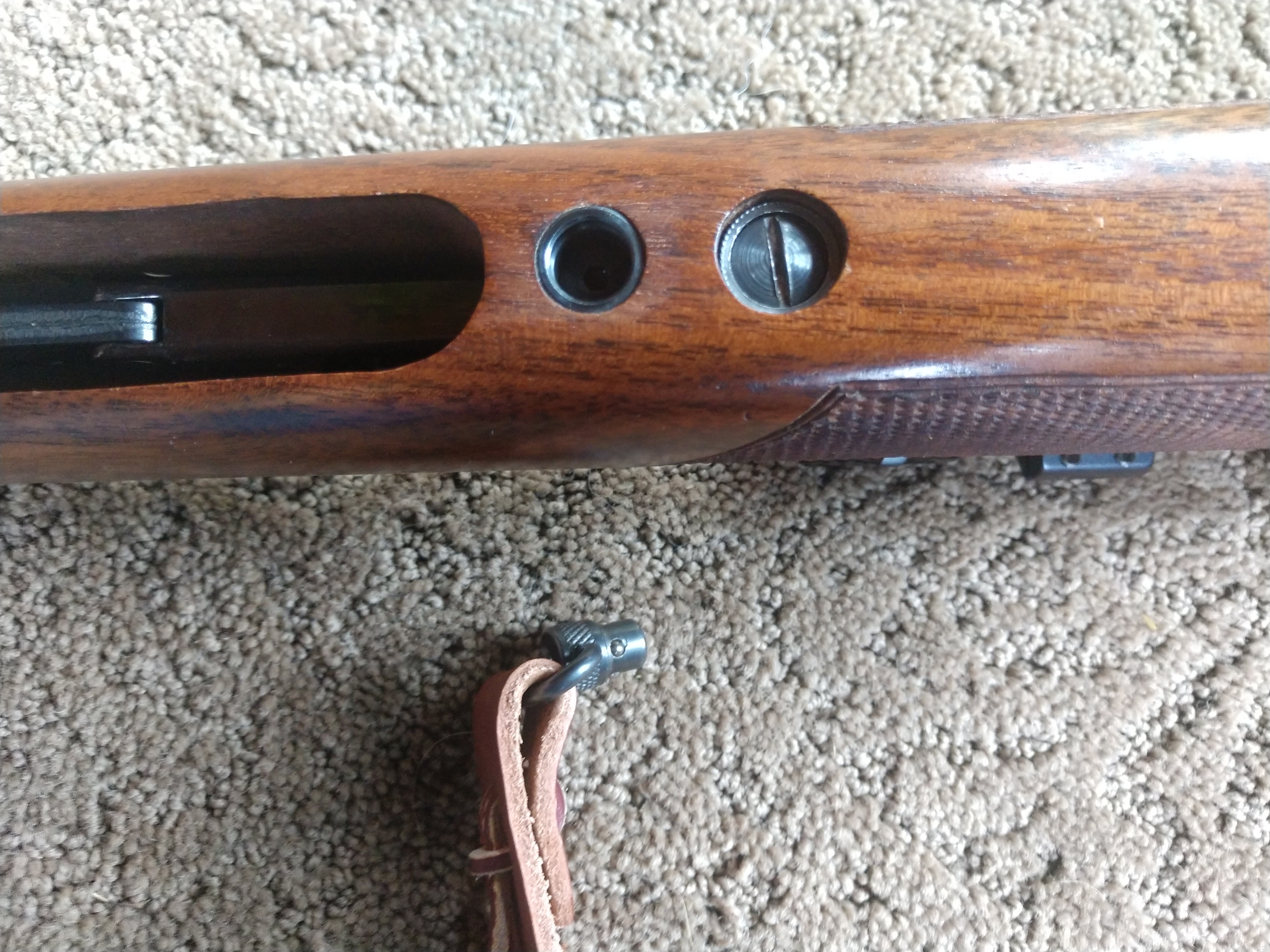

I just drill and use recessed QD pushbutton cups for the forearm, ( when possible). They work great, and are flush with the bottom of forearm, for no obstruction when sling is removed, and look professional imo. I use a 1/2" Forstner bit for a nice clean hole.
I always use a stud on bottom of the butt stock.
Here are two examples. Top two is my R7. Bottom, my Huben K1.
Take your time, measure three times, drill once. 😉
Have fun
