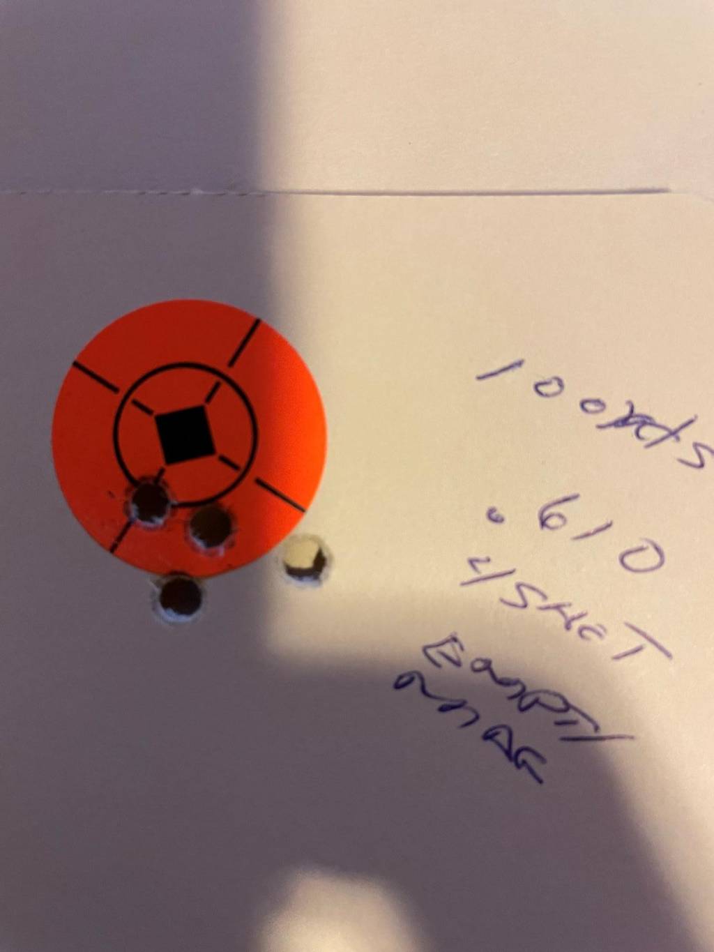

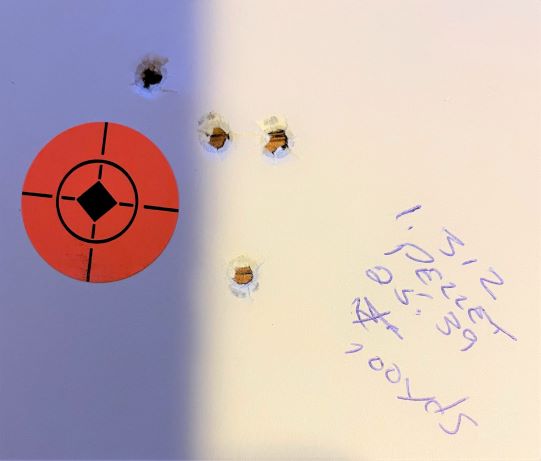

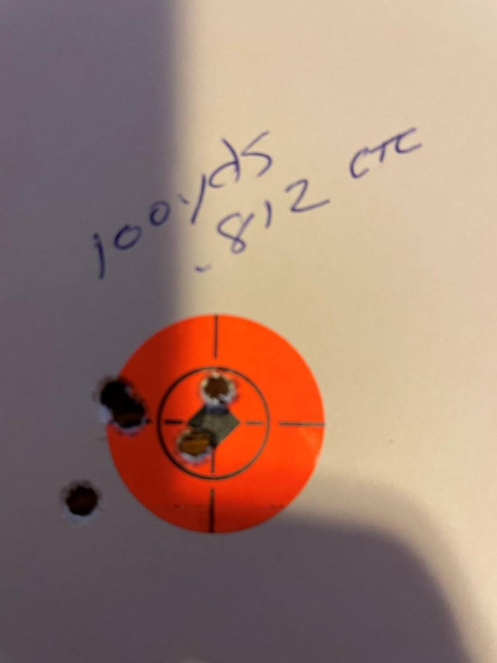

Shot these at 100 yards with a higher hammer setting using much more air and the ES was 10.4 but accuracy still looks good
