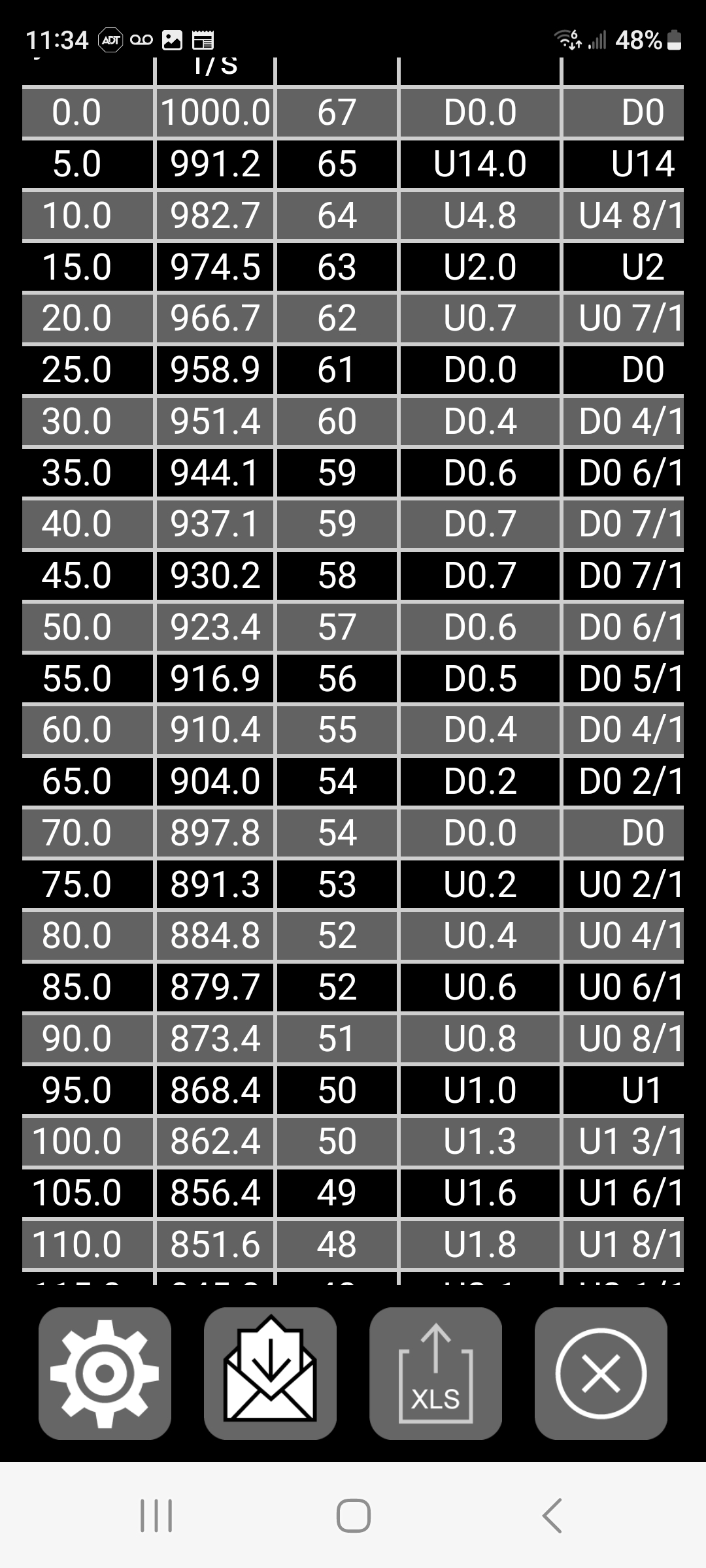

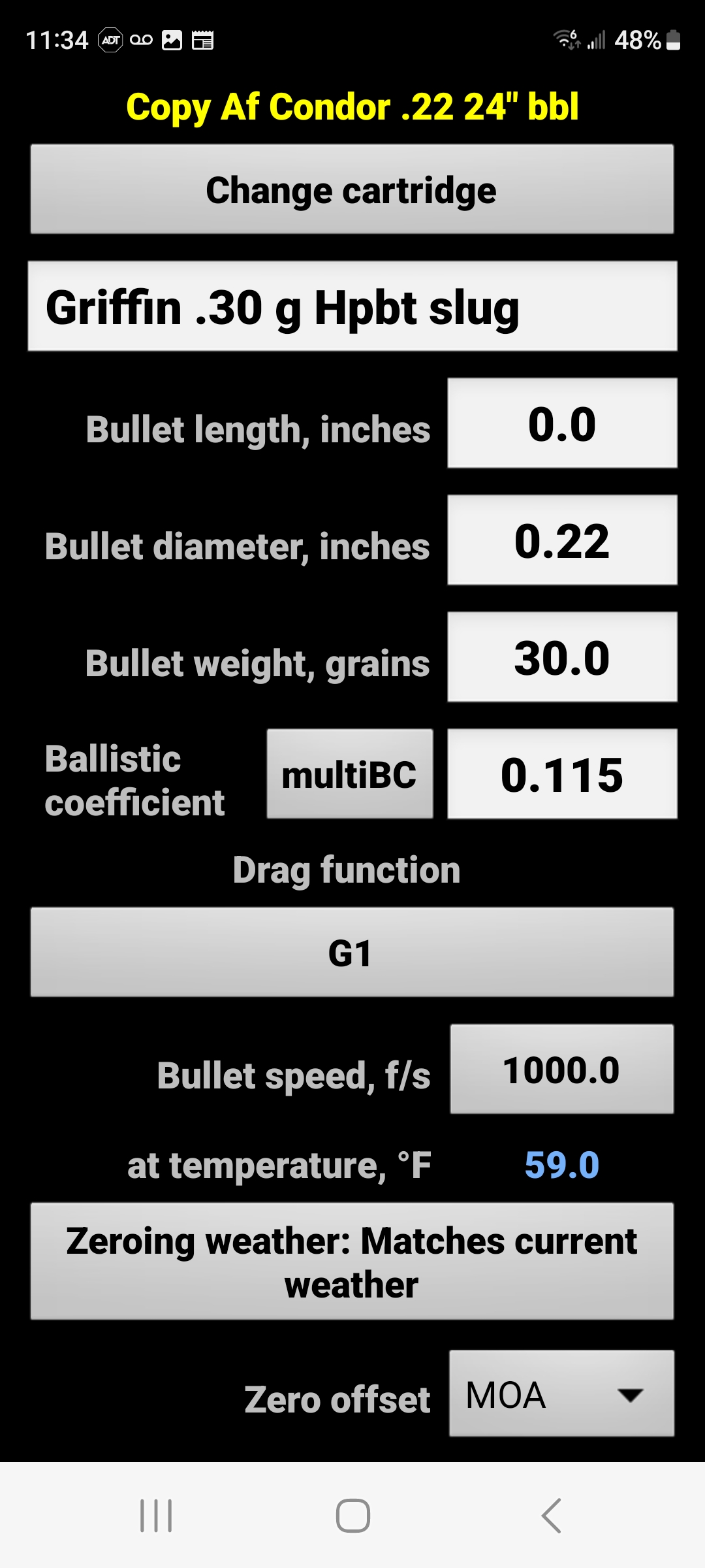

The Griffins hpbt .30 work well in my 22 condor out to 250 yds. Avs and Nsa also work.
