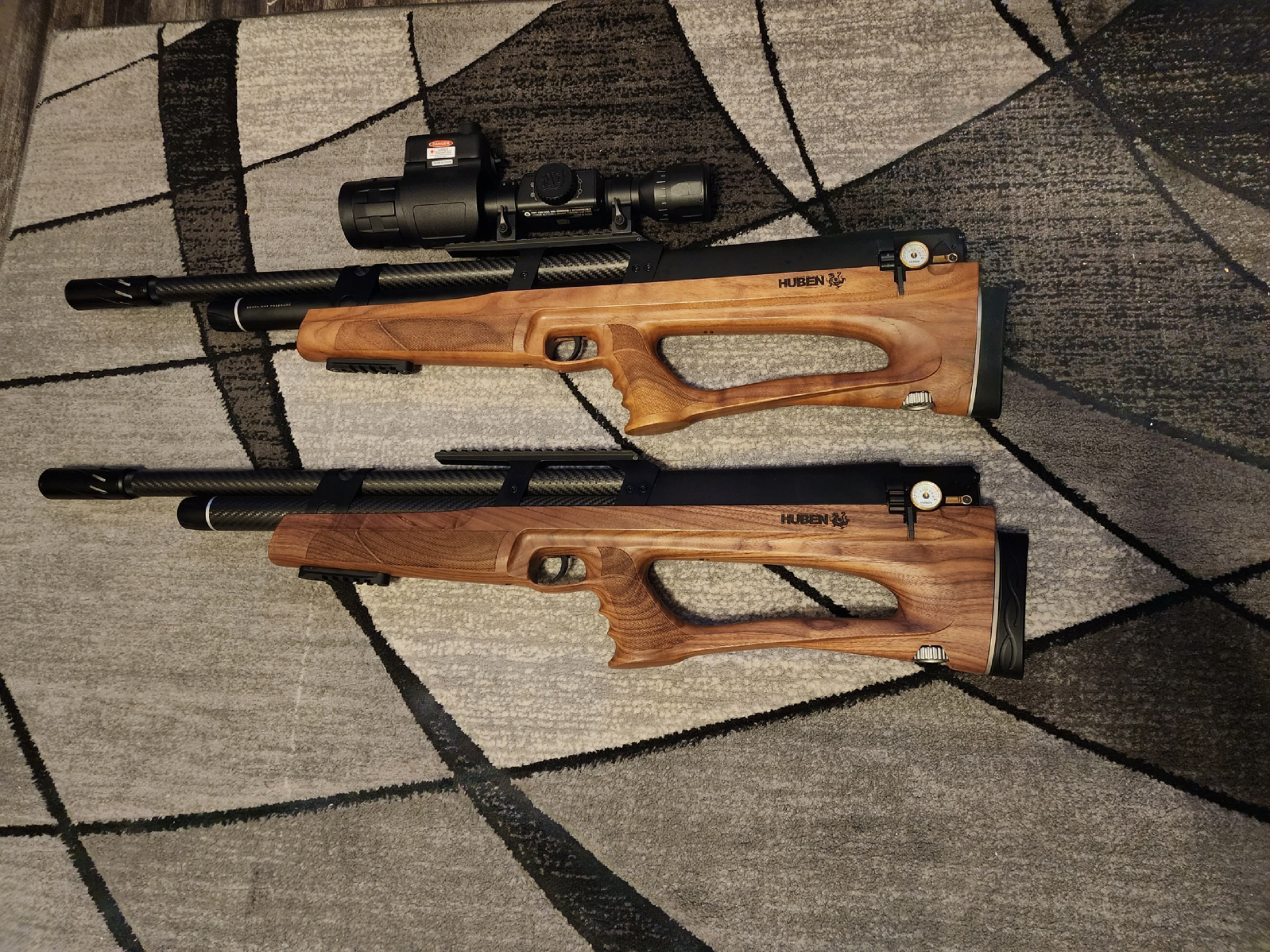

So I had plans to make the huben pair I have a .22 and a .25 2022/2023 pellet shooters but I think I am going to make them dedicated slug guns so first up is the .25 and just curious everyone's choice. I know they like the .253 and the .254 size so the question is AVS, Zan, NSA, Altoros what reg and what speed are you seeing best accuracy. I have only been using pellets so would like some input.
So I had plans to make the huben pair I have a .22 and a .25 2022/2023 pellet shooters but I think I am going to make them dedicated slug guns so first up is the .25 and just curious everyone's choice. I know they like the .253 and the .254 size so the question is AVS, Zan, NSA, Altoros what reg and what speed are you seeing best accuracy. I have only been using pellets so would like some input.View attachment 373349
I’m using AVS 42 Gr flat back at 950 fps reg is 19 food for thought I just switched to hades for some racoon hunting I shot four big coons and the hades smoked them! I left the reg the same and just dialed it down till they were pellet on pellet at 50 yards . Great gun so easy. Jim
