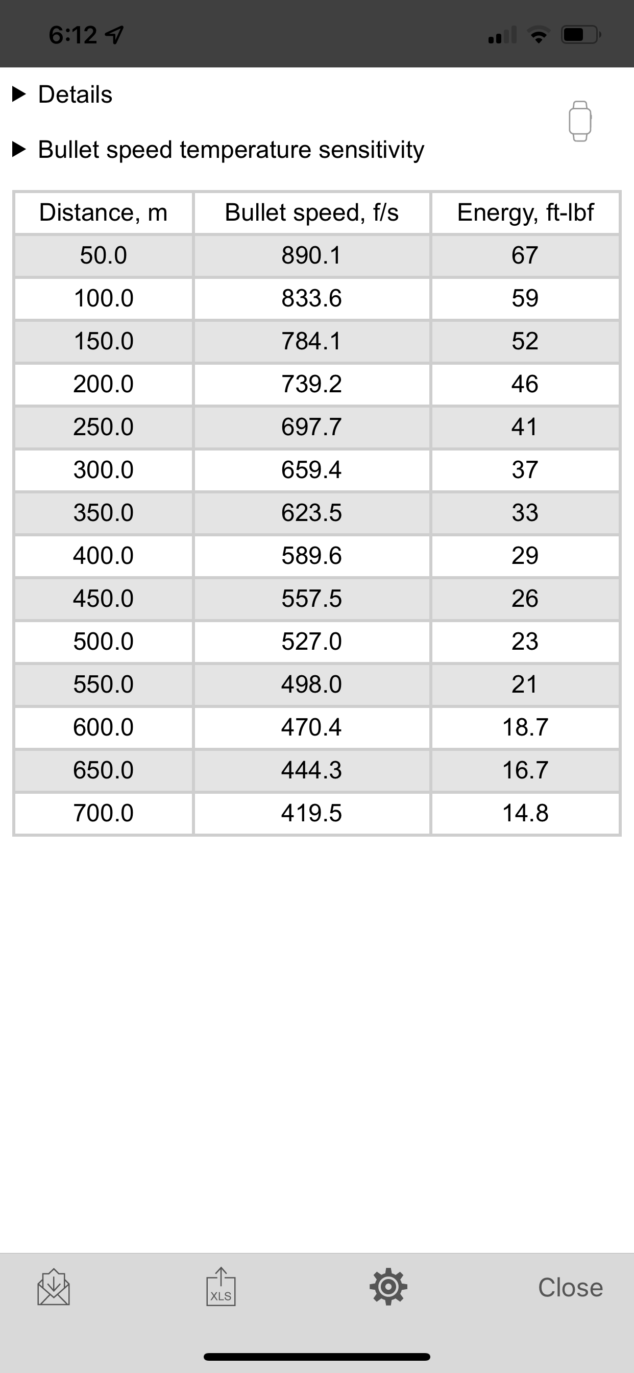

Just consult Strelok pro and you shall find what you seek. Here is my Impact “effective” range shooting 38 grain NSA at 960fps, guess my effective range is….800 yards??
Be careful with these things there, I would not want to be there on the receiving end of my 38 grain slug even at lowly 400fps. I avoid shots with no backstop at all cost especially the upward ones.
Edit: my table is in meters so 14.8 FPE at 770 yards!

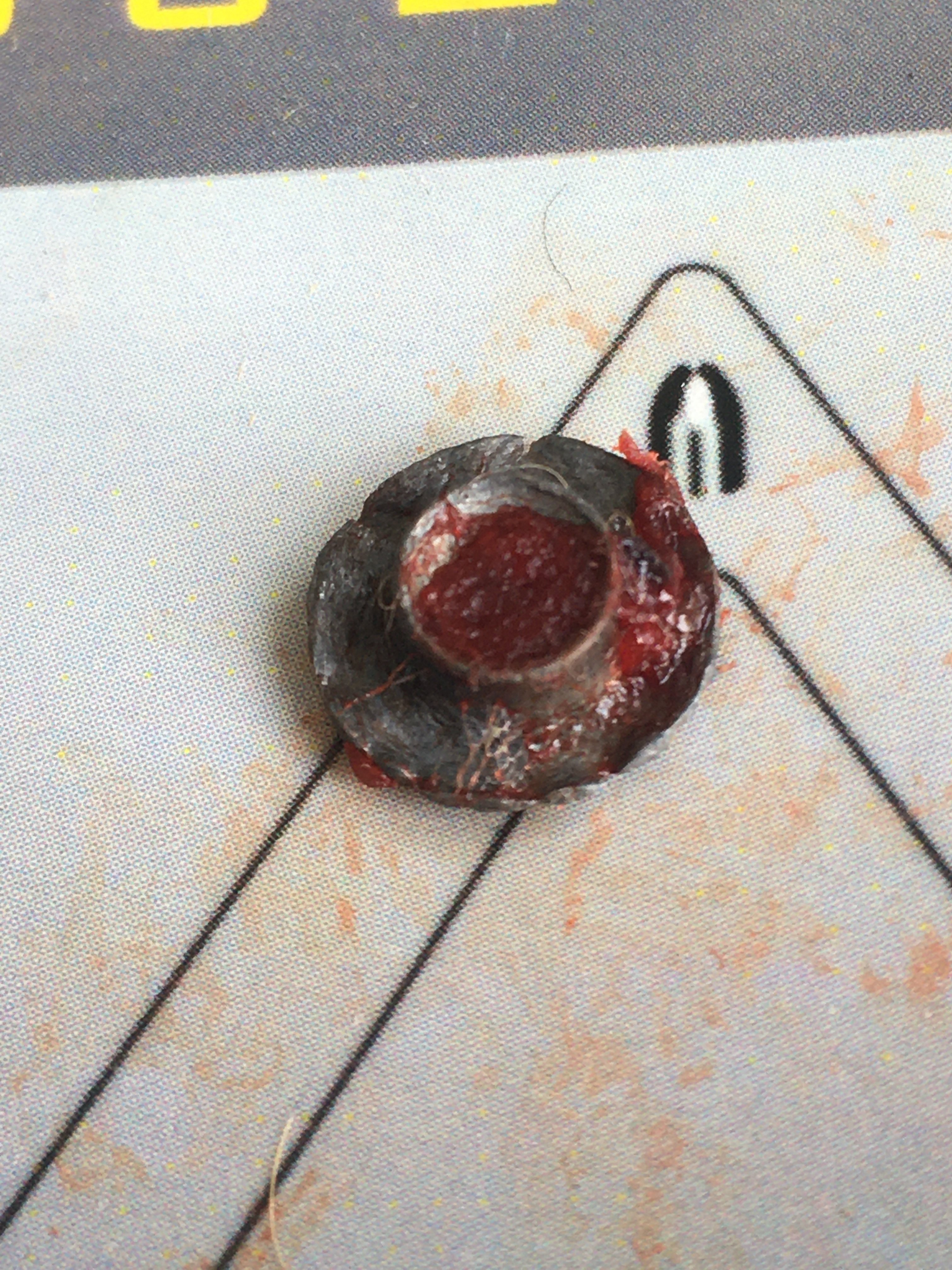

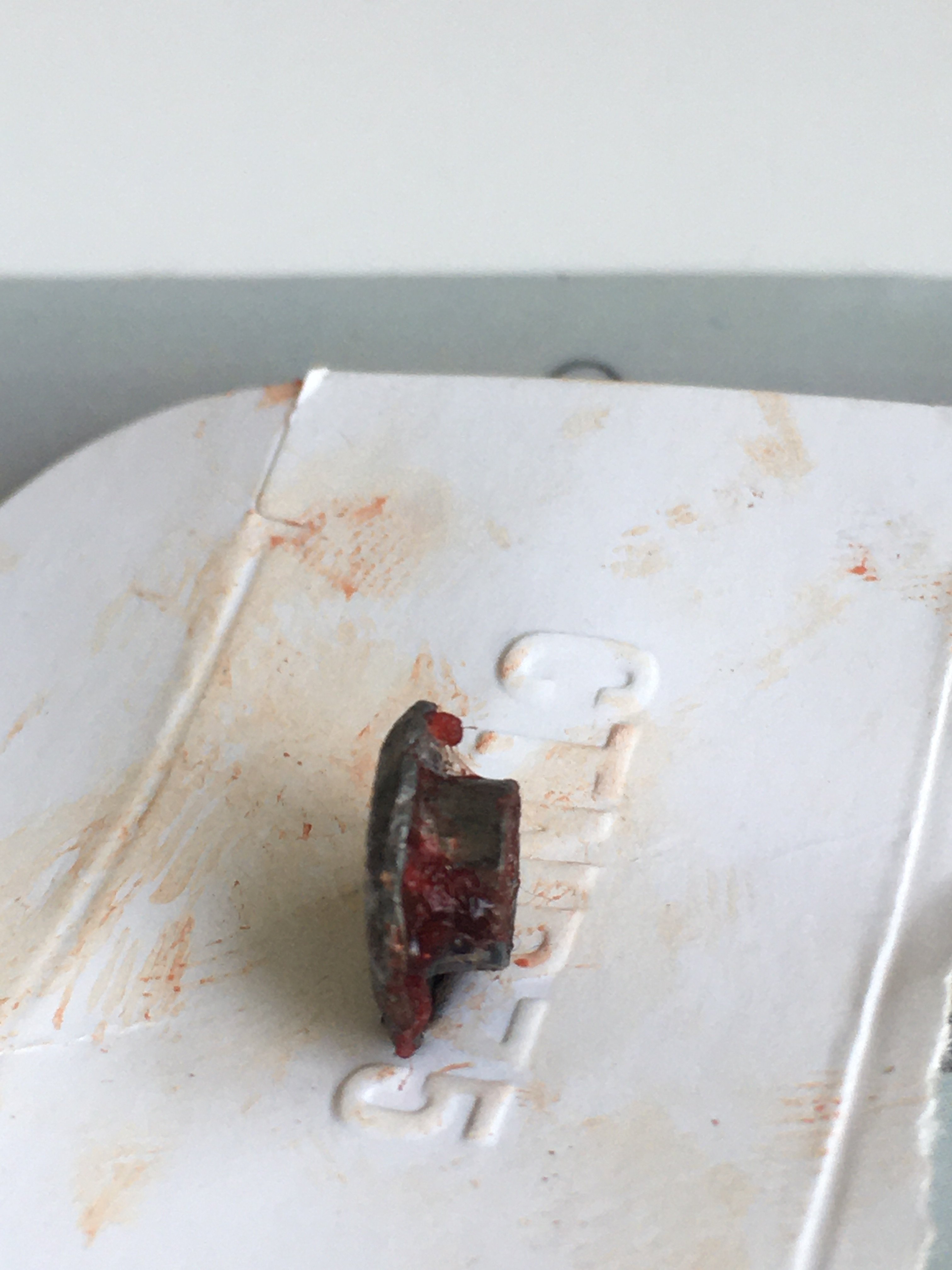

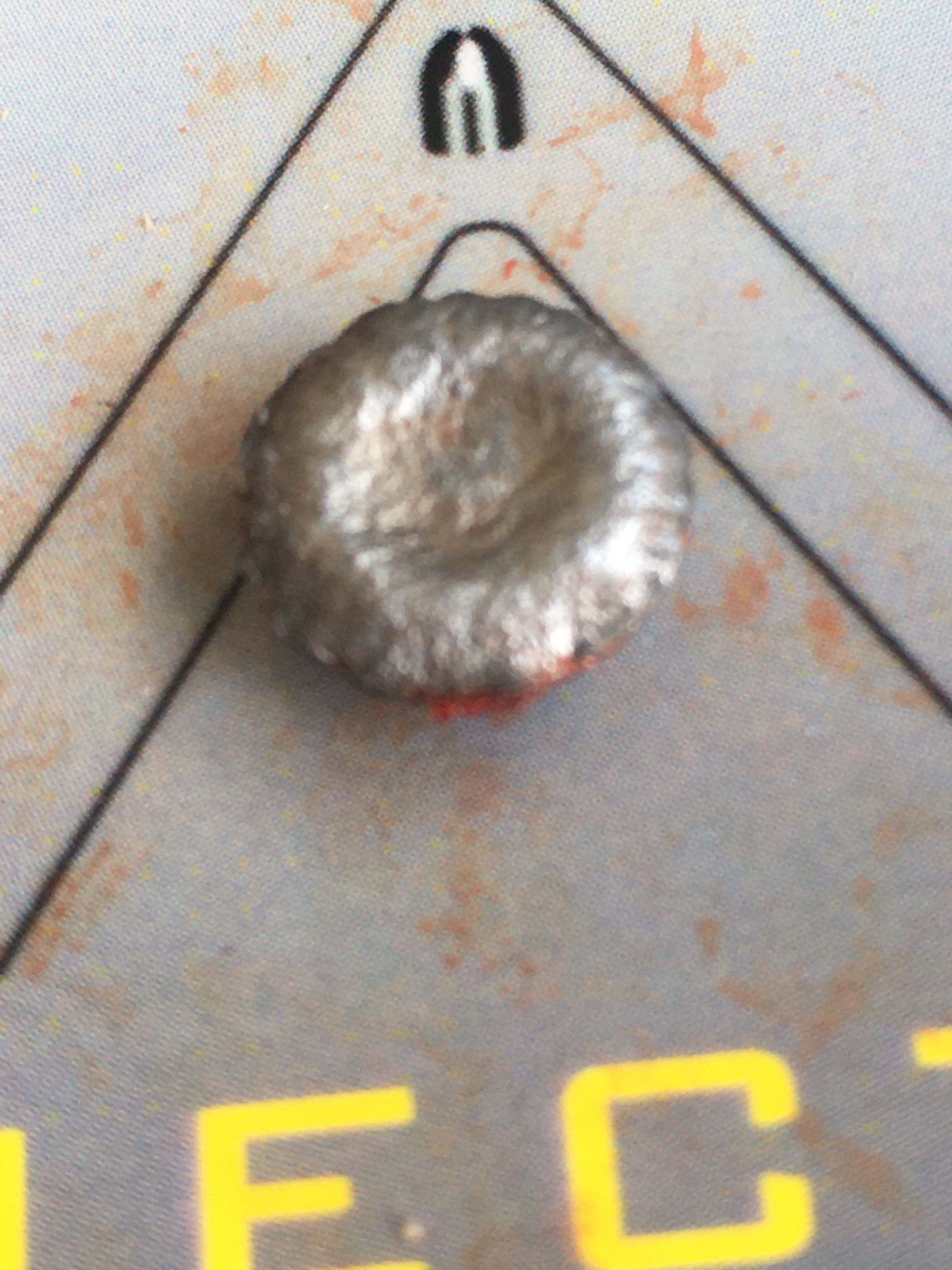

Impact mkII heavily modified shooting fx hybrid 44's @ 1011 and I take woodchuck shots out to 250yds all day with instant kills body and head but they DO NOT EXPAND 😕
Used to be tuned to Griffen 41gr superlight amazing little slug he puts plastic balls in his Slugs for crazy expansion

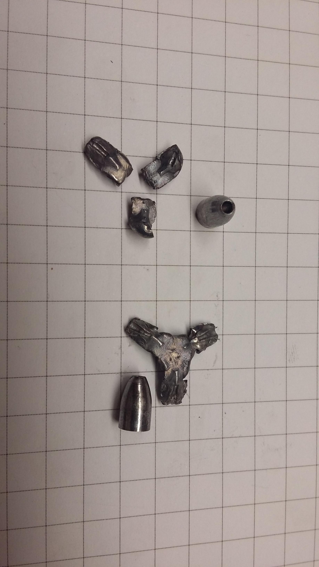

Long_Shot and I have been doing many tests on long and short range performance.
We both have Corbin swaging set ups. Mine is .22 and his is .25.
I can tell you that my 24 grain stop performing well at about 175 yards leaving the barrel at around 920 fps with a good performing HP. Yes I can still hit things at that range and longer but the impact and HP performance really get anemic.
Now take Long_Shots .25 38 grain. Cans of water exploded and sound like a gun shot at the same yardages.
We also capture the slugs to inspect for proper opening.
The reason is because we've been trying to perfect the ultimate long range slug design and we're getting very close.View attachment 62324
These are 28 grain .22.
Great
Swish didn't mention he had perfected that split slug concept for .22 long rifle rounds about 6-7 years ago.
