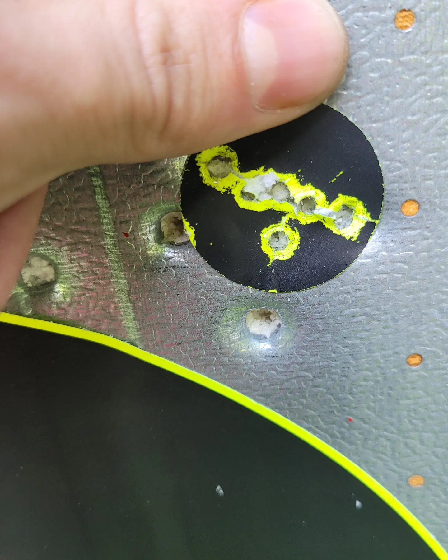

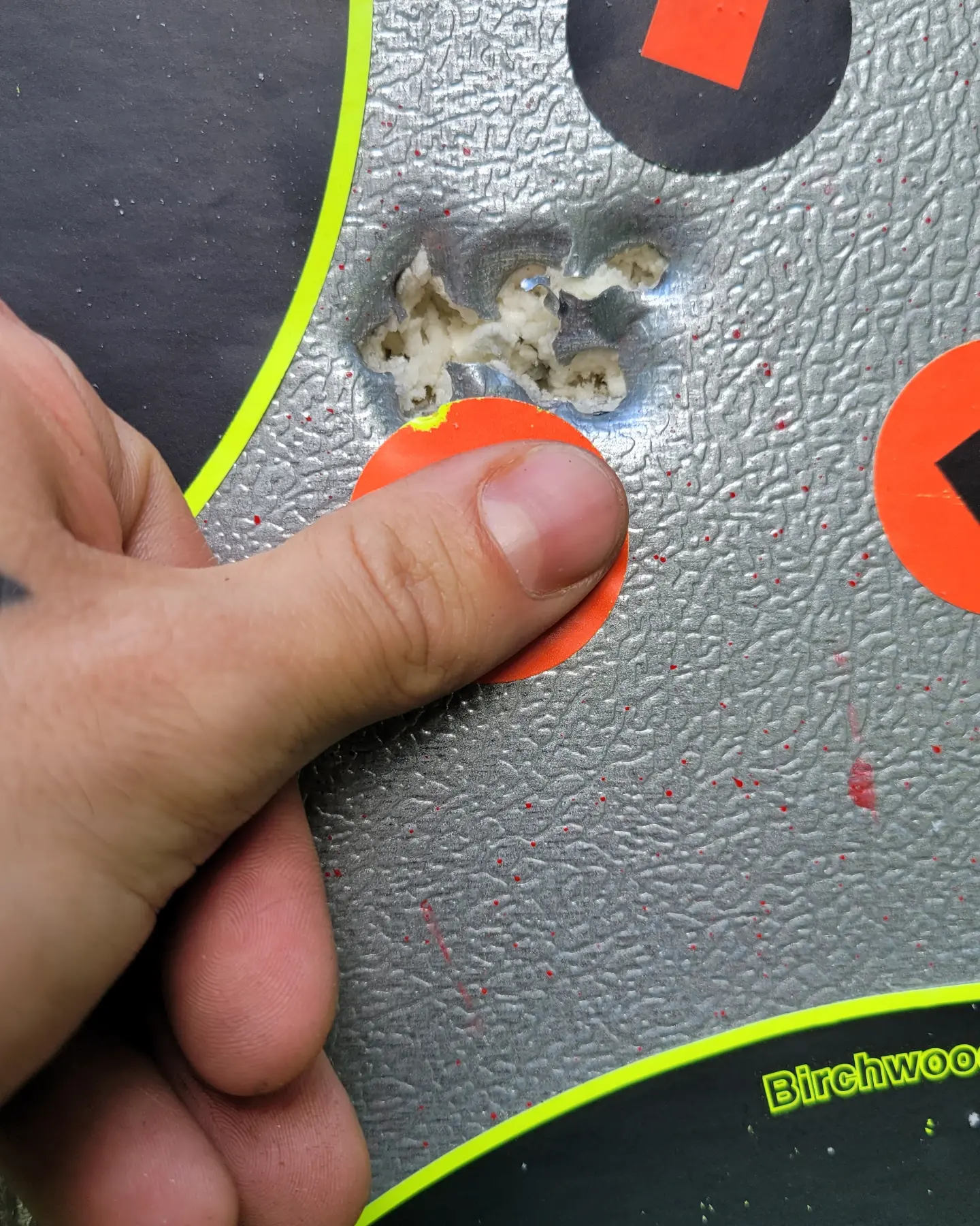

Today I tested jsb knockouts outs (.2165 25.39 gr) 50 yards
My settings on the alpha wolf were as follows
DWELL : 2730 MICROSECONDS
VOLTAGE : 87
REG PRESSURE : 165
It slung these down range at 1002 fps
I had previously tested 35 gr nielsen and the shots were 6 inches apart no matter what.
I kno I've got practicing to do but I also know I've got more tuning to do. I am not displeaed with this only having been shooting it two days now. I am wondering if the jsb knock outs in .217 same weight would tighten these groups up?. Maybe I should try a zan projectile soon
This was also my first day tuning in advance mode starting from scratch, sad to say it did take about 150 rounds to get this tune down
First group 8 shots I had left in a mag after adjusting the tune , second is a full mag
View attachment IMG_20220606_182743_042.1654593302.jpgView attachment IMG_20220606_182742_905.1654593303.jpg
