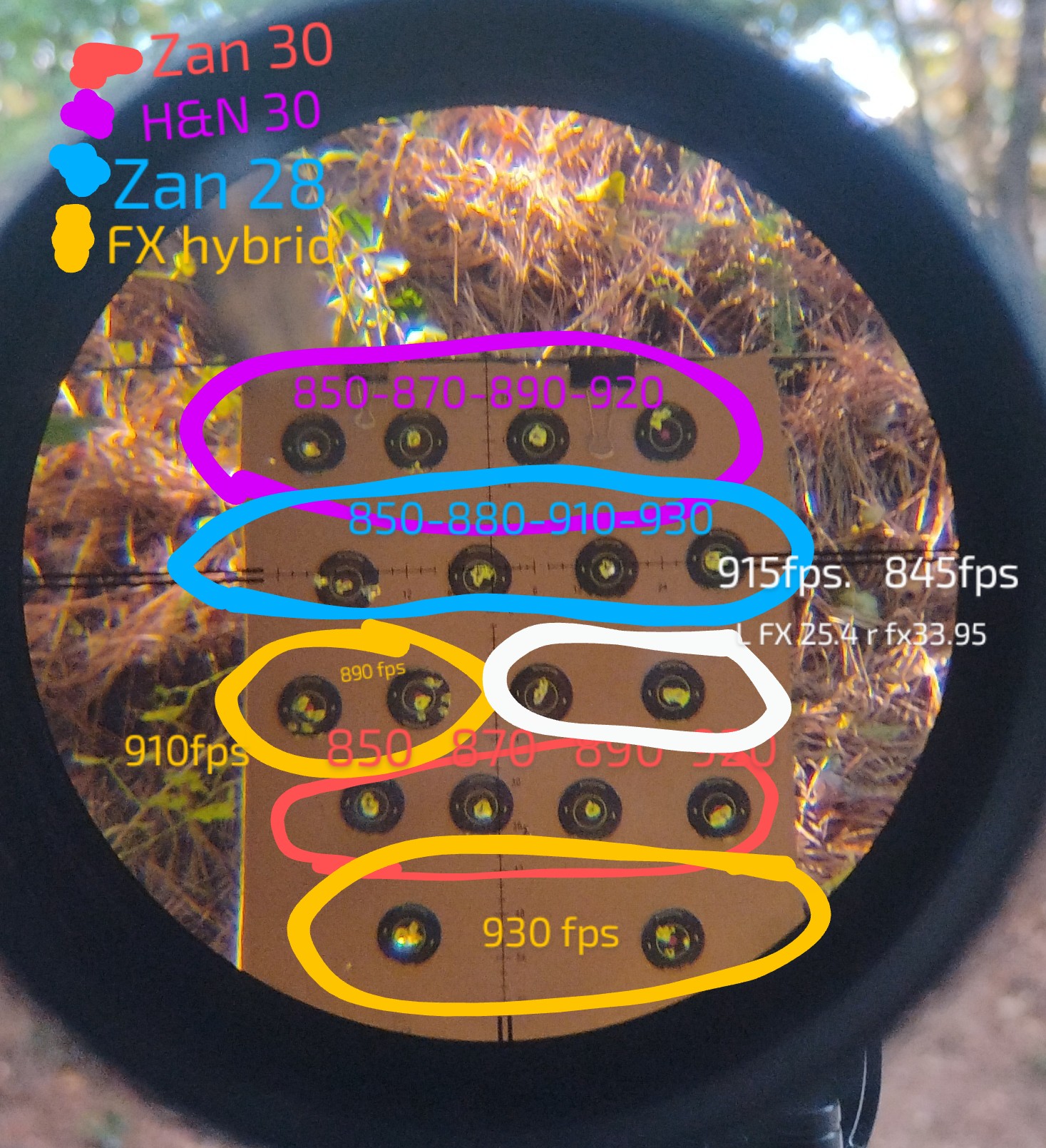

At what velocities are your slugs the most accurate?
Go...
H&N HP II 30gr - 950fps to 990fps
Accurate out to 230+ yards on invasive eurasian collared doves, European starlings and English sparrows. Deadly accurate. Love these slugs. I Just very recently purchased quite a few tins of the H&N Precision Slug .22 in 33grain. Hopefully these bad boys can surpass the HP II's with its superior BC. So far, they look very promising.
Huh weird. I find they do best at 865-891. By far. That is my slug of choice.
