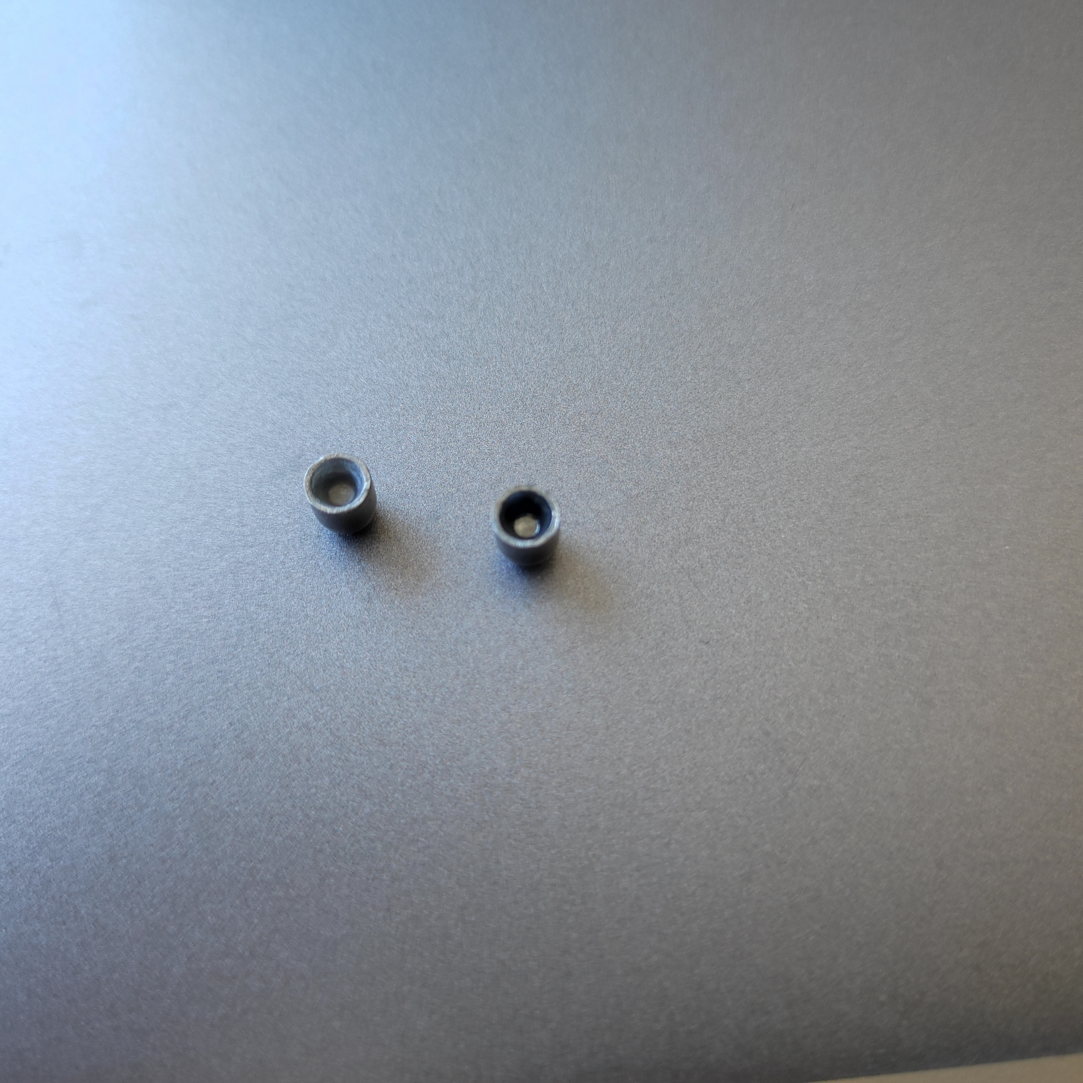

The slugs have a deep hollow base like a skirt. I hope you can see that in the picture.

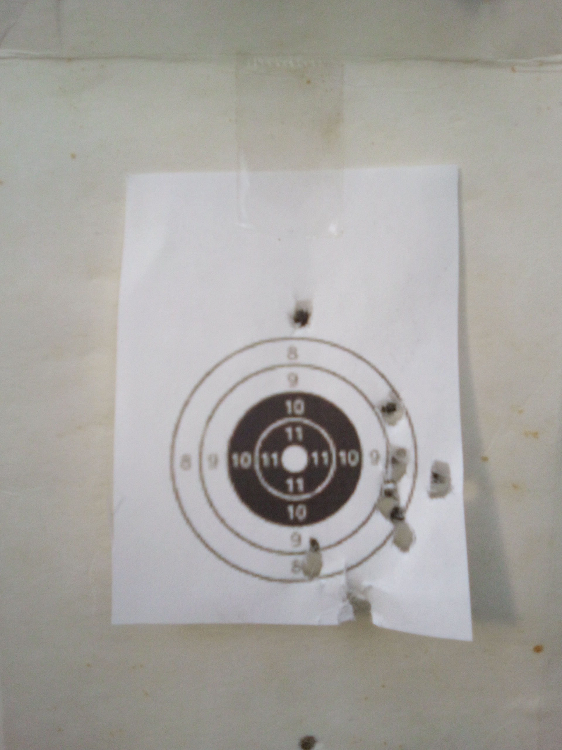

Here's a little demo🤩
The slug did MASSIVE damage and kept trucking.
The pellet hit,expanded a little and stopped.😃
You can’t compare terminal performance of a slug vs a pellet if you are shooting a SOLID metal plate. They will both give the same result, i.e. they will both turn into a M&M. Nothing to compare and nothing learnt.
