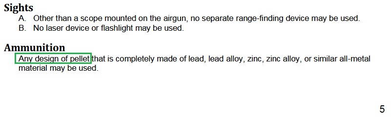

Big discussion on the forums regarding projectiles for AAFTA events. From the AAFTA rulebook, it appears that ANY DESIGN of pellet is what the rules state.
*Ammunition*
*Any design of pellet that is completely made of lead, lead alloy, zinc, zinc alloy, or similar all-metal material may be used.*

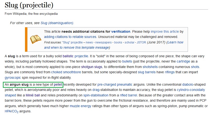

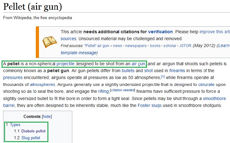

I don't see how a match director can honestly argue that "slugs" (slug shaped pellets) are illegal for AAFTA FT. They may not like them personally or want them in matches for whatever reason, but it's not because they are illegal. Target damage is a non-issue for 20fpe lead projectiles (the hardness of the lead is a bigger concern than the shape of the pellet). Some might just feel threatened by new or different approaches. I personally don't think that the current crop of slug shaped pellets is competitive with diabolo shaped pellets at under 20fpe and 55 yards.
So according to the AAFTA rules and a reasonable understanding of the English language, the answer should be yes, slug shaped pellets are legal for AAFTA matches.
