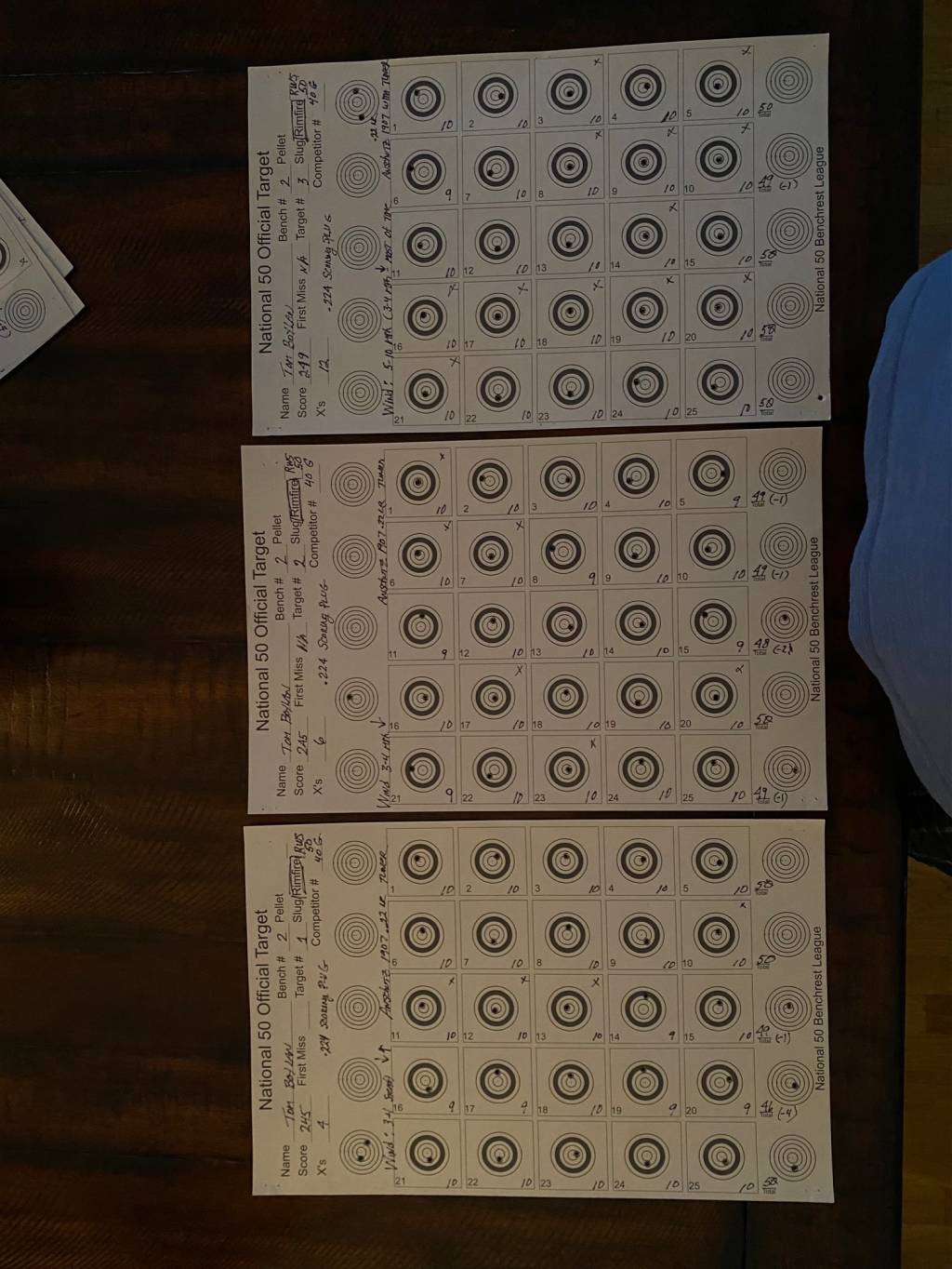

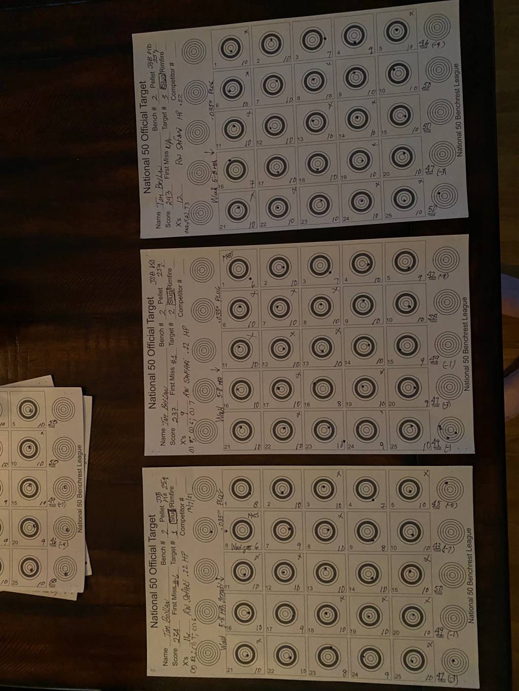

I shoot the JSB 25g Knock Outs at around 940 FPS on Medium Power on my .22 Safari HP. It does real well at 50 yards with this slug. I have shot some decent low to high 240 N50 targets with the Safari, low to mid 240's with my RAW HM1000x .22 HP. But, as you might guess the Anschutz always takes home the prize at 50 yards with RWS 50 40G ( and does have a tuner ).
Here are some targets from today with the Anschutz and earlier in September with the Red Wolf.
Too lazy to deploy flags today, but I know I should!
P.S. Wouldn't it be nice to do this at 100 yards? btw - I am going to start sorting/sizing my RDM's Mike! What a PIA, but I will eventually get there. I saw your post.

Thanks for the input. I have been shooting a V22 in NRL22 matches but am trying to nail down an air rifle rig that will come close to the rimfire base class guns. If the build can exceed the performance of the base class rifles, that would be a big plus. Once you transition into the Anschutz, RimX and Vudoo types in rimfire, those can be hole in hole shooters at 50 yds. Even the Tikka T1X and Bergara types perform very well in the rimfire class. Nice cards, thanks for the reference.
