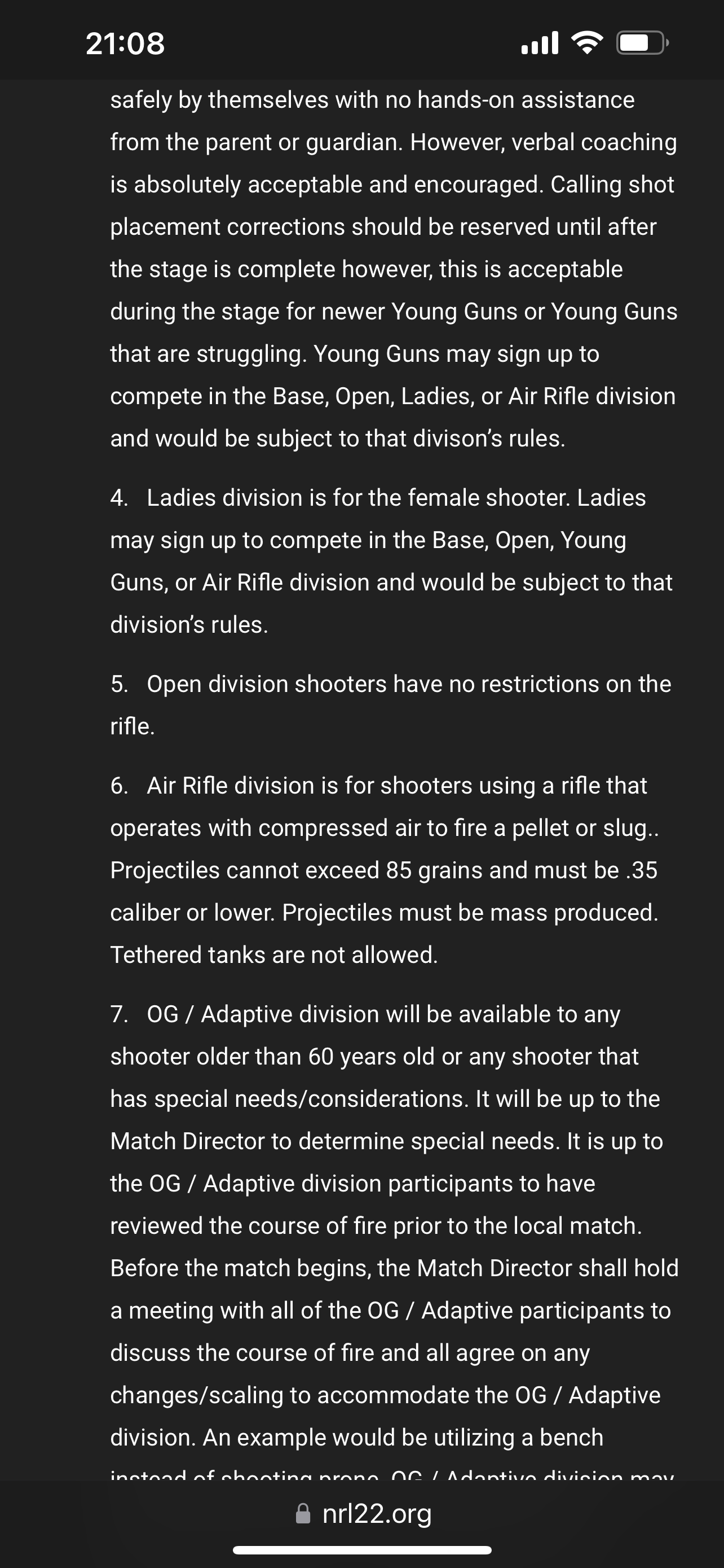

Incorrect. Read section:
B. Divisions
6. Air Rifle division is for shooters using a rifle that operates with compressed air to fire a pellet or slug.. Projectiles cannot exceed 85 grains and must be .35 caliber or lower. Projectiles must be mass produced. Tethered tanks are not allowed.
https://nrl22.org/about/rules-2023/
B. Divisions
“…Projectiles must be mass produced….”
Do they really mean “commercially available”? Meaning anyone can buy them.
Because I don’t necessarily know how any particular company is making their products. Any production process that uses a mold or die or cnc to make identical copies is a form of mass production. But do they mean something else?

You can shoot slugs in Nrl22 matches
Mass produced… this rule is meant to keep innovation and enterprise alive. They don’t want to exclude a slug or pellet manufacturer from innovating new products. So making a mass produced rule, no information on what is considered mass produced, I assume packaging? At any rate, that’s the reason for the verbiage.
