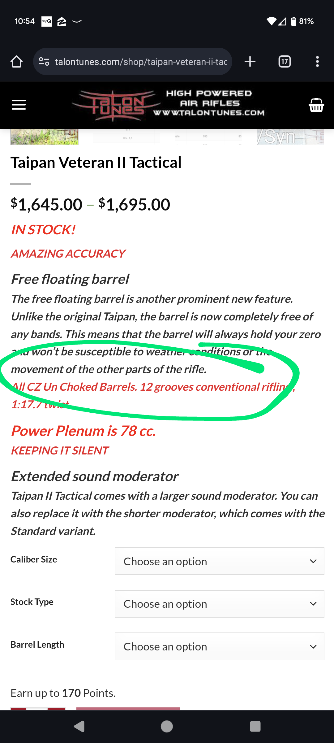

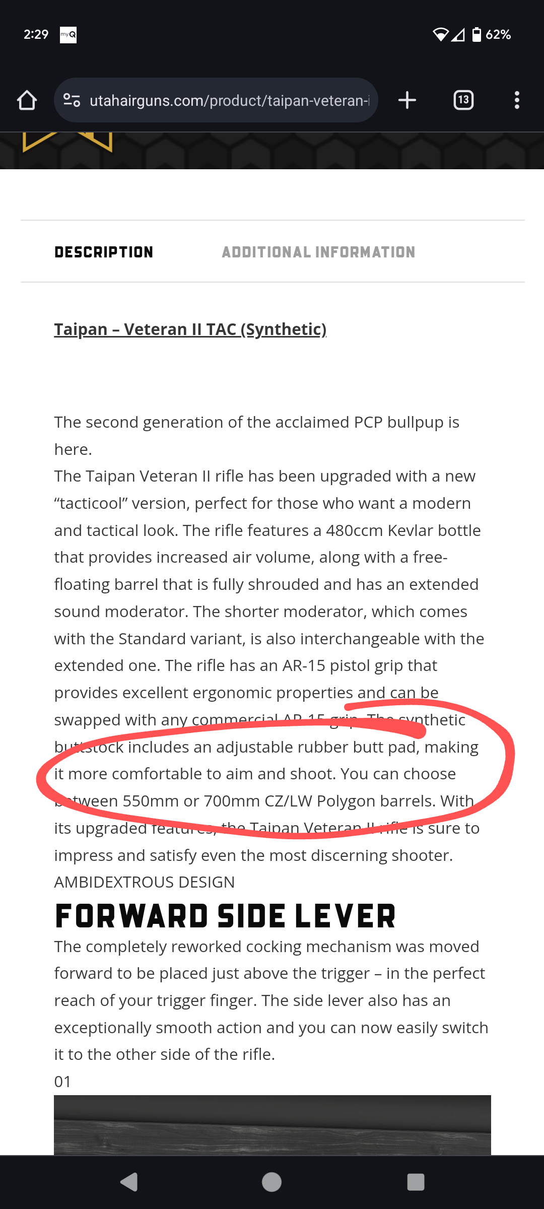

Taipan describes the Veteran II’s as having polygonal barrels (and, per Tony’s website, unchoked).

The 700mm barrel in the vet 2 is polygonal- either CZ or LW. the 550mm barrel is CZ standard 1:17.7 twist . Both are unchoked.
All original Veterans came with choked barrels with 12 land and groove rifling.
As for the Vet II....Typo? Or Vet II @ Utah Airguns has different rifling than one bought from Tony.
