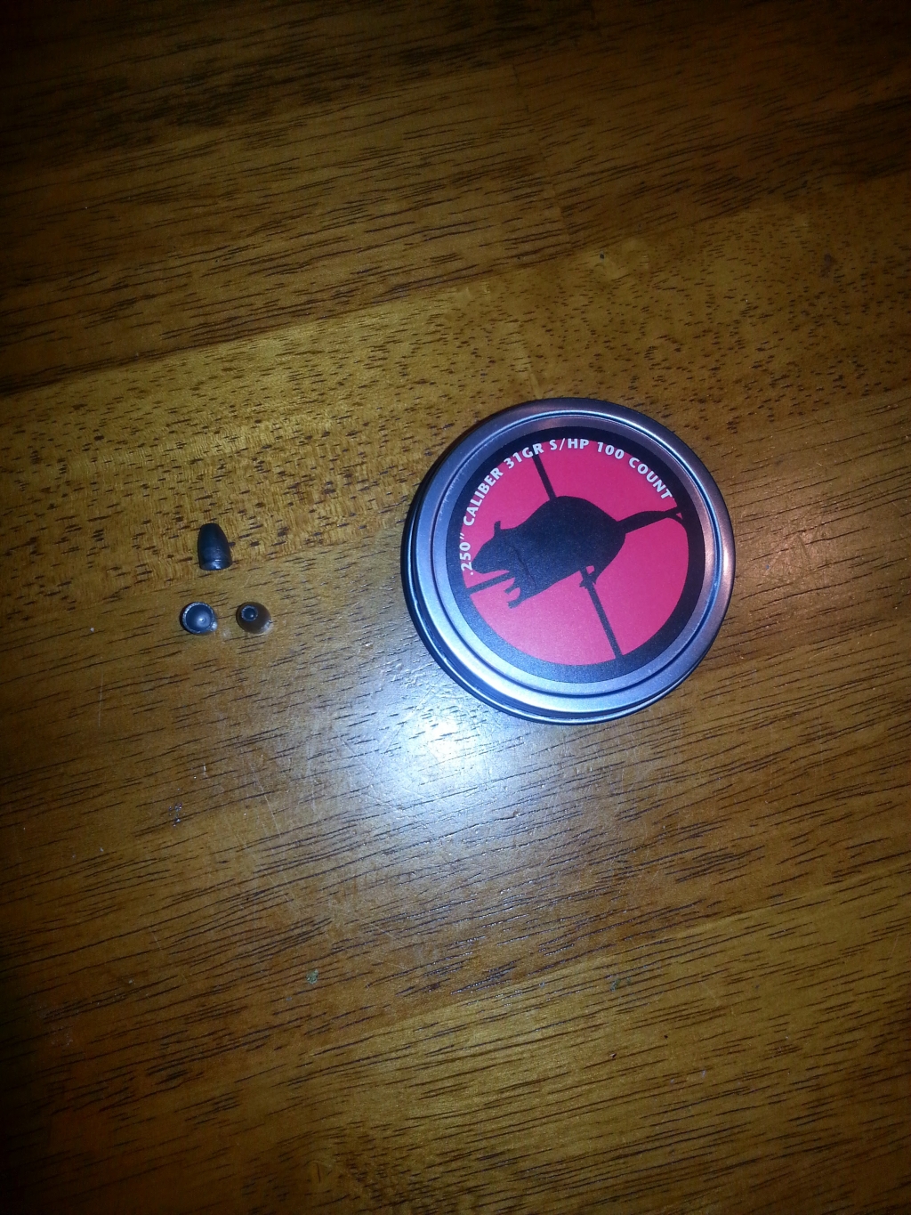

It depends on the gun. I started shooting carson rat snipers in my talon p soon as they hit the street. They shoot lights out. Built a Talondor .25 with 18" bbl and it love d-rig 33 gr varmint knockers. Your miles may vary.
