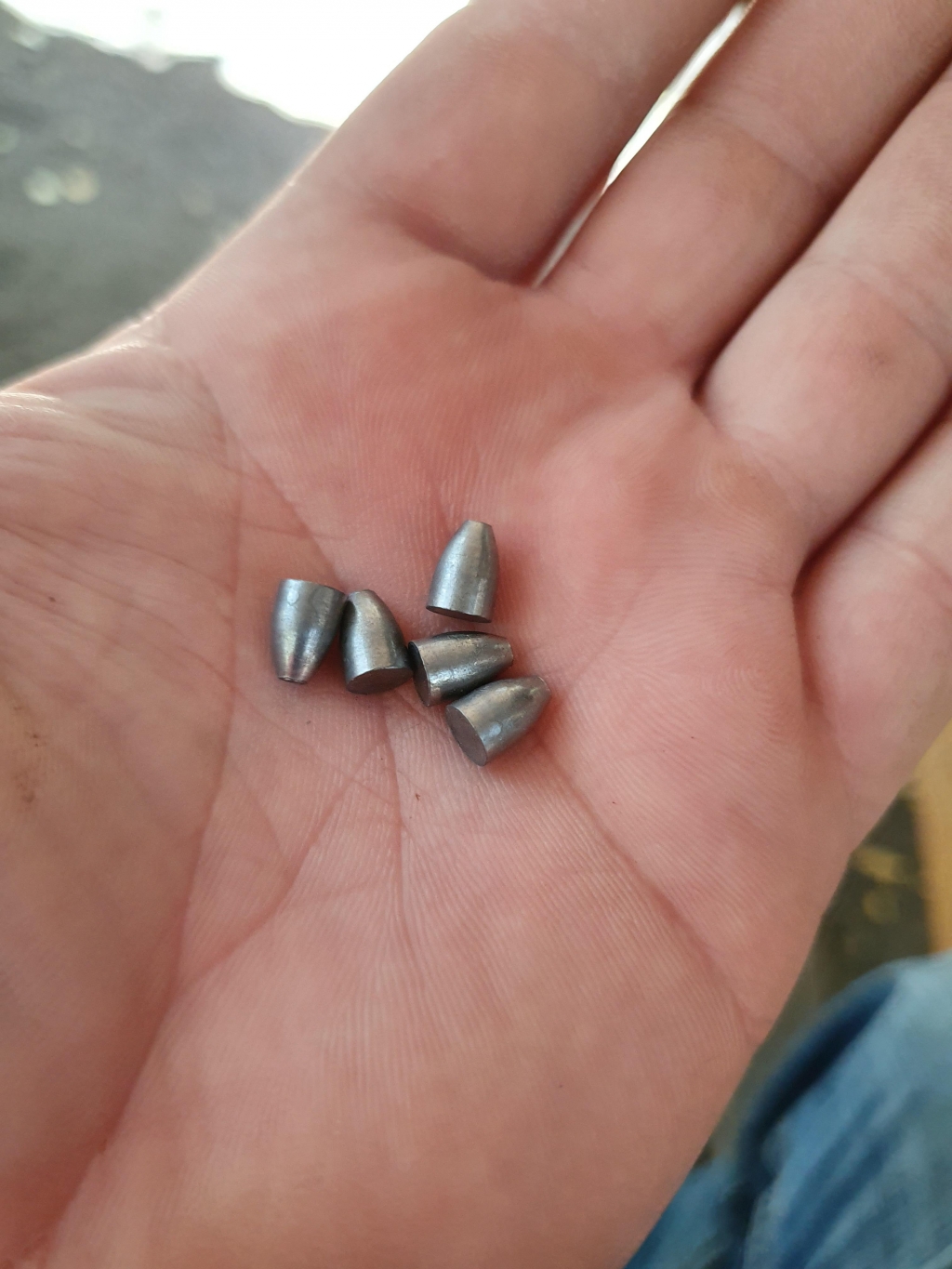

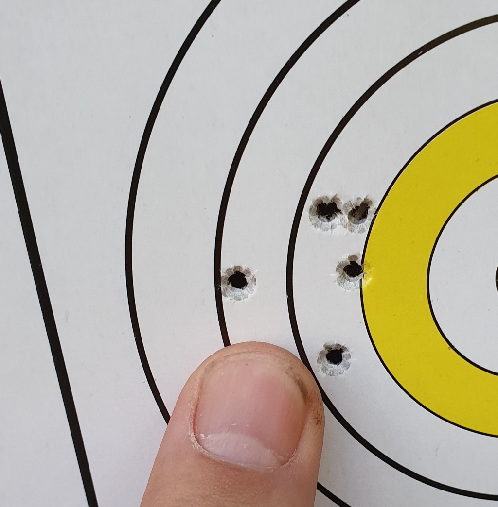

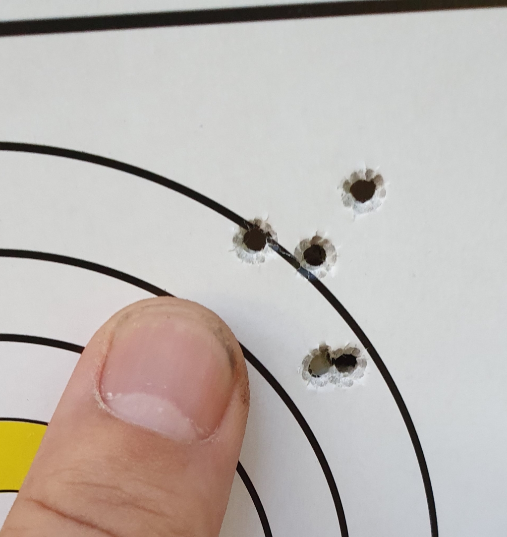

Ok, here is proof I just made (specially dedicated for those saying NO is not possible to shoot slugs out of the pellet liner)

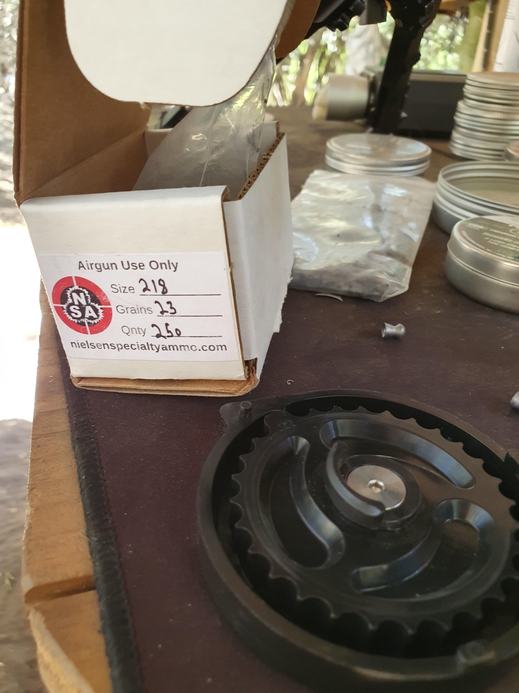

75m / 83 yards, pellet liner A 700mm, 850fps, stock impact x (tp elongated and c3 bumper delrin) shooting nsa 23gn .218 the wide of my thumb nail is 1/2 inch.

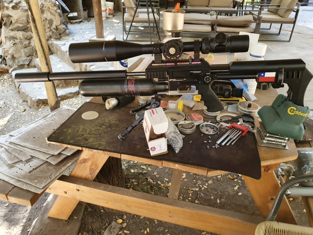

That is BlackMamba tuned for 18.2 jsb @ 1000 fps. Not even tuned for those slugs, just put those in the mag and shoot! It can be much better
Those are old NSA, new ones are better and coming this way. I will make more tests soon.
YOU CAN SHOOT SLUGS OUT OF THE PELLET LINER! (not all slugs, light ones usually)
