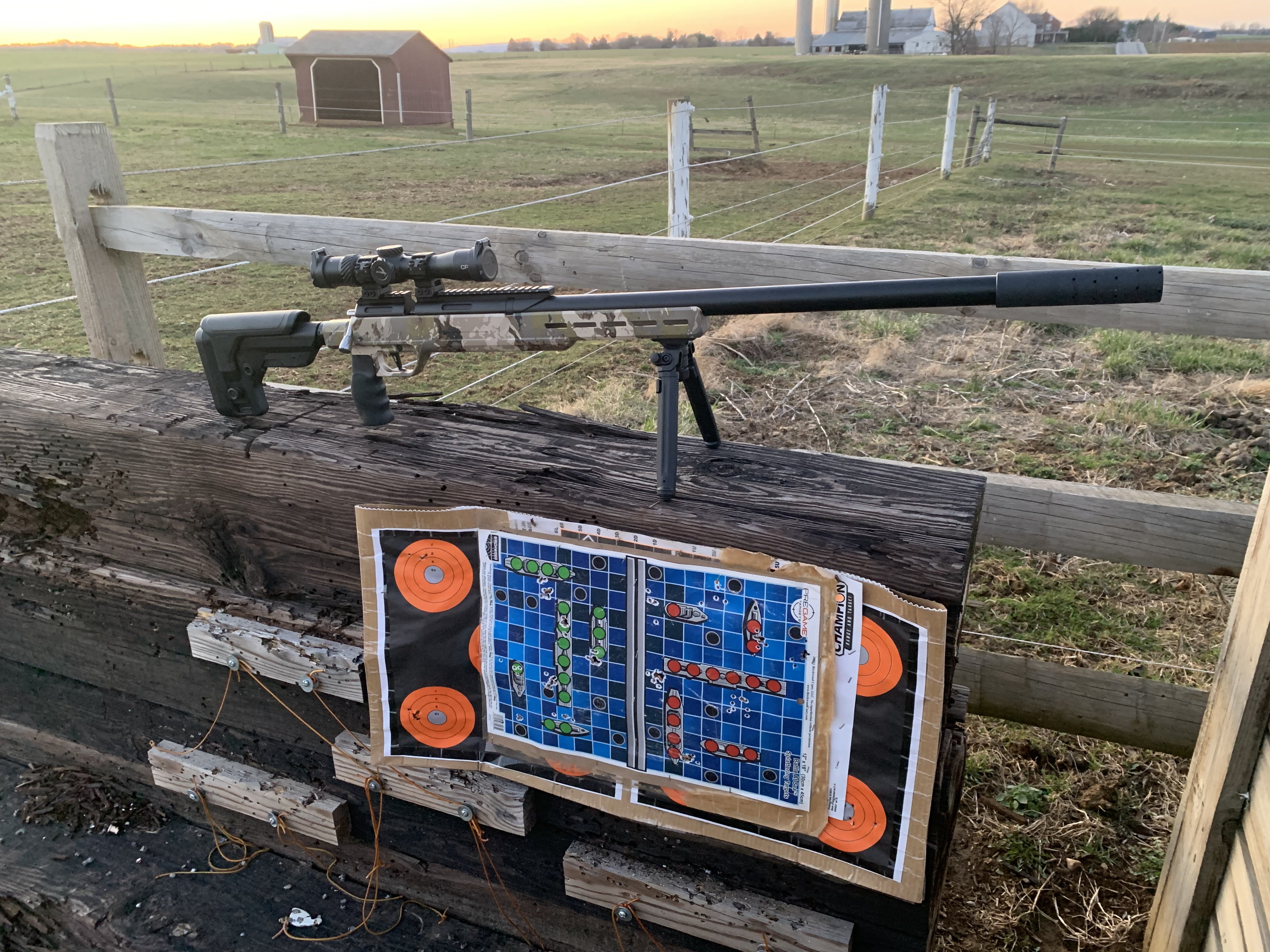

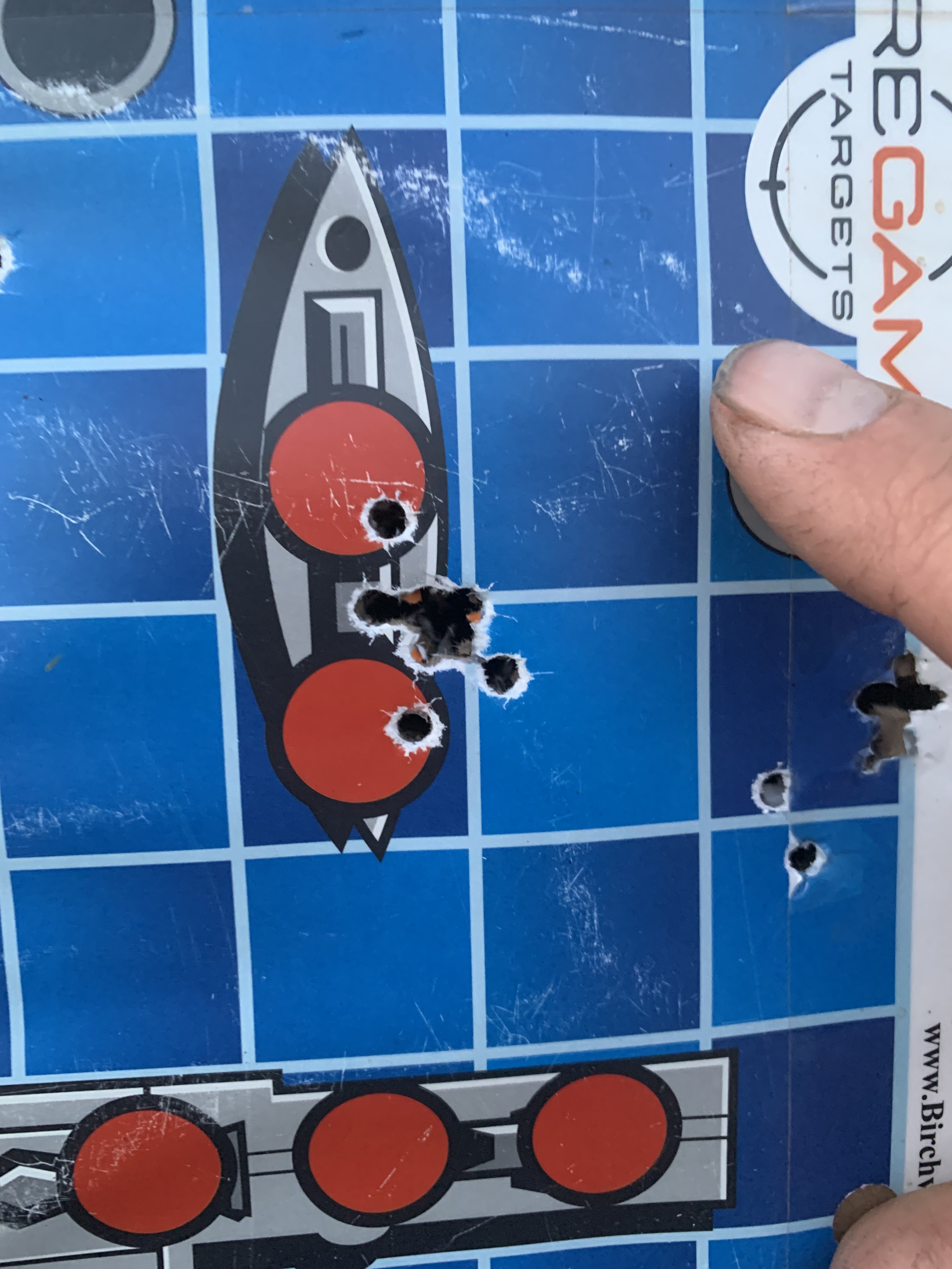

In one slug test video I saw it really liked the H&N .249 36gr but the guy had turned it up to 2500 on the regulator. Nothing else was changed.I tried some .251 JSB knockouts that didn’t do well at 50 yards. Then I also tried some H&N .249 36 grain I think. I attached some photos. I think those might show some potential. It was just stuff my brother had laying around. I didn’t do anything as far as changing the factory tune yet. I’ll have to play around with it a bit and see what happens. My plan is to use this gun as a fox hunting rifle this coming season so I got time. Do you think 1 moa is a logical goal at 100 yards?View attachment 548363View attachment 548362View attachment 548364

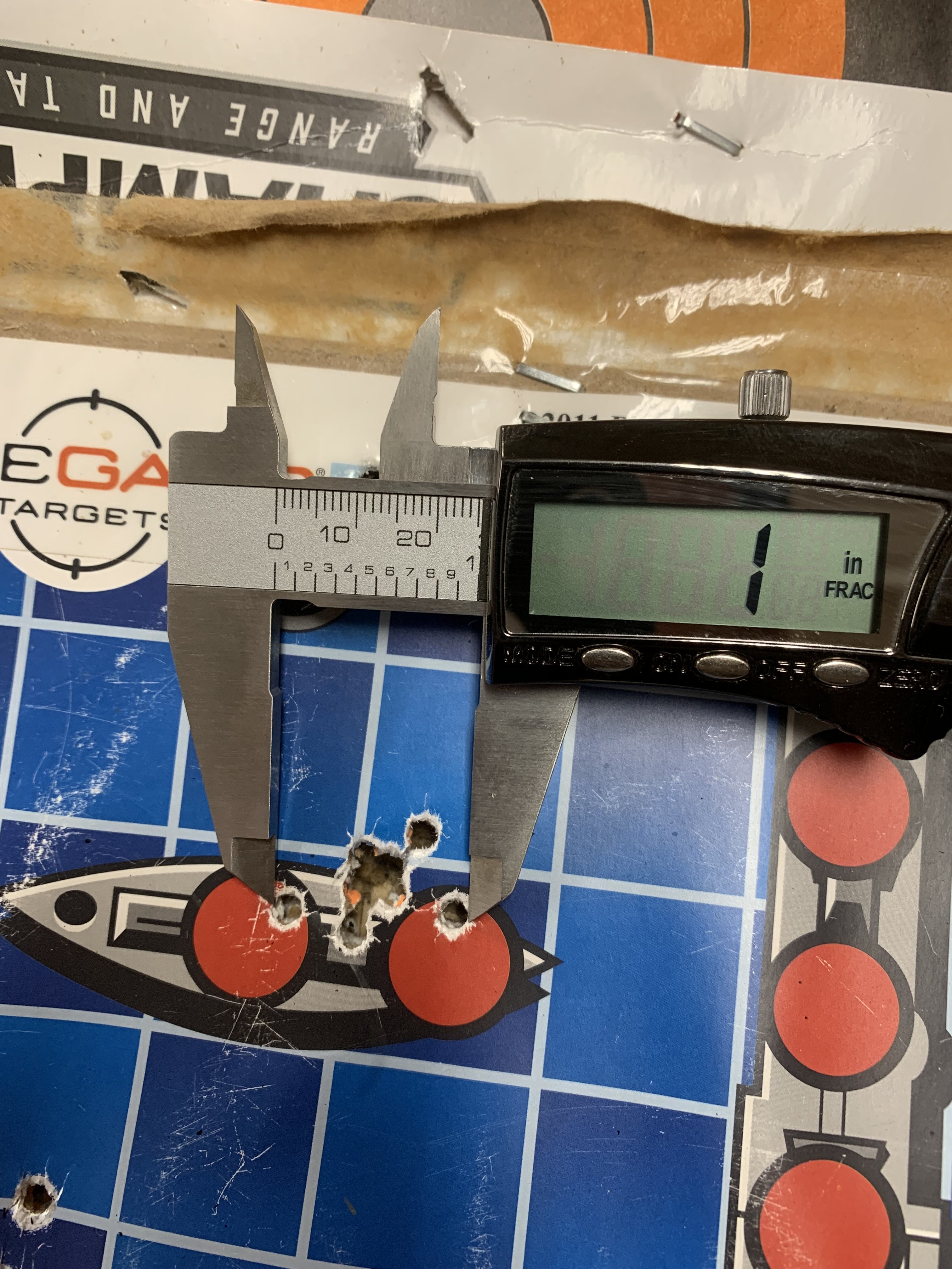

Yeah strange that the 40gr did 800 and the 34gr did 850. I’m brand new to the pcp world so I think it was mostly a bad tune causing it… I have since learned how to use just the hammer spring adjustments to improve accuracy. I shot a dime sized group from 25 yards with 32gr Patriot Javelin .251 cal. I ran out of light before I could extend out to 50 yards…6gr is only 50 fps difference? 34 at 850 is about 55fpe. That's not bad. HN .250 30-32 and Zan 28-32 were best in the short time I had mine. Actually extremely good. 30s at 905 d
