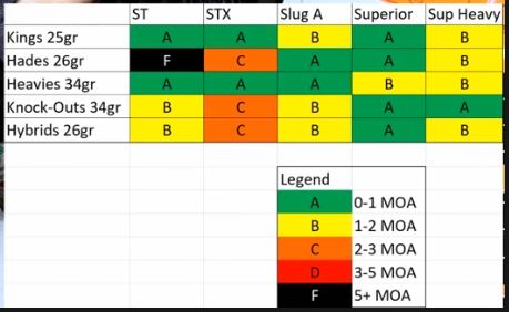

Somebody posted this a while back and I just made a screetshot for my own reference, I don't know anything about credentials or accuracy, because to prove the chart below need a lot of time, equipment, knowledge, and $$ as well.
I never had a chance to invest into liners and a variety of pellets/slugs, from day-one I am shooting a single size = JSB Heavy MK2's 34gr.
