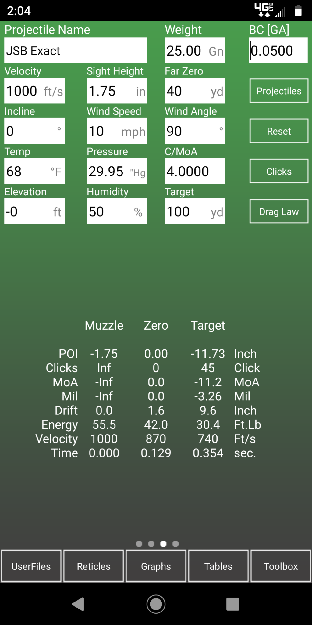

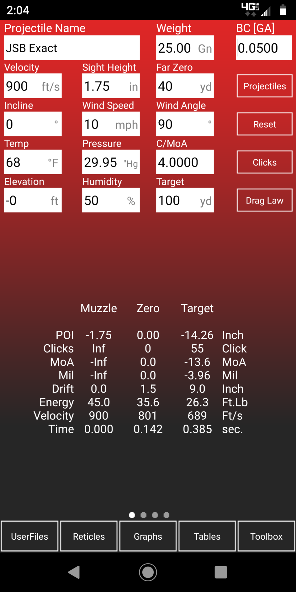

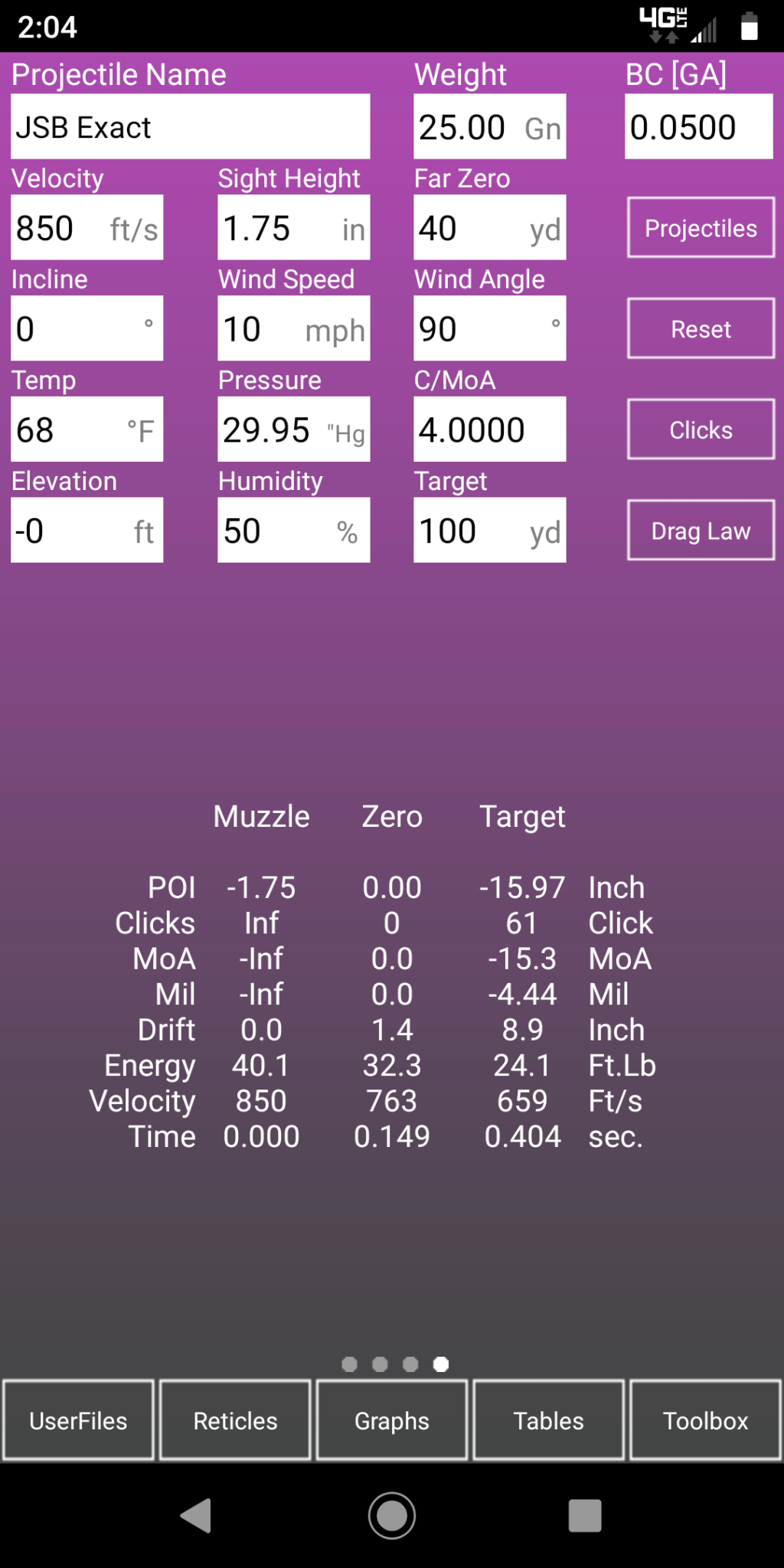

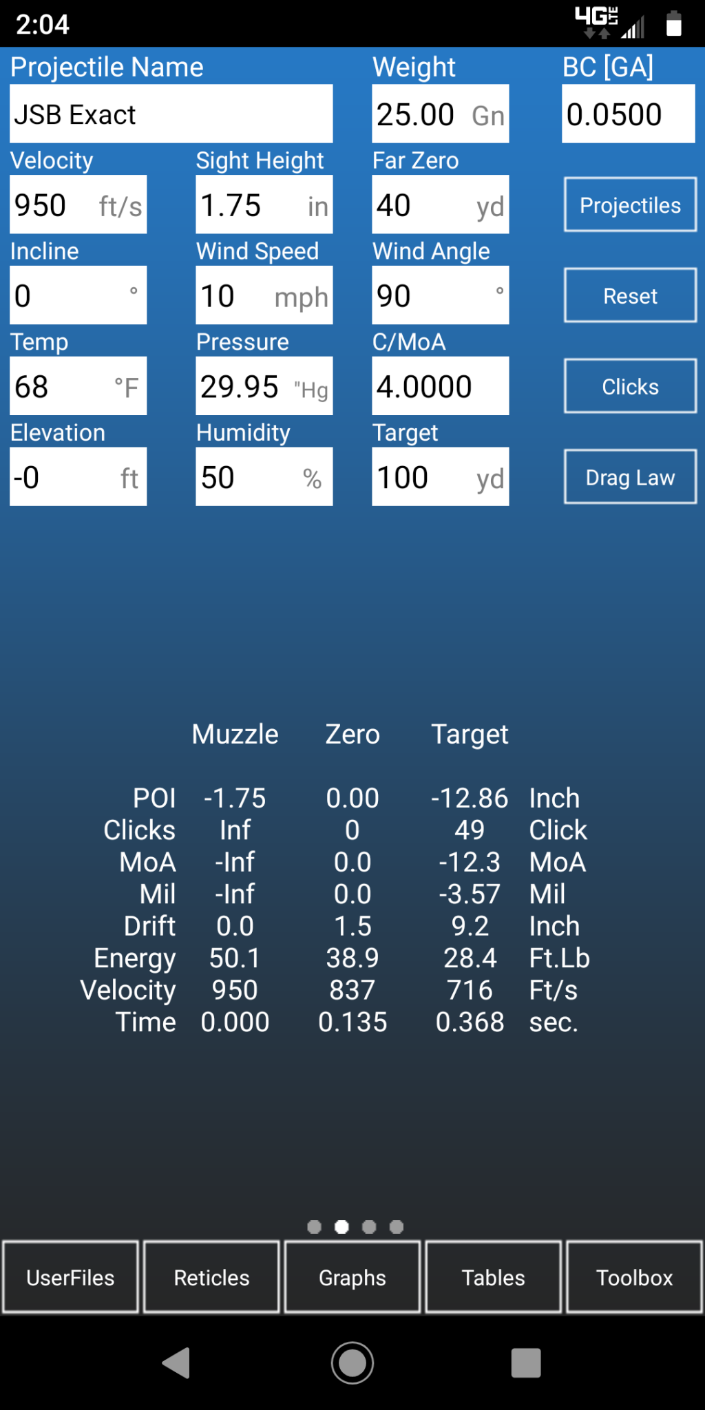

I'm with CC on this, slower speeds do not increase wind drift
34gr pellet, 10 mph cross wind 50yds
960fps 2.77
900fps. 2.64
850fps 2.59
I don’t have enough experience with slugs yet. But with pellets, Lower speeds means less wind drift.
960fps 2.77
900fps. 2.64
850fps 2.59

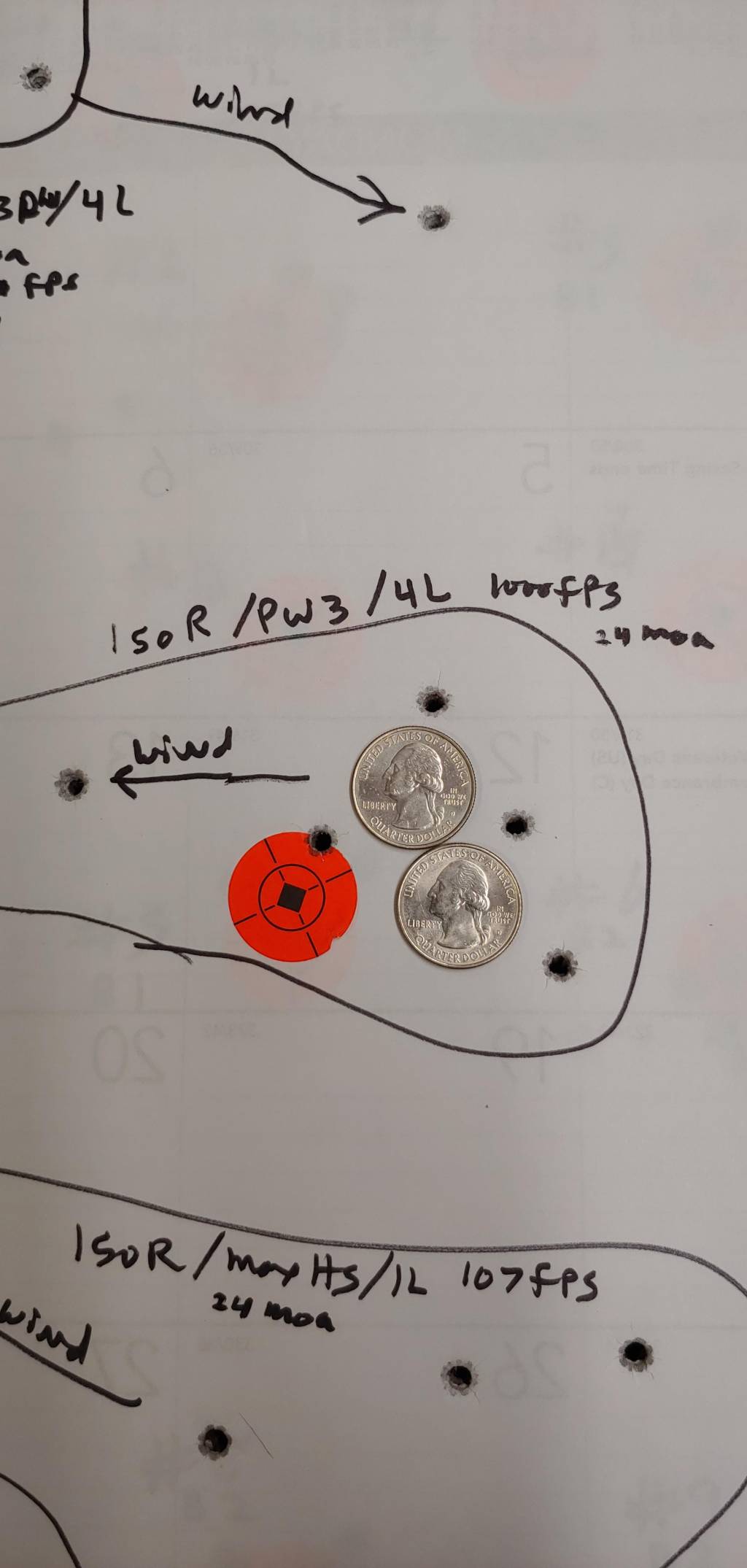

Of course it's not that noticeable at 50 yds where the speed is still significant and flight time minimal, but as the projectile moves farther out (50-200 yds) it slows down significantly in relation to the flight distance and the wind affect becomes amplified. Puffs of wind can move even a heavy slug inches. A .204 ruger with with a projectile speed close to 4000 FPS doesn't have this problem at 200 yds.
200 yds. 5 shot group. 44.5 gr slugs - 1000 FPS - some wind.
(Would have still got 4 out of 5 prairie dogs though)
960fps 2.77
900fps. 2.64
850fps 2.59
960fps 2.77
900fps. 2.64
850fps 2.59
Same 34gr pellet at 200y
950fps. 40.34
900fps. 40.28
