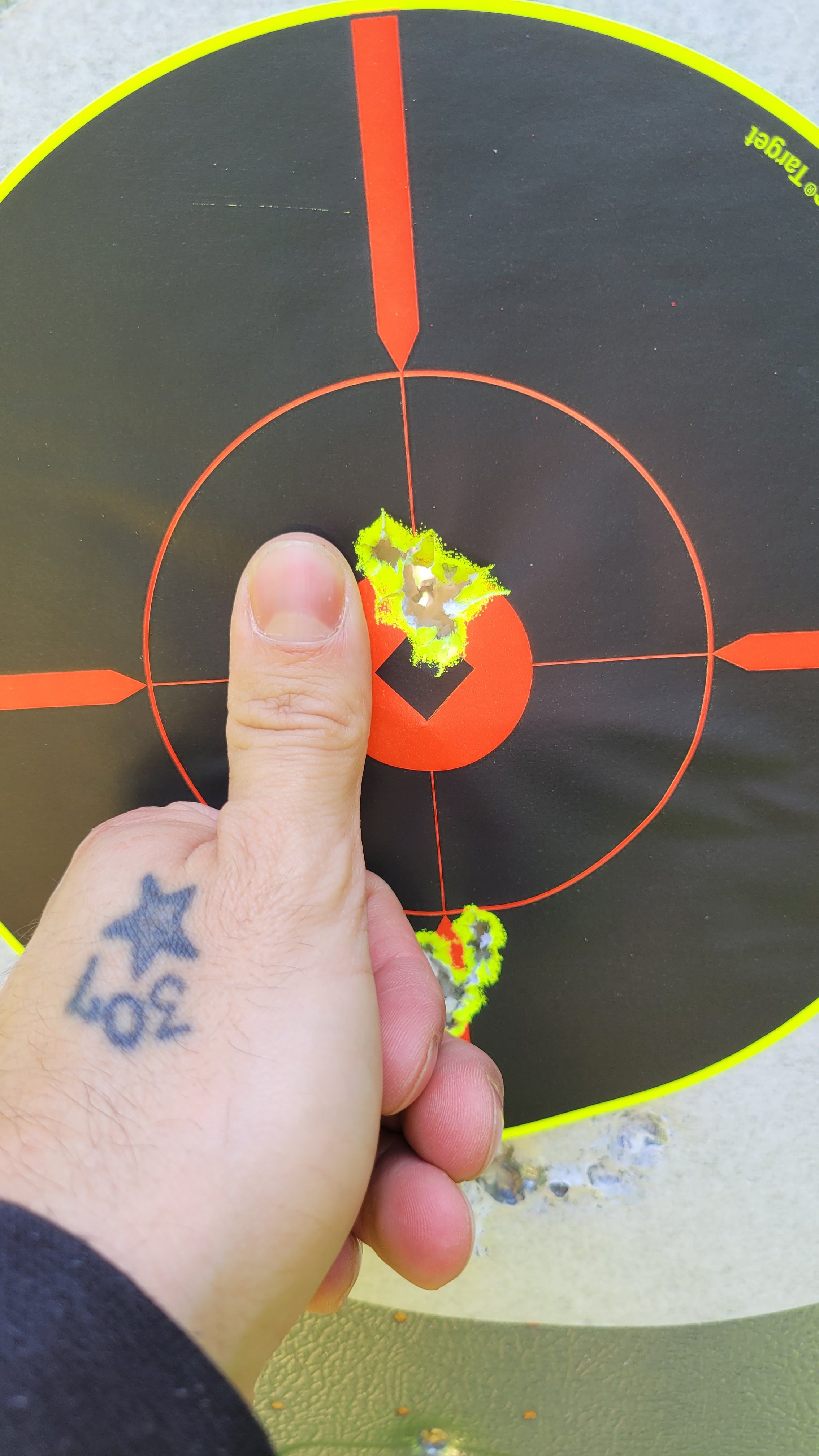

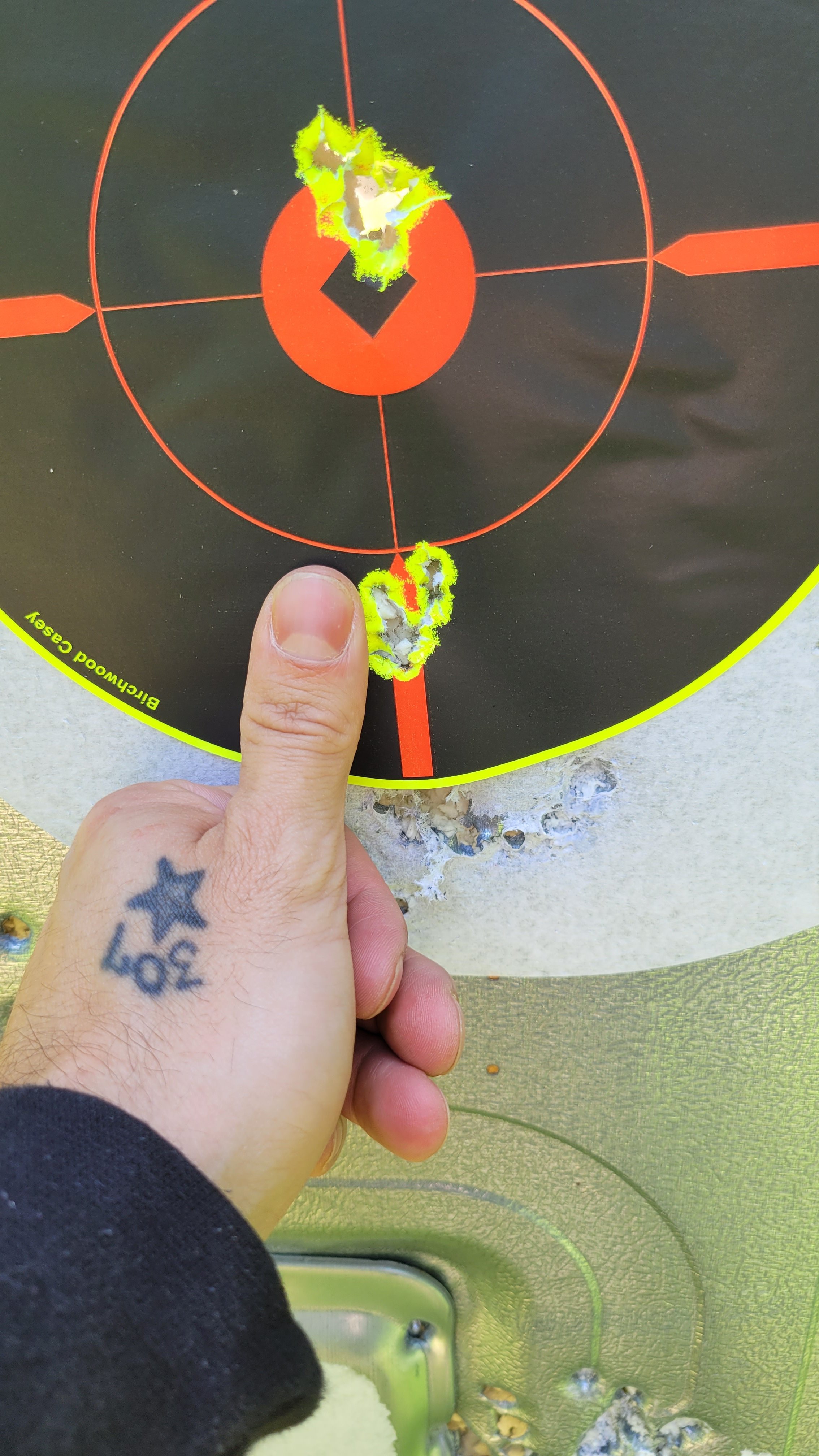

There are good groups, and there are lucky groups. My best always fall in the second category! But, an average of 5 or 6 groups tells the difference. If the 10 to 20 mph winds were at all variable, that's very fine shooting.
It was hard to tell if I'm being honest. I was in the middle of tuning of my alpha wolf , first group in this post is the beginning of the tune, second group is the middle, the group above was the last n I called it there
